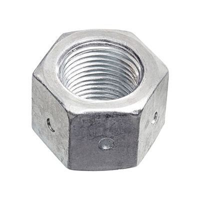

:link: http://corvaircenter.com/phorum/read.php?1,1059203
Control Rod Nut
Posted by: persh
Date: January 07, 2020 03:28PM
What size is the this nut on the front suspension control rod? I was missing one of these nuts so I took my control to hardware store and wasn't able to find anything that fit. What's the deal??
Posted by: Lane66m ()
Date: January 07, 2020 03:44PM
11/16-18. I have 4 back ordered with Clark's. Should be shipped in next couple weeks.
I took apart 4 front suspension assemblies and very few of these nuts were salvaged.
Posted by: junkman ()
Date: January 07, 2020 08:13PM
I have found that many times, that the threads on the rod are in poor condition, and that it is difficult to thread the nut onto the rod very far. A new die to repair the threads was about $50, but I lucked out and a friend loaned me his. Without the die, I would have had to just buy a new rod. Usually they rust severely under the bushing which can render the rod useless.
Posted by: persh ()
Date: January 07, 2020 05:19PM
Wow, that seems like a pretty crazy size!! I'm not sure I'm looking at the right thing in the Clark's catalog. Is the correct part I want C633??
Re: Control Rod Nut
Posted by: solo2r ()
Date: January 07, 2020 08:48PM
I bought the Die years ago and have saved many rods! If Frozen, I just cut off old nuts and replace with new after running the die down the threads.
:link: https://ssl.corvair.com//user-cgi/catal ... d_page=155
Part number C633: 62-69 CONTROL ROD NUT-ORIGINAL STYLE *DO NOT USE AIR RACHET-MUST INSTALL MANUALLY
Weight: 0 lbs 4 oz
Catalog Page(s): 155(20)
Price:
1 - 3 $ 6.40
4+ $ 5.90
Nut, Strut Rod, 1962-69 Corvair, Front
Fits 62-69 Corvair
Part# CV10594
Arriving Soon Please Call 1-800-243-8355
:link: https://www.opgi.com/chassis-suspension ... dJEALw_wcB
Image $9.99
(Each)
These appear to be the correct size — SUITABLE SUBSTITUTE??? Each nut is thinner and has fewer threads.

Given that, I'm even more surprised somebody hasn't reproduced these. Those skinny little jam nuts are nothing compared to the original nuts, which are actually different, the outside nut is longer (and has a radiused outer edge) compared to the inner nut, per photo.
