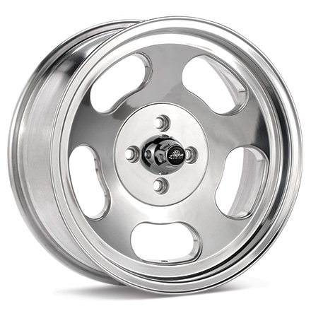

Image :link: https://www.tirerack.com/wheels/WheelCl ... lsrc=aw.ds
VN69 ANSEN SPRINT
Polished
$156.91
Availability: Special Order
Set of 4: $627.64
Free Shipping
The most popular Ansen wheel was the Ansen Sprint, which was introduced in 1963. The Sprint was the first "aluminum slot" wheel, being centrifugally cast, a technique seldom used in the wheel industry back then. They were produced on a tracer lathe and shipped in their natural, machined finish
Offset:0mm
Backspacing:3.94"
Bolt Pattern:5-475 ??????? Picture shows a 4-lug bolt pattern
Earlies use 4 lugs on a 4½" circle (4 x 4½")
Rec. Tire Size:215/65-15
Weight:16.0 lbs.
Finish:Polished
Construction:1pc. Low Pressure Cast
:link: https://www.speedwaymotors.com/American ... GYQAvD_BwE
$140.00 each :tu:
Get FREE shipping when your order includes this item and exceeds $99! Ground shipping only in the contiguous US :tu:
American Racing VNA695748 Ansen Sprint Series Wheel 15 x 7, 4x4.5
15 Inch m, 7" Width, 4x4.5 in. WhWheel Diameter, Cast Aluminueel Bolt Pattern (in.), Polished
Wheel Diameter: 15 Inch :tu:
Material Type: Cast Aluminum
Width: 7" :tu:
Wheel Bolt Pattern (in.): 4x4.5 in. :tu:
Wheel Bolt Pattern (mm): 4x114.3 mm
Wheel Backspace Range: 4.000" - 4.499" ??? :tu: (Available in 4.499" Backspacing? Perfect! Call and ask!
Wheel Backspace: 4"
Wheel Offset: 0 mm
Finish: Polished
Color: Natural
Beadlock Included: No
Offset: 0 mm
Weight: 16 lbs.
MFG. Part #: VNA695748
Load Capacity: 1580 lbs.
Notes: Polished
GTIN Code: 761138695215
Bolt Pattern: 4 on 4.5
Image :link: https://www.jegs.com/i/American-Racing/ ... 4/10002/-1
Ignore the 5 lug picture — specs show a 4 lug bolt pattern.
