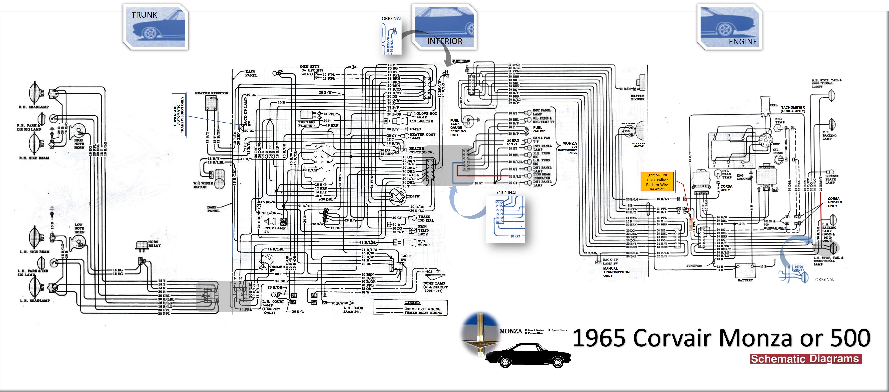

Can anyone tell me what tbe ballast resistor wire looks like? I see the connectors just inside the engine compartment and will have to cut tbe black covering to get at it.
Sent from my SM-G965U using Corvair Forum mobile app
1965 Corvair Monza Coupe 110, 4 speed, Liberty Blue
Posts: 9709
Re: Ballast Resistor Wire
It is a wire that extends from the 12-pin multi-connector to the two-pin starter solenoid connector. The wire between these two points is the special resistor wire. In the schematic diagram below I represented the resistor with a gold coil of wire and a gold label pointing to it. At the starter solenoid 2-pin connector it is spliced to another wire that continues on to the ignition coil Positive (+) terminal, but that segment of wire is just normal 20 gauge wire labeled 20 B/Y (20 gauge Black/Yellow Stripe)
The wire on the other side (firewall side) of the 12-pin multi-connector is labeled 20B/P (20 Gauge Black with Pink Stripe). On that side of the plastic connector, the wire is also normal standard 20 Gauge wire that leads to the dashboard, where it is connected to the ignition switch to provide power when the key is in the ON position. Only the short wire segment between the large multi-connector and the small starter solenoid connector is special resistor wire, labeled 20 W/R/B (20 Gauge White/Red/Black)
Left-click the image to enlarge for better viewing. Click a second time for maximum enlargement...
1965 Corvair Monza Full Schematic

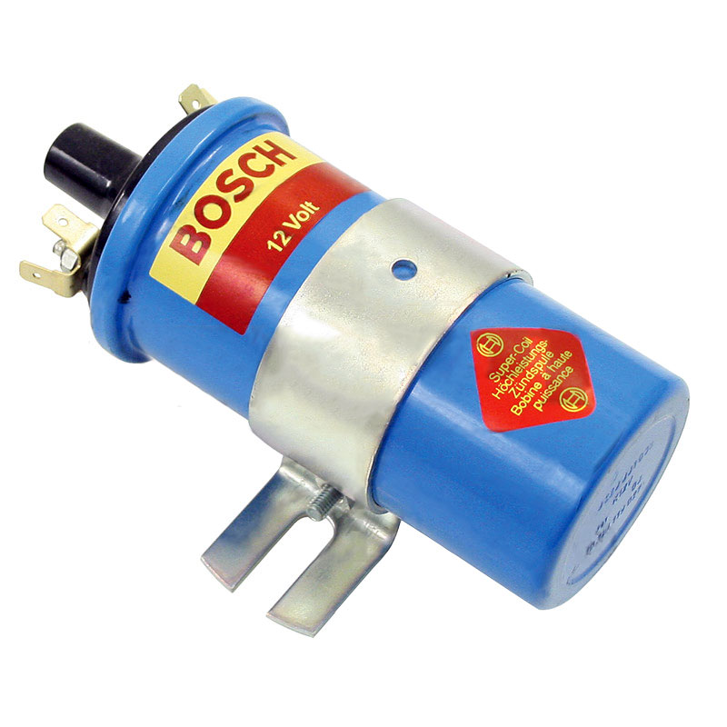

Gregory_Miller wrote:
Thu Sep 24, 2020 1:38 pm
I did have a bad stock impedance Bosch branded coil that sucked causing me issues before it was discovered.
Not my Bosch big blue coil! I've hade mine forever and plan to keep using it forever!

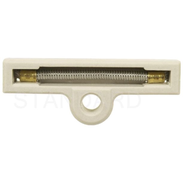

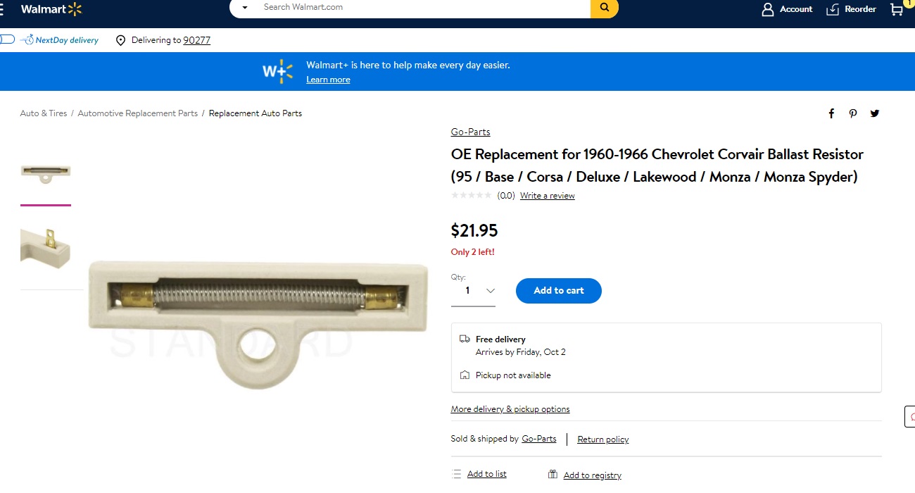

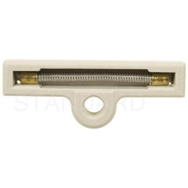

Oh, so THAT'S what an OEM Corvair ballast resistor looks like. How'd I miss THAT? Hurry, only 2 left!
https://www.walmart.com/ip/OE-Replaceme ... /438076497
(Noobs: Sorry for any confusion, this badly mistaken listing is just wrong. Corvairs uses a resistance wire integrated into the wiring harness)
