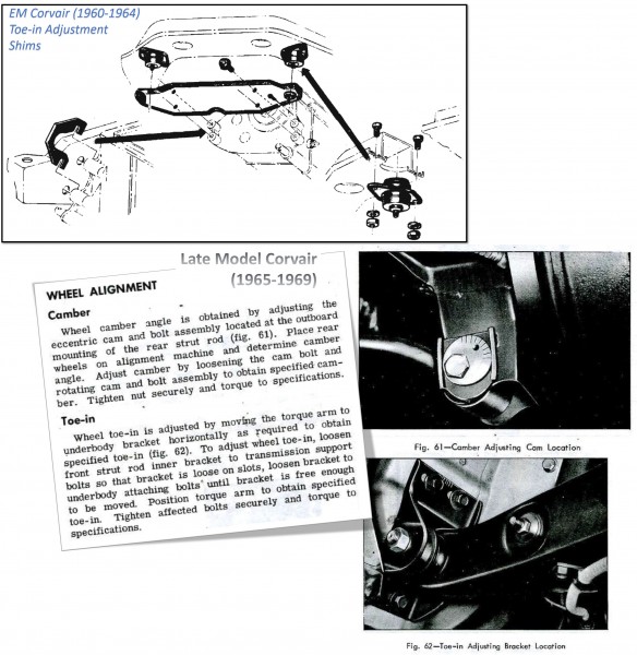

1961 Corvair Shop Manual wrote:Toe-In Adjustment...the wheels are adjusted by adding or removing shims at the front edge of the transmission (with rear engine support loose), both wheels are adjusted at the same time. With the design of this suspension, it will be impossible to adjust one wheel at a time as shims must be added or taken away equally from each side. See Figure 3-35... CAMBER — The camber on rear wheels should be 1½° ± ½°. There is no provision for adjustment of this item and it is provided as a checking specification only.

Re: 65-69 Suspension on 64?
Thanks man. Appreciate it.
