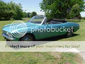

Blinker problem is probably the switch in the steering column and that is probably the same for the brake light as they all split off from that switch. The wipers may be just a bad ground or replace the switch. The tranny may need rebuilding. It depends on how bad you want the convertible. Check craigslist and ebay to see what similar Corvairs are going for.
I'd say the vert is probably worth 4-5 grand given the problems it has. Pictures would be helpful though as I am only guessing here.

pic of corvair
pic of thunderbird

Trans slip while cornering is usually low fluid. Look for leaks.
Wiper only work while holding wash button is a bad switch.

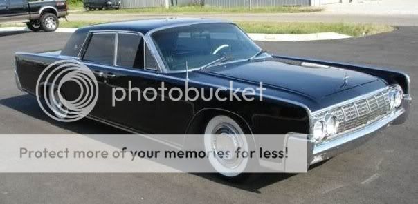

I would keep the bird, but my wife limits me to only 2 cars. The bird is my daily driver, and I wanted something a bit more economical and a little less of a constant electrical/vacuum headache. My other car is a 64 lincoln continental...and I plan on being buried in that one, so to speak.
AND, since I'm sharing, here is her daily driver:
yup...our "newest" car is 34 years old. Heck, that's practically brand new amirite, guys! Guys?
