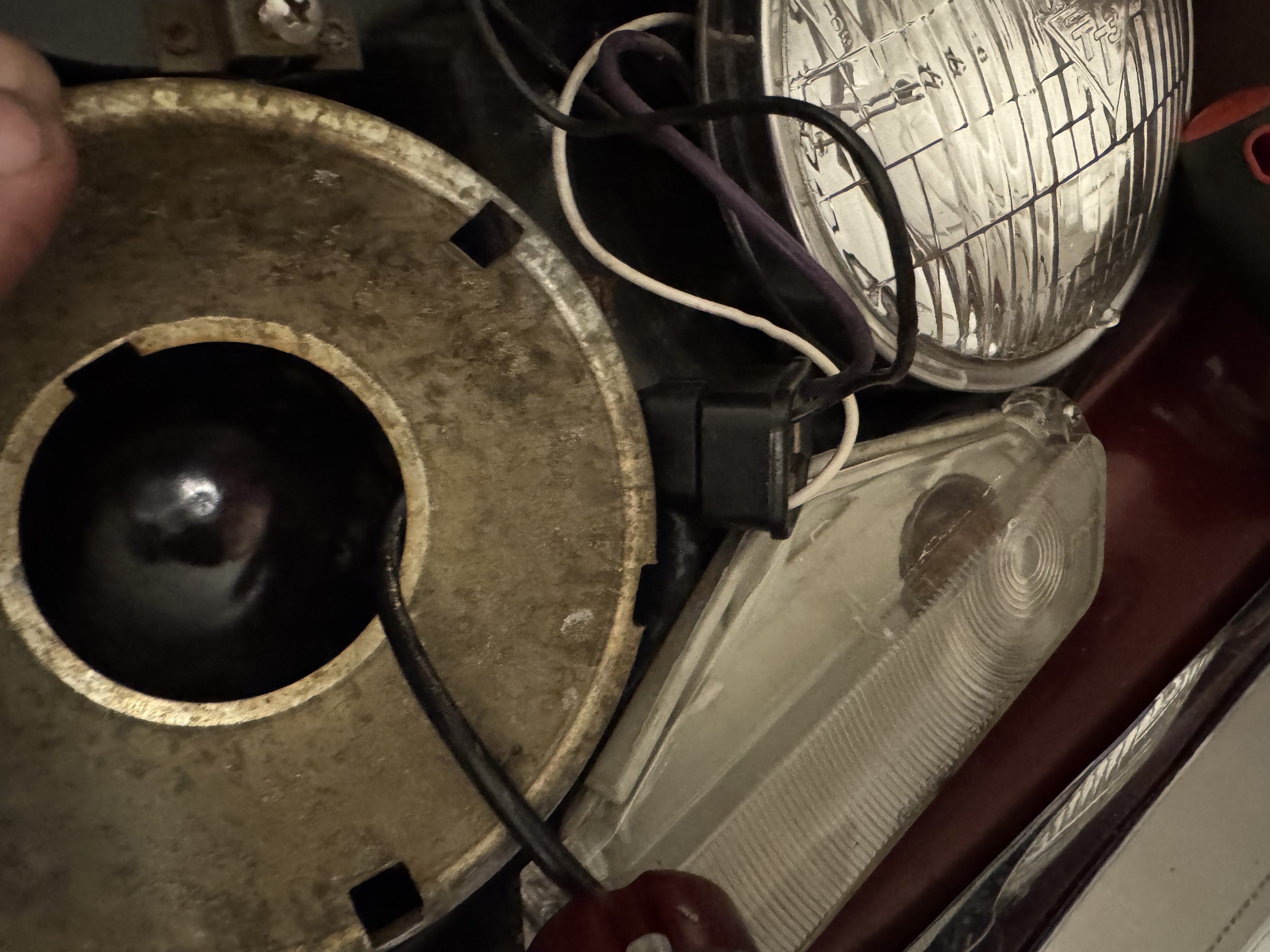

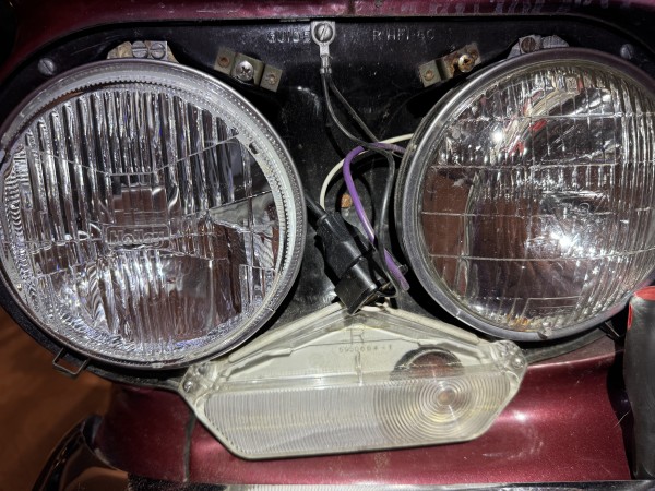

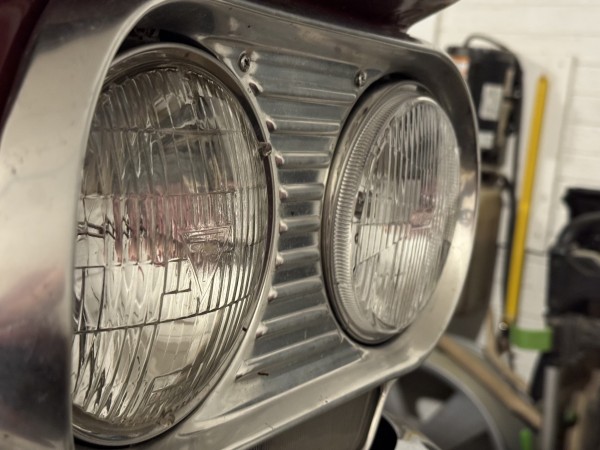

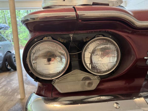

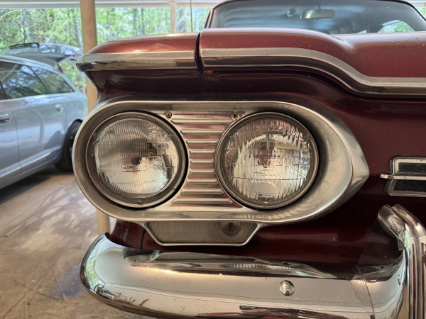

Ok I got he Retro Bright LED lights from Holley. These were sold by Holley as seconds for half off through eBay. They do not seem to be seconds as much as returns or open boxes. Both had clearly been poorly reboxed but were in good shape with no issues I could find.
I only bought the outer high low bulbs because I never use the high beams and I was out of money. :tu:
They fit with no modifications but the plugs need to be pulled into the space between the lights. I am not sure there would be enough room to do the high beams the same way.
they were supper easy to aim and I think I have them set to low, I was worried about having them to high so I went very conservative. I wish I had checked to see what draw was on the old Halogens but the these are supposed to be 25w (Low) / 30w (High)
I have driven at night with them maybe five times now and they are a game changer as far as light output. They have two color temperatures, I got the 3000K which are the warmer option closer to a stock color. The light does not not feel unnatural just brighter. If you are looking for a brighter light these really are a good upgrade, I am very happy so far.
The last thing is the look, they have a flat lens design that next to a stock seal beam light is noticeable. It is not a deal breaker as I don't think most people would notice but car guys will. It would be better if the big beams were the same design.
