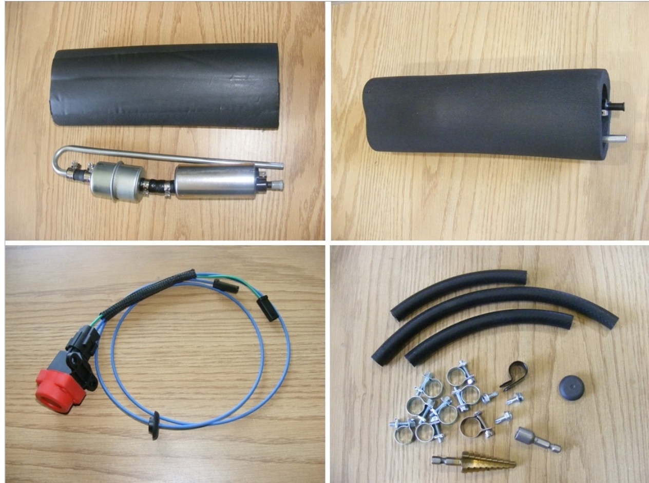

As others have mentioned, I designed and manufacture the only complete, engineered Corvair fuel pump kit. It is very popular; in fact I have trouble keeping up with orders
If you wish to put your own system together (Many Corvair owners are tinkerers) that's great. And oh by the way, what's offered by other Corvair vendors are the basics needed for a DIY installation but the installer still has to work out quite a bit.
If you want a complete, engineered "Plug-n-Play" solution with fully illustrated instructions, this is your kit. As a bonus, the kit installs entirely "upfront" with no need to run wires to the back or any need to add engine switches, wiring, or oil plumbing changes
My kit provides a hidden, protected, silent pump with a factory-made Plug-n-Play harness. I also offer my kit, harness, snd instructions paired.with Ted Brown's in-tank pump. No additional parts are needed and no pressure regulator is needed for any of my kits.
[Find all the details at url]racersrods.com[/url] Once at my site, select "Corvair Products " and scroll down
Thanks for asking!
Thanks for asking!
