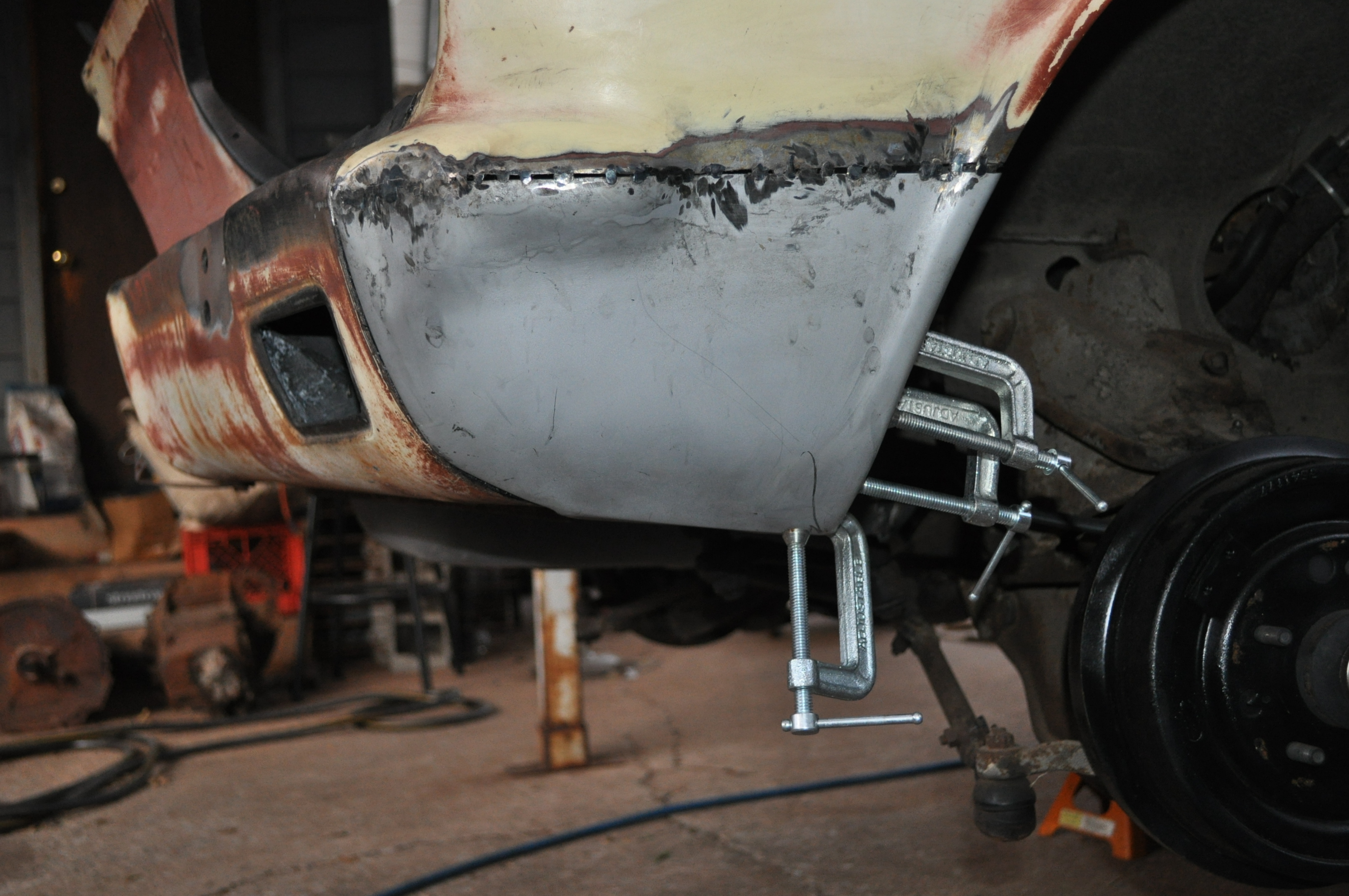

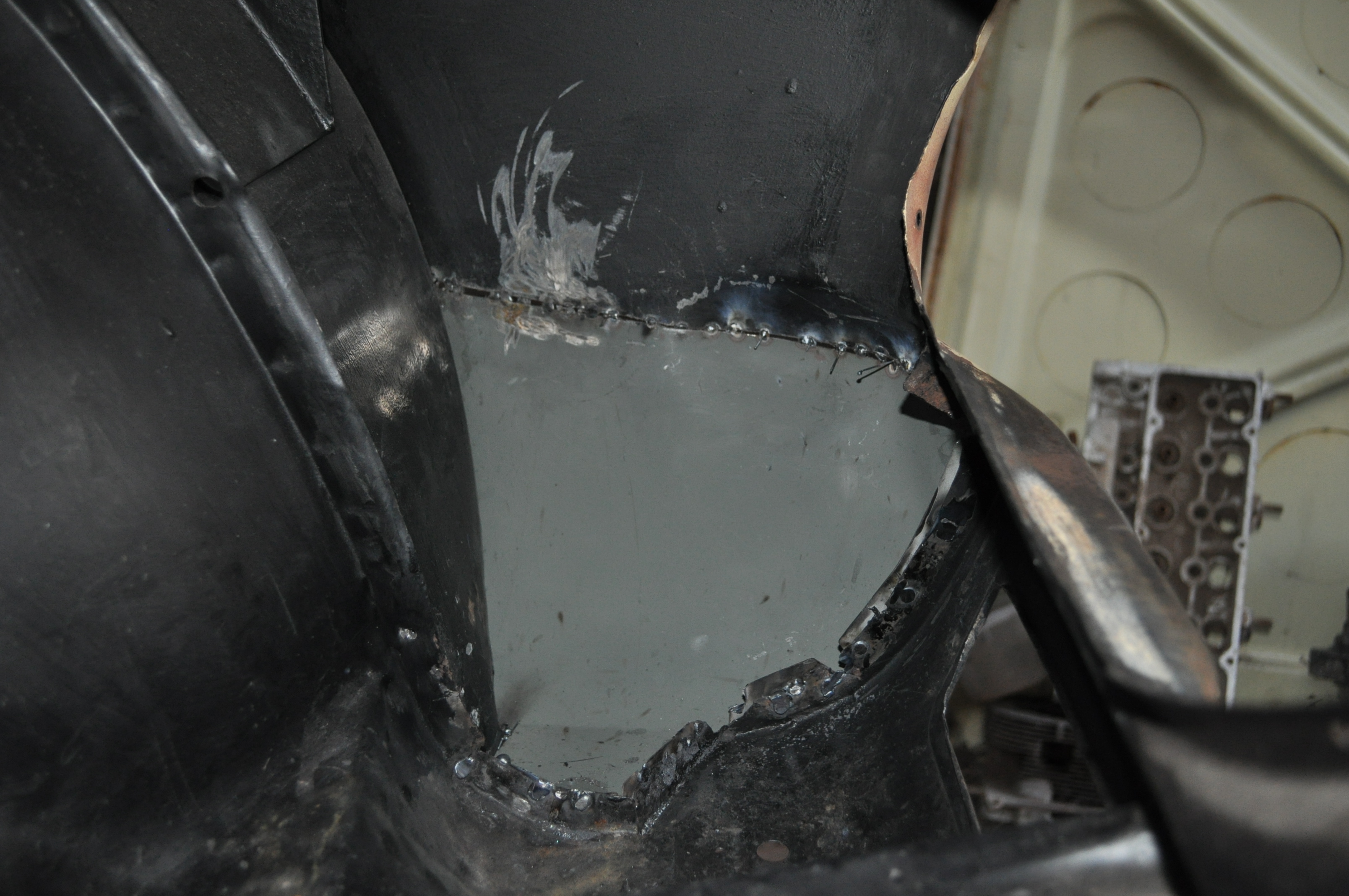

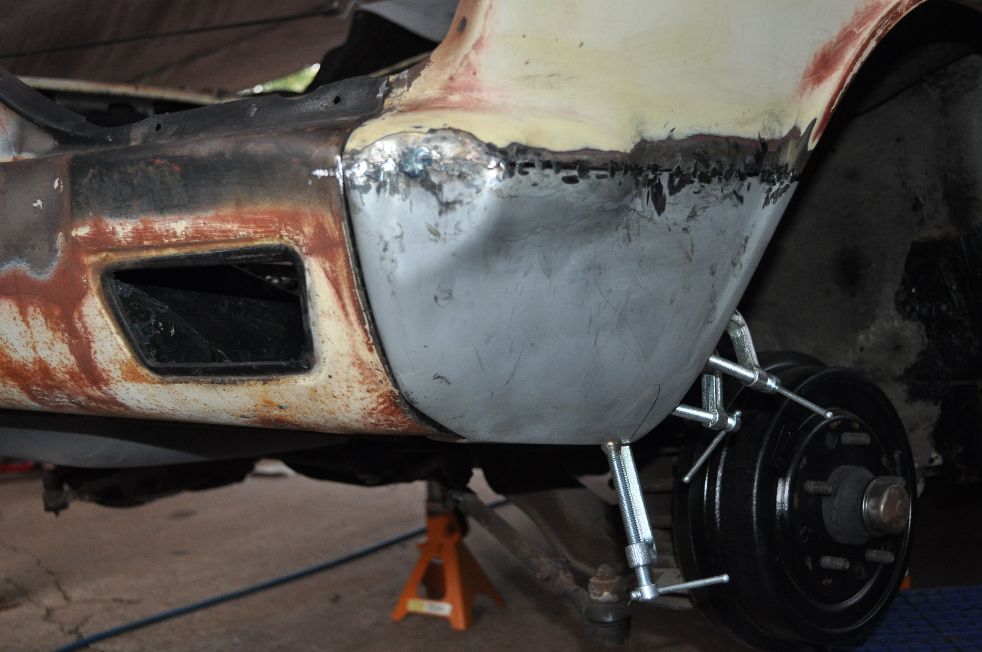

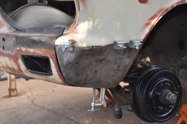

Here is my fitting up and tacking in the little corner patch panel purchased from Clark's.
Inasmuch as there is so much tolerance in the body construction, The new replacement panels do not just fall into place.
cut, fit; cut, fit; cut, fit until you get it as close as possible. then secure by any means and tack away.
BUT I have to say that it is not necessarily the fault of the new patch panels. Too many variables on these old cars!
At any rate here are a few pics of getting the latest patch panel in place.
Thanks to AM-Iron: Allen Amrine and to 65 Topless; Tom Dudak for their encouragement and tips on welding panels. Corvair people are always willing to help a fellow Vair guy.

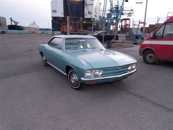

Nice to see somebody welding their repairs. The car I just bought from PA looks like it has been glued together. I can see lots of evidence of repairs but no evidence of welding, even the 2 new floor pas have been riveted and glued in. I have to go over the whole thing. SHAME ON YOU WHOEVER DID THESE REPAIRS AND SHAME ON RIGHT PEDAL AUTOSALES FOR PASSING IT ON TO ME

Mart that car looks great. I would enjoy driving it while you can, and save money and start buying parts. I can't say how much I miss driving my car. The 4Runner is a good car, but definitely NOT a Corvair!!!! I guess I need another one for back up!

I think the types of repairs we're seeing here with these panels being custom-fitted and then welded in....is an example of extreme quality bodywork, definitely in the "full-on resto" catagory and not what most previous owners or bodyshops would do. Although riveted-in new floors?......probably most ARE welded in. That Right Pedal Autosales place probably thought no harm, no foul, you'll never find out and the floors will be secure and watertight.mart wrote:Nice to see somebody welding their repairs. The car I just bought from PA looks like it has been glued together. I can see lots of evidence of repairs but no evidence of welding, even the 2 new floor pas have been riveted and glued in. I have to go over the whole thing. SHAME ON YOU WHOEVER DID THESE REPAIRS AND SHAME ON RIGHT PEDAL AUTOSALES FOR PASSING IT ON TO ME
BTW, I work with brand-new city transit buses and many of their body panels are glued on and I have a new-found respect for that glue they use. You need to use a forklift to pull off any dented or damaged panels! That stuff is wicked!

Unfortunately its not great....its not even safe....its been very badly repaired in the past and is full of bondo and expanding foamAm-Iron wrote:Mart that car looks great. I would enjoy driving it while you can, and save money and start buying parts. I can't say how much I miss driving my car. The 4Runner is a good car, but definitely NOT a Corvair!!!! I guess I need another one for back up!

I wouldnt like to risk my life in a crash if a car that was designed to be welded was actually glued and riveted in the floor and frame areas. Its true, most of the repairs were well hidden , but a lot were obvious too, like bridging the holes in the rear wheelwells with expanding foam, and the front tie bar hanging lose where the crosmember had rusted off. Ah well, at least it will get the repair it deserves nowflat6_musik wrote:I think the types of repairs we're seeing here with these panels being custom-fitted and then welded in....is an example of extreme quality bodywork, definitely in the "full-on resto" catagory and not what most previous owners or bodyshops would do. Although riveted-in new floors?......probably most ARE welded in. That Right Pedal Autosales place probably thought no harm, no foul, you'll never find out and the floors will be secure and watertight.mart wrote:Nice to see somebody welding their repairs. The car I just bought from PA looks like it has been glued together. I can see lots of evidence of repairs but no evidence of welding, even the 2 new floor pas have been riveted and glued in. I have to go over the whole thing. SHAME ON YOU WHOEVER DID THESE REPAIRS AND SHAME ON RIGHT PEDAL AUTOSALES FOR PASSING IT ON TO ME

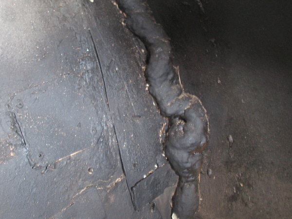

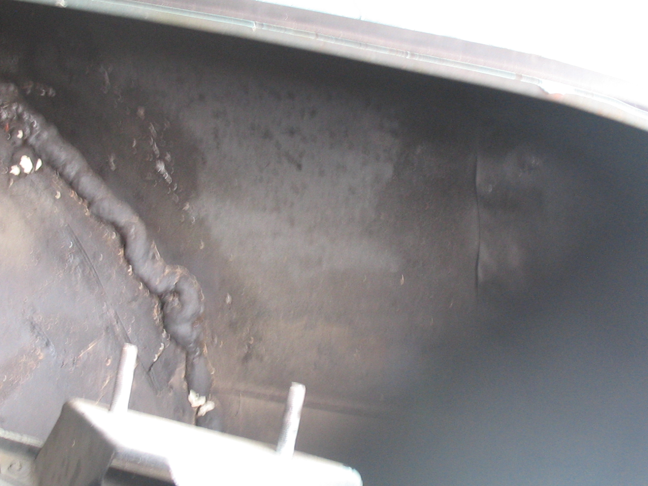

managed to contact previous owner today, it seems he used to leave most of the work to local garages, so we have professionals to blame for this. Have a look at some of the things I found, Ive only had it 2 weeks.

Speechless....

I have been looking through the info supplied with the car and may have found the perp. There is an itemised bill totalling 95 hours work from 1996 , $54 materials, including rivets, and $950 labour.....SNYDERS GARAGE ALLENSVILLE PA...Anyone know it?

Notice it reads "garage", not "body shop"....lol....geez.
