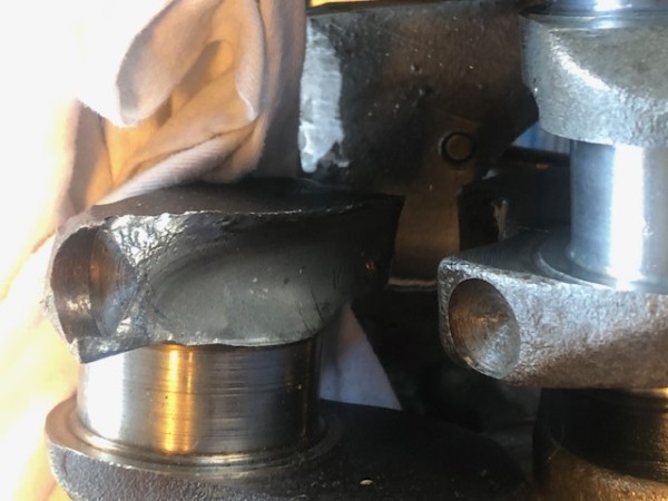

Back to Corvairs: So I now have a theory on broken crankshafts. Note in the picture how deep the balancing hole is bored in the broken crank - where it broke - and how shallow the hole is drilled in the new crank. Dennis

The deep balance hole might have contributed, but there is an abundance of evidence showing Corvair cranks typically break in this area. An opposed engine should be well balanced, but the rod journals require the pistons on one side to be offset from the other side and this promotes crankshaft flexing. The failures typically happen at the 5/6 rod area since that end of the crankshaft reacts with the flywheel motion. This is why the Corvair flywheel is a three piece damping unit.
Corvair enginner Benzinger explained this at a Corvair convention, and before anyone finger points --- the original Corvair engine was designed ONLY for a PG with a flexplate connecting the converter to the crankshaft (typical). The last minute decision to install a 3 speed manual was when Benzinger and team found the infamous #5/6 issue with a solid flywheel. Their fix was design a unique flex-flywheel, otherwise there never would have been a manual transmission Corvair!!
BTW --- Porsche first six cylinder prototype was similar in layout to the Corvair engine. No Porsche DID NOT have anything to do with the Corvair engine design, but they had a friendly relationship with GM and there are pictures of Corvairs parked outside Porsche headquarters. GM looked upon Porsche in the 50's and 60's as a "cute" little company and they often welcomed Porsche folks at GM to observe and learn (at that time GM got a lot of respect from European manufacturers). Porsche quickly discovered the flat boxer six crank flex issue. Their next prototype increased the number of main journals and there were TWO at the flywheel end. The rest is history!
Keep in mind the Corvair engine was suppose to be an econobox engine that far exceeded original expectations and the Porsche engine was designed as a premium vehicle engine so higher costs were acceptable.

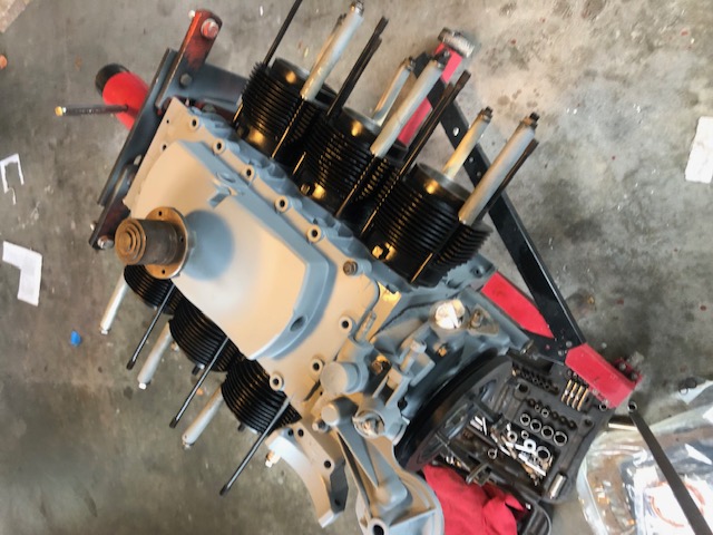

So progress report time. Started off Friday afternoon by greasing the blower bearing. I hear about tool to do this. I ended up drilling and tapping a 1-1/2 freeze plug and installing a 1/8 NPT grease fitting. ALMOST worked. I used a piece of 1/8 cork to make a gasket, took a really big washer and made 4 notches to align with the 4 holes on my 1966 top cover / blower bearing. THAT did the trick. I could then slowly pump grease and I felt it go past the seal. Pumped a little more and saw just a trace from the bottom seal. Being concerned about the grease expanding and oozing over my engine, I then took a propane torch and heated the hub up a little. Some excess grease came out of the top seal. I cleaned that off, let it cool a bit them spun it up using the wire wheel on my bench grinder. Just a little more grease and i wiped it off and believe it's good to go.
While doing this, the self etching primer on my short block was drying. I had made covers for the cylinder holes and masked everything else off. After the primer dried good, the block got a good coat of machine gray. While most of the block had been in fairly good shape, some of the aluminum parts had a light powder, so everything got cleaned and painted.
After drying overnight, I installed the 6 cylinders and rear cover. NOTE 1: when doing this, don't forget the oil slinger (I didn't). Note 2 when installing bearing shells in the block and rods, make double sure everything is clean - block and rod surfaces where shells will go, block mating surfaces, rod caps and rod surfaces, inside and outside of bearing shells. A light smear of oil on each bearing surface and bolt it all up. The # 1 rod cap seems to be the most difficult to torque. There is a large crank counterweight there and the right combination of socket and torque wrench to fit in. Note 3: I used copper cylinder base gaskets. There seems to be "some do, and some don't" as far as putting anything on those gaskets. I didn't. My thought pattern: I don't put anything on a copper oil plug gasket, why should this be any different? Note 4:when assembling the block, don't forget to reinstall the oil pickup tube I I figure a lot of builders will be excited at this point and a little reminder of these things may save someone from having to "go back in". It feels good to finally have these bearing all put together and sealed up. The top covers in the picture are just on with a few bolts as an extra measure of keeping any dust or dirt out of there. The garbage bag wraps go over everything else. Next up painting and installing lower cylinder covers, and starting on the heads. Dennis
