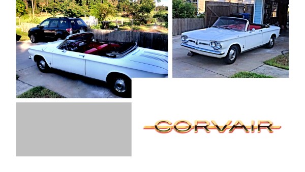

So here's the new "acquisition". A 1962 Monza convertible. A 4 speed car, white, white top, red interior (I've had a thing for the red interiors since I was a kid). Top and interior were replaced years ago. While it was originally advertised as having a rebuilt engine, the engine, while appearing to have had some work done, certainly doesn't look "rebuilt". It appears to be a 110 HP, and not the original 145CID 102HP (it has a harmonic balancer and the upward crankcase vent tube instead of the road draft tube used on the 1962s. The engine does have an aluminum pan, but not the deep pan (probably a good thing. The engine was suspended in the engine compartment by a 4" nylon strap that was wrapped around everything (I'll have to post a picture of that later). The transaxle was in the trunk. It appears someone may have tried to remove the transaxle to replace the clutch as the transmission was obviously removed improperly. There is a NOS GM crankshaft that has light surface rust on the throws, but the journals appear to be well greased. There is a set of Clevite bearing shells all still boxed. a complete gasket set was also included. 4 new brake drums, a set of rear shoes, underneath it appears to have new rear springs and shocks. The transmission clutch shaft was missing, but I already bought a NOS one off evilbay. Definitely missing some carb screws that hold the linkage on, the choke rods, and the bellows and the temperature control doors. I'm thinking I might try running the engine on a stand to see how it does. That's probably still a week before I get to that. Dennis

Welcome and good luck with your project, it does look like it has “good bones”!
Gary Bullman

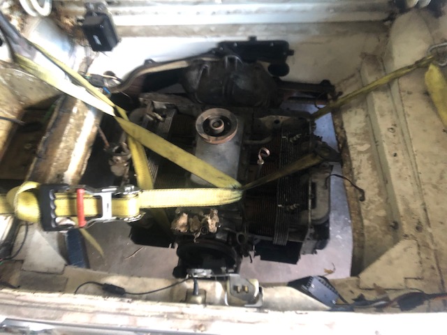

So here's the way the engine was "mounted". It was held in by the single rear mount nut, and the nylon strap wrapped around everything. It was also wedged up against the forward face of the engine compartment. I was told that it had shipped from California on a transport this way and that there was a Porsche parked on the transport UNDER the Corvair (well, that's what I was TOLD). I can tell you this: I think I have had bolted in engines that were easier to remove. Dennis

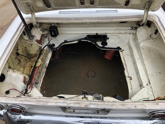

It sounds like you have your work cut out for you in the engine compartment, but overall the car looks good! I tried a little photographic clean up work that will hopefully serve to inspire you with the car's good looks and potential as you work. :tu:

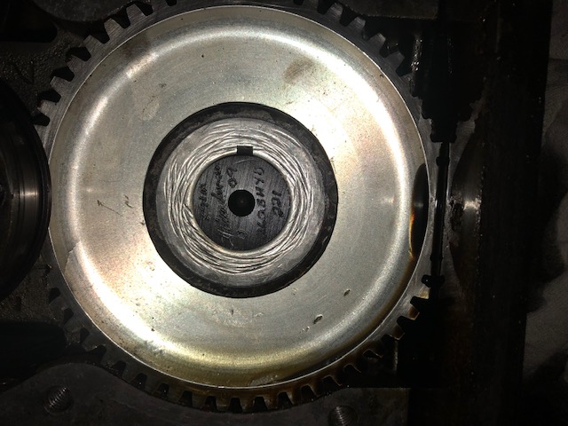

Here's the latest: I just popped the bellhousing off. looks like it's broken on the #5 or #6 throw. The cam gear is boogered up. I have: TO427Z for a block number, 3813516 on my right head. The cam is engraved. "X91M Thundercam? 0 09 2603HYD 221" Does this mean anything to anyone? My concern at this point will be for the bearing bore in the front web being damaged. Full teardown will determine that. I'll try to add the cam picture. Dennis
Note how they beat the cam gear on. REALLY? There's a proper way to assemble an engine. I've run into this before, people who don't know or understand Corvair engines trying a rebuild. Had one where the cylinder baffles had been installed on TOP of the cylinders. D.
Edit 2 So apparently the engine was built April 27th. Head number indicates it is a 62-63 head. So maybe I have an original engine that was fitted with a harmonic balancer? Now I need to check my new crank and see if it's a 145 or a 164 crank. That will be tomorrow when it isn't raining.

I'm amazed the cam gear stayed on!!! I know from experience they are NOT easy to install and STAY TIGHT. I read all about freezing the cam, heating the cam gear in an oven --- total disaster. That aluminum gear cools VERY FAST. I finally let Jeff at California Corvair install his BILLET cam gear (better than stock, or Clark's cast gear). Even more difficult to install. Jeff has a heat plate that keeps the gear hot while the camshaft is inserted quickly. If you don't keep the gear hot, then the camshaft will broach the gear hole and it WILL come loose eventually.

Yup cranks almost always break at the 5/6 throw. BTW - it's why the Corvair has the UNIQUE three piece (damping) flywheel. Engineer Benzinger gave a nice talk at a COSA convention and said the Corvair was designed ONLY for a Powerglide transmission, but at the last minute a manual transmission was requested to compete with Ford and Chrysler (their compacts sold the automatic as an EXTRA COST option). Benzinger said when they took the test mule for a drive it made a huge racket and rumble with noticeable vibration at certain RPM ranges. They discovered the PG flex plate and torque converter DAMPED the flexing in the crankshaft! A solid flywheel on the 5/6 end caused the flywheel to resonate with the crank at certain RPM. It took a few tries before the came up with a flywheel riveted to an elliptical (thicker at crank bolt holes) flex plate (that wound not crack). It was a brilliant piece of engineering - except the darn rivets come loose at around 50 to 90 thousand miles. BTW Porsche designed their flat six AFTER the Corvair engine design and they found the same issue!!! Porsche added a LOT of main crank bearings (two on the flywheel end) to fix the issue.

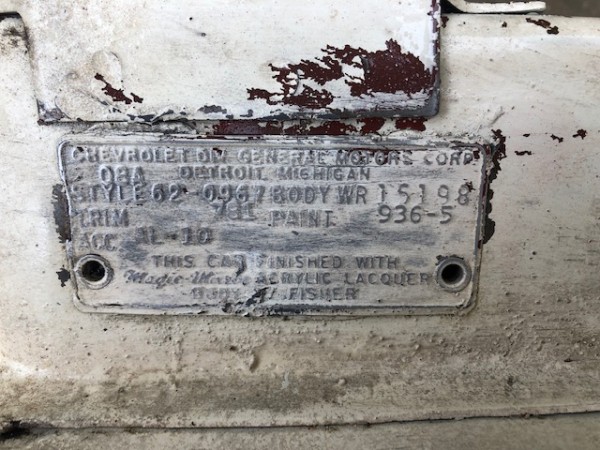

The "Ralphie update": I checked a lot of numbers and I do indeed have the early bell housing. My cylinder heads match for the 1962 year, and my NOS crankshaft is the correct crank for a 145 CID engine. I did get he engine mounted to my engine stand (kind of tricky with the bell housing removed. As I was disassembling the shrouds and other parts, I used a small parts drawer cabinet to separate the various bolts to make reassembly easier. I haven't gone into major disassembly yet as i have other "loose ends" to tie up before getting deep into the Corvair (ATV and sail boat need to go away to keep WIFE happy). I did clean up the engine compartment (something about a white car with a greasy engine compartment). I was kind of concerned about what was in the upper front corners (rust?) and the funky rubberized coating on the battery box (more rust?). Turns out the stuff in the corners is discoloring of the caulk or body putty that was there, and the rubberized coating peeled right off (well, most of it). NO rust found. I'm also including a picture of my Data plate. Dennis
