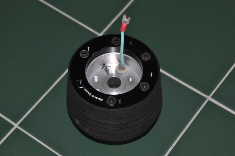

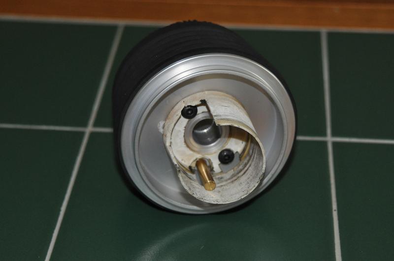

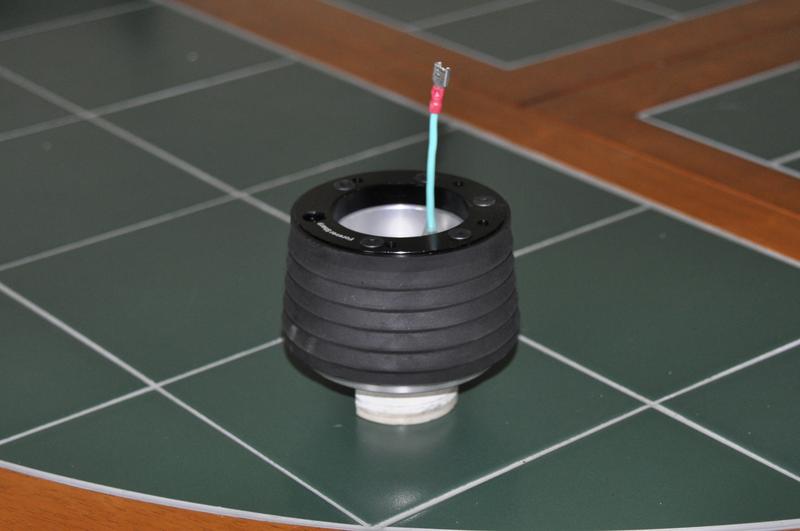

Thanks, got it. Here are some photos of current doings on my Corvair. I found that the black rubber 'slip on' cover ( from the Mustang adapter) fits the hub and adapter that Seth sent me, like a glove! This will help somewhat the look of originality and the hub won't stand out ( and I didn't want to paint it flat black. After preparing and sealing the exposed HOT horn wire lead with E6000, I decided to glue it into the hub because I never need to remove the plunger but if I ever needed too, it could be pressed out. Anyway, got photos of the Corvair with the new mirrors on and even one of my boys hanging out with me. BTW, those are original GM mirrors, only listed for the 1955, 56, and 57 Chevy but they looked just like the original Corvair mirrors and the screw mounts lined up!! And yes, I know Corvair mostly only used a driver's side mirror, but, I like balance and the sporty look. Not bad for $59 a pair.
