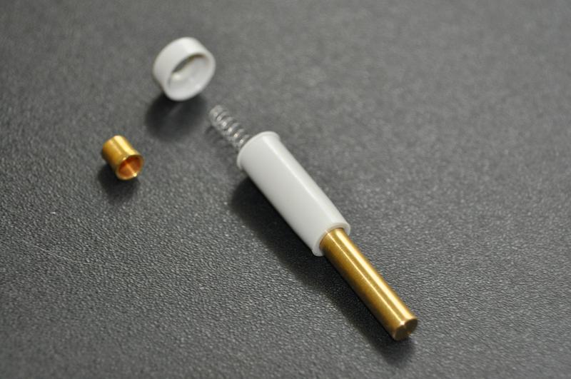

OK, while looking at Seth's website, it was starring at me all this time and I never caught it!! This is the 'wired' plunger that I should have gotten with my kit!!! I'll give him a call right now!! So glad I finally caught this! One is a plain brass plunger and one is a wired plunger. :tu:
Last edited by 64CorvairMonza on Tue Dec 10, 2019 12:55 pm, edited 1 time in total.
64CorvairMonza
Posts: 125
Joined: Wed Nov 20, 2019 9:08 am
Location: Palm Coast, FLA.
Re: My 1964 Corvair Monza Record Of Improvements
Post by 64CorvairMonza »

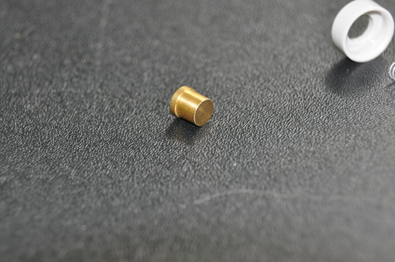

OK, I had gotten curious after I found another website suggesting pulling the plunger apart. I went and took a closer look at it and it appeared to be able to come apart. I held both ends of the two plastic parts in my fingers and gave them a twist while slightly tugging and they clicked apart. I checked to see how easy to assemble them and they snapped back together again. Before I did anything, I called PerfVair.com and spoke with Seth and he suggested that folks usually soldered a lead wire off the end of the short cap and re-installed it. I was glad to see that it came apart because there was no way to solder the wire on without melding the small plastic cap.
Anyway,easy peazy!!! OR you can request one come pre-wired. No biggie. I've a lot of experience soldering micro boards, I think I can handle a copper cap. I thought about drilling a hole through the cap and running the wire through before soldering but I won't. I will attempt to find an old fashioned fuse holder and take one end of the wire out and solder the end plate to the copper plunger cap for a better connection. I wish I hadn't wasted a whole day on this but I should have thought of the fix. Anyway, all's well that ends well and Seth from www.perfvair.com was very helpful and even suggested sending me one if I couldn't solder LOL..... Seth also told me that once you set into the hole in the adapter, place a screw in the hole next to it where the head of the screw or with a washer will hold the plunger in place so it don't pop back out after install. And I'm sure the parts are copper and not brass cause my fingers smelled like a was rubbing pennies between my fingers. Anyway, thanks for all your help!!!!!

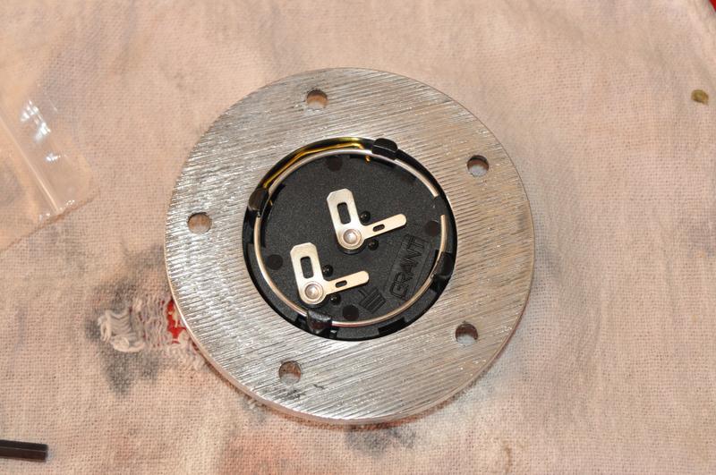

I'm not a happy camper and for the price I paid, I should have at least gotten the right plunger! I have learned a valuable lesson here and this has wasted a whole day. I decided to drill a small hole in the end of the copper cup and after tinning the wire, run it through about 1/2" to hold it so I could solder the wire without if falling off in the process. But first, I sanded the cup with very fine wet sand/dry sand and tinned the cup surface. I stuck the wire through the hole and attempted to solder it to the cap. NOW I need to take the Dremel to it tomorrow and try to grind down some of that soldered wire inside the cap where the spring goes. I'll see if it's still holding solid after I grind the wire out. Not worth the photos.
I also took my Multi-meter and put it on continuity to check the horn button pins against the ring they are snapped into as it will be a ground once installed.. I thought one would be grounded because of the wire that is pressed against the metal ring (see photo)they are mounted in that would ultimately be grounded once the dress ring got mounted on the steering wheel and then into the column. I got a reading off both pins touching one at a time while touching the outer ring. Are they grounded? If so, I can't hook a 12 volt wire to one. Should I get a reading from both pins testing them one at a time? My guess is that one leg at each end of that grounding clip is touching each plug end on the horn button. I assumed that one plug on the horn button gets the positive wire from the plunger and the other plug to a ground screw inside the steering wheel adapter??? Is it so hard to include correct instructions for installation???? I see a 'GROUND' symbol at one pin.
