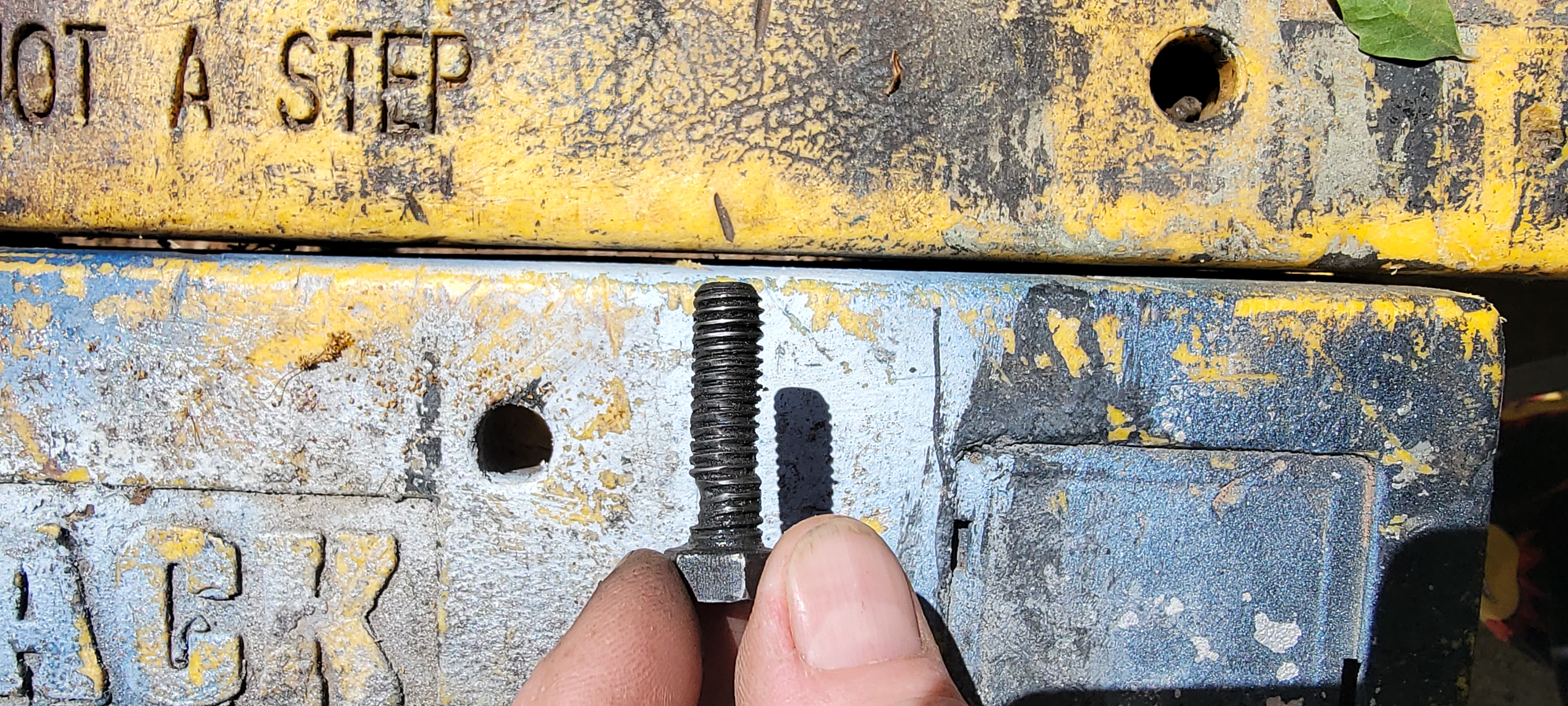

Been a LOOOOOOONG while since I've posted and have been driving the car, with good success here and there. 20+ miles to the gallon isn't bad, but commuter status it isn't looking the best.
I've been encouraged by the upcoming Corsa Convention and talking to Phil Dally, my focus on Corvair has sprung afresh. Cleaning up and getting parts together and getting some mechanical stuff done on this car. Transmission fluid leaks are plaguing me, but I think I have a handle on it. The shift cabl, and governor o-rings needed replacement, and I hope the governor bell seam isn't leaking. The mounting tab seemed pulled and malformed, so straightened that up and installed with new o-ring with a little grease on it for good luck. :tu:
While under there, I noticed something that startled me. The crossmember to front of transmission connection had curbside bolt loose...top roadside bolt was MIA...and lower curbside bolt had walked out and almost sheared off!!!! (see pic) :eek:
Anyway...happy motoring, and hope to see/talk to some of you in SLO, next week. :wave:
