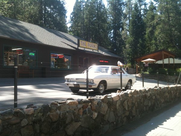

Thanks Jeremy, took her for a spin yesterday morning, up in the mountains. She ran well...I have to say tho, to all out there with a PG...make sure you watch your fluid level. I made the mistake of slightly overfilling the trans fluid. She ran good all the way up there, about 35 miles and about 2500 ft. of elevation gain. As i pulled into where we were having a picnic, it was on an incline, so i believe the overage of trans fluid seeped into the intake. She started burning trans fluid and smoking a bit. I was worried about what was causing the issue, until i figured that i had over-filled the night before. I found a piece of 1/2" plastic hose, and siphoned out about 8 oz. from the dipstick tube. Luckily the plugs were'nt too fouled, and when it was time to leave, she fired right up. Smoked a little, but then cleared right up. She idled a little low, since we were up at 3500 ft., but that wasnt too long, then we started back down the hill. It was a pretty warm day too, 101 degrees, we left home about 10:00a, and headed home about 4:00p. It was pretty darn hot by then. We made a bee line for the closest watering hole with air-conditioning. Had a cold drink, and waited for it to cool off a little, then headed home. Prolly about a 100 mile round trip tour, and it was fun for me and the wife. Glad the car issues were not too serious.

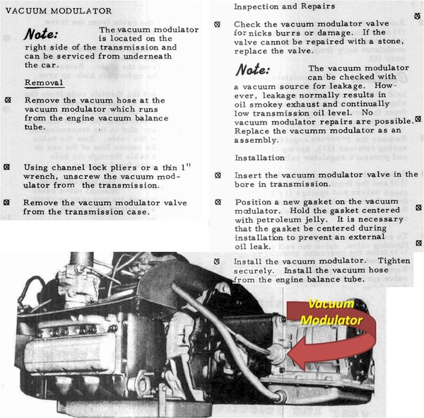

:think: I don't believe an over-filled transmission would normally have any path into the engine intake system — unless there is possibly a ruptured diaphragm in the vacuum modulator on the right side of the transmission. This would be the only connection between the automatic transmission and the engine intake system. Normally a vacuum modulator would prevent any transmission fluid from making its way into the vacuum hose and tube, and on into the engine vacuum balance tube. I would recommend temporally disconnecting the vacuum hose from the vacuum modulator and inspecting it. If it is wet with ATF inside the vacuum hose, you probably need to replace the vacuum modulator unit. It is not rebuildable.
Vacuum Modulator
Vacuum Modulator
(See the comments below under Item 59 from the Clark's Corvair Parts online catalog regarding the vacuum modulator).
:link: http://www.corvair.com/user-cgi/catalog ... N&page=135

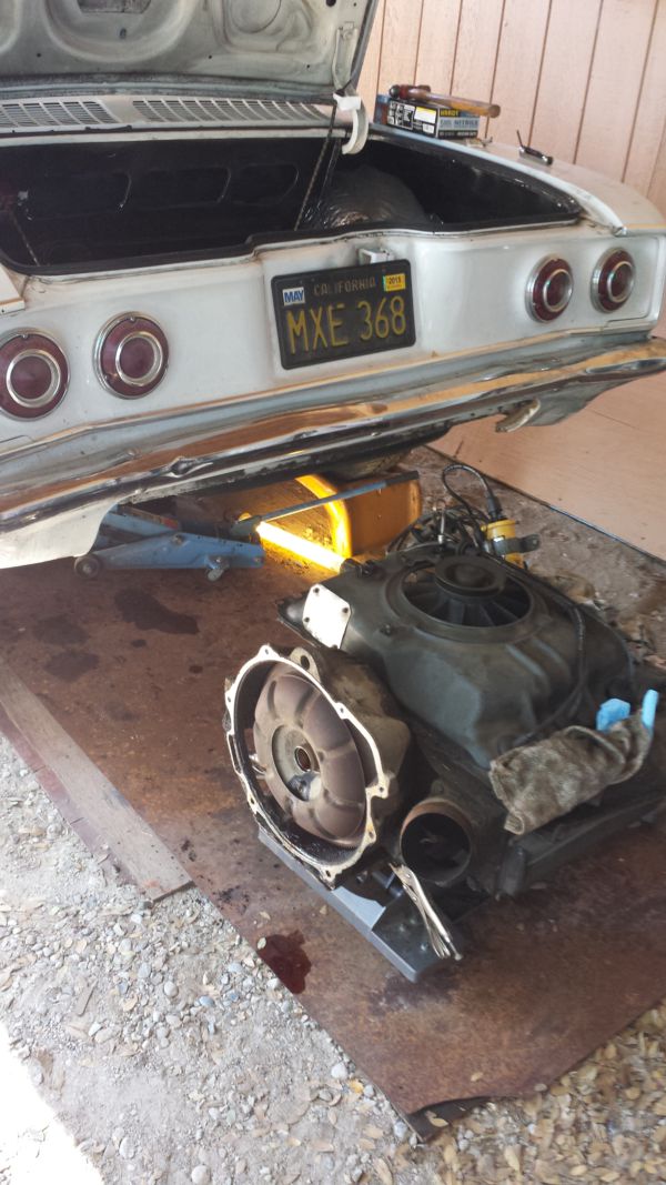

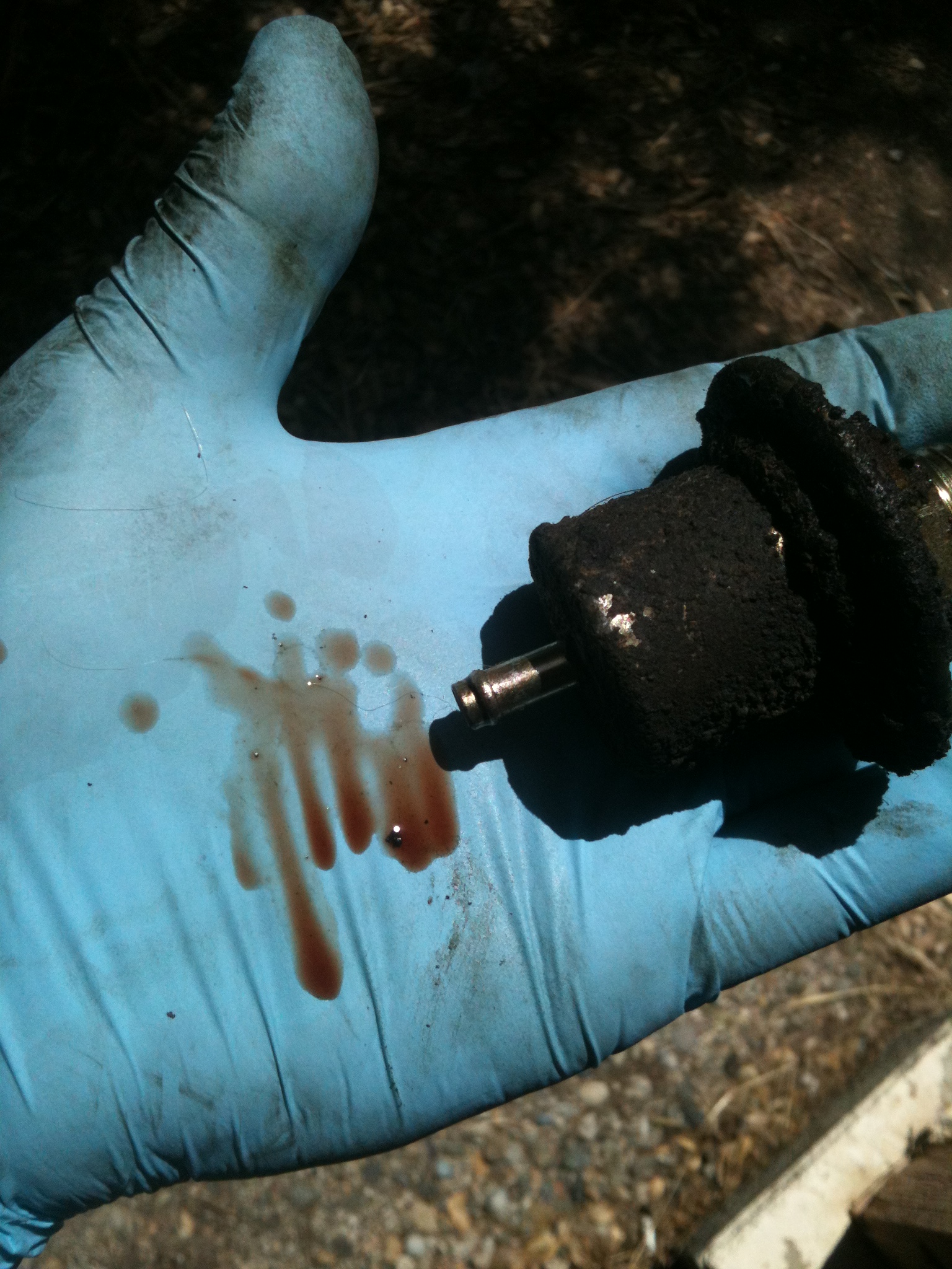

Okay...looked at the modulator, took the hose off. The hose was wet with trans fluid, but not dripping. Took the old modulator off and here is what i found.
Shook and tapped the vacuum connection on my hand and trans fluid came out. Also...once i made a test drive, i found it wanted to rev up between shifts. Once it got up to temp tho, the shifting settled in. Once i got back from the test drive, i kept it idling in neutral, made sure my trans dipstick was the correct length (thanks Brad), and checked fluid level. The dipstick needed some straightening to make it the correct length, and i was about 1 qt low on fluid, so i topped it off. I will go out in a little bit and make another test run.

Clark's says about ten years on a vacuum modulator, but yours looks like it might be the original! It could be almost fifty years old!!
Hopefully each of these steps are getting you closer to where you want to be with your Corvair. :tu:

bbodie52 wrote:Clark's says about ten years on a vacuum modulator, but yours looks like it might be the original! It could be almost fifty years old!!
The way the short vacuum hose snapped like a twig when i removed it...i believe you are correct Brad. LOL

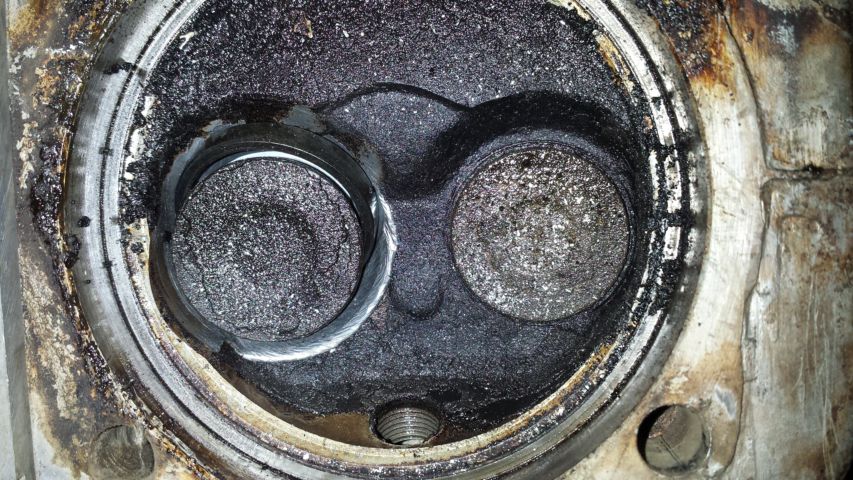

Was driving home from work early April, when i got on the freeway ramp and something happened. Loss of power and a rhythmic shooshing sound. Was unsure...so i did a compression check and got 0psi in #5 and a reduction of 40psi in #3. Thought i may have broken head studs or something. People said "...you dropped a seat". I didnt want to hear that...but...taking the head off...fears were confirmed.
Dropped intake seat on #5

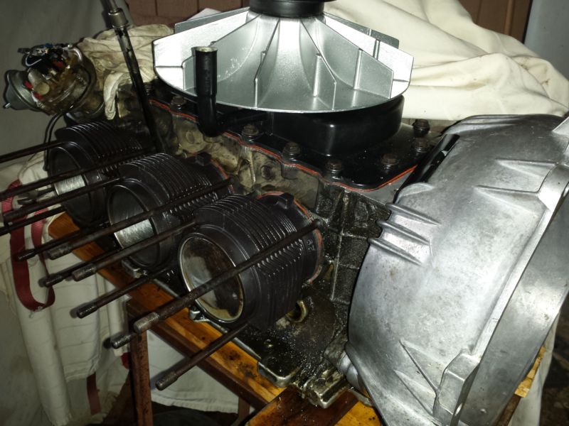

So...needless to say, i have been working on getting the 500 up and going again.
Engine out...
Engine out...
Did some other oil leak reduction practices while she is out too. Also...freshening up the tins and cleaning engine. She gone run really fast now. :tu:
Engine on stand...gettin a spruce up.
