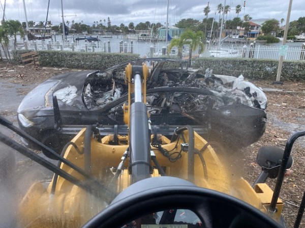

Latest update: So when we last reported I had just finished (most) stuff on the '64 and returned it to it's owner. Then I took a vacation up to Michigan for a family wedding. We returned late Monday night to the news that there was a hurricane rapidly approaching (my boss says "the next hurricane is always 14 days away"). I had Tuesday to secure my house, Wednesday to go to work and prep and evacuate vehicles and equipment, Thursday to hunker down during the storm (lost power), and been working 8-10 hour shifts since and until further notice. FWIW, most of the island was under 3 or more feet of water (including out shop). I've spent most of my time in a CAT loader removing debris and swamped vehicles (BMW convertible, 3 Mercedes, about 8 other vehicles), docks, a small barge, trees.
The good thing, my family is all okay, the Corvair stayed safe in my workshop (although a 20 foot branch from my neighbor's tree is lying next to the shop). So far we've seen a minimal loss of life in the area, but MUCH loss of property. Eventually, I will get back to "normal" or whatever abnormal looks like.

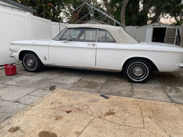

Wow! I've made no updates on my '62 since June. SIX whole months. Way too much stuff going on. I've been "picking" at the car a little here and there for about the last month. Still a lot of the other distractions, but I need a little "me time" here and there. Biggest was scoring a set of 13'' Maxis whitewalls. That led to breaking down the existing tires (one at a time) mounting the first tire on my spare rim, and then sandblasting, cleaning, and painting the rims that came on the car. I used the Duplicolor DE1635 engine paint (same as used on my tins) for the outside of the rims, and regular Rustoleum black engine paint for the insides (I already had a few cans and it is less expensive than the Duplicolor with negligible difference). FWIW, anyone that goes into much detail painting the inside of their original rims is wasting time and energy. GM did a sloppy job with the original paint with bubbles, runs, and flaws on all the insides I painted.
After mounting the tires, I initially left the lug nuts finger tight for other work coming up. That work was replacing all the rubber brake lines, I had bought them back in June before the bottom fell out of my world. Because I would be bleeding the system (again) anyway, now was a good time to remove the master cylinder, clean it, and repaint it. It was apparently new and never painted when the car went into storage, but the Florida humidity made the outside look like crap.
While wheels, brake lines, and bleeding was in progress, I decided to remove the front hubs / drums and drill out the rivets so I can inspect the brakes any time I want without messing with cotter pins and wheel bearings. Yes, GM riveted them because of possible brake noise, and if I experience any effects, I will tap the holes and install screws like my more modern drum equipped vehicles have.
Also installed my Sethracer plug wires that had been purchase in June as well. Since it hadn't been cranked since May, it was "wake up" time. Got it started right up with a little flooding that went away with a light tap to each carb. After idling for a few minutes, the lifters got happy and it purred nicely (I do have the Clark's "ball" float valves.

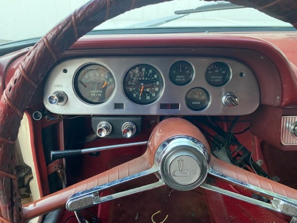

Then I got back to the Spyder instrument panel project. First gen instrument panel and behind the panel work is NOT FUN. My '62 did not come with an instrument panel plug, so after running wires as necessary for the extra gauges and bulbs, I added a plug so it could be easily (take that with a grain of salt) removed if needed in the future. I did have to pull it back out as the tach wasn't working, that turned out to be a wire that wasn't hooked up under the rear.

Love the dash. I got the same one in my 63 vert.
I out an oil pressure gauge in place of the turbo gauge.

I'd love to see a picture and model / make of your gauge. I considered it. Same plumbing, just slightly different route.
