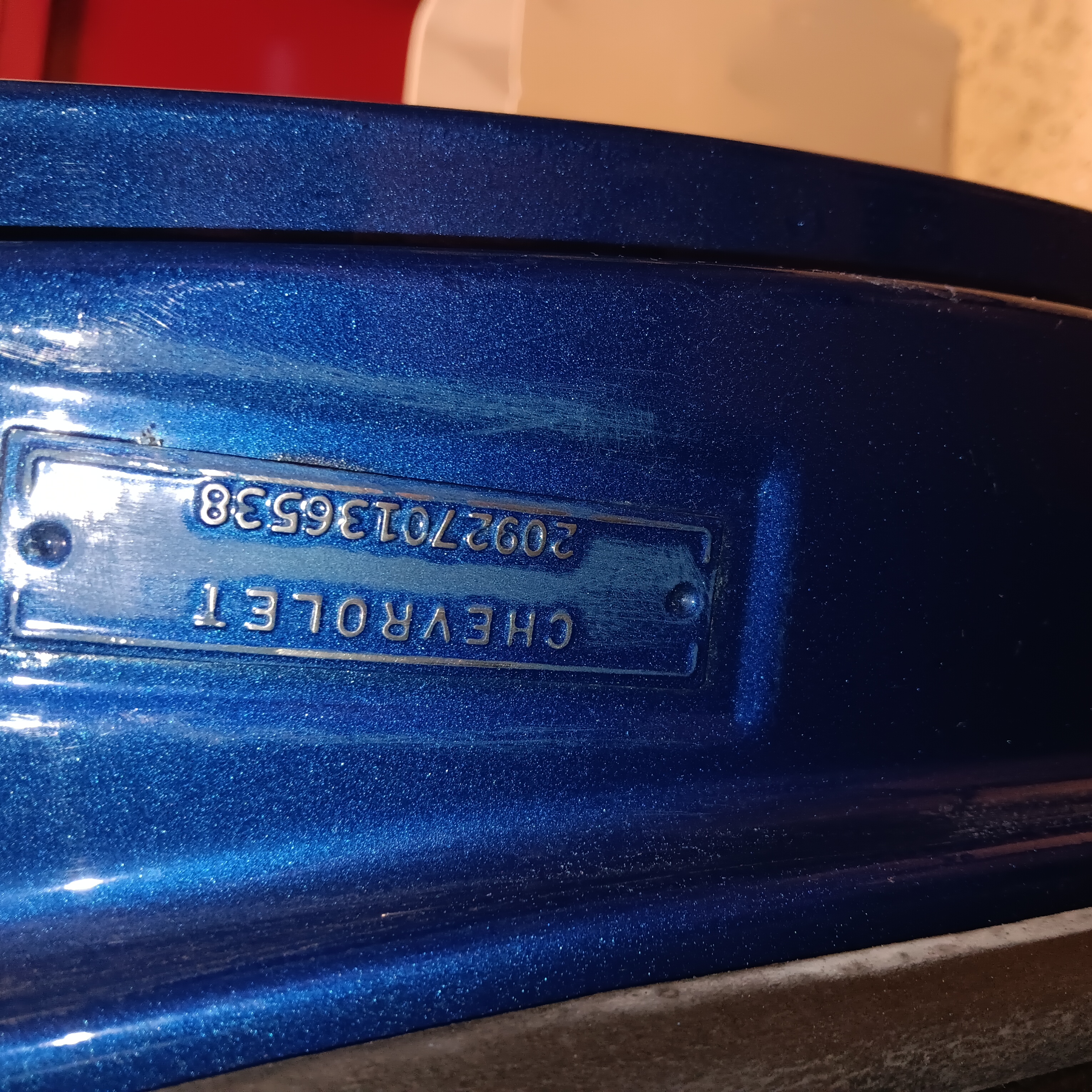

Hi there - new owner and member - have read many posts re this subject, but still confused....headed to AZ MVD Monday for title & registration, so any help would be greatly appreciated.....we thought we bought a '61, but everything is telling us it might be a '62, but we have no idea what model it is other than a 2dr...
Thanks much for any help you can provide....

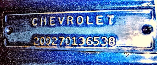

The V.I.N. tag on the door jamb appears to be correctly spot welded and is likely original.
The Trim tag in the engine compartment also appears to be original and not tampered with.
Both indicate a 927 code which would be correct for a 1962 Monza 2dr sedan which appears correct for your car.
I seem to recall prior discussions suggesting that some States would have their own ideas and ways of registering New vehicles. IF for example, a 1962 model year vehicle was actually manufactured in 1961 and registered in 1961, it got titled as a 1961 even though it was sold as a 1962 model year by the manufacturer.
IF the V.I.N. on the title matches the V.I.N. on the vehicle, I doubt there would be any issues processing it.
There is a chance that the Motor Vehicle Administration might recognize that a 1962 vehicle was incorrectly originally titled as a 1961 model and correct it without further questions OR, they might want you to go through a number of ridiculous and unnecessary steps to get the vehicle titled....It could be easy or difficult depending on their point of view.

Both tags look to indicate a 62 model.
Re: VIN & Body Tag Help
Thanks guys - I really appreciate the info....now on to the body tag so I can figure out what was supposed to come with it....

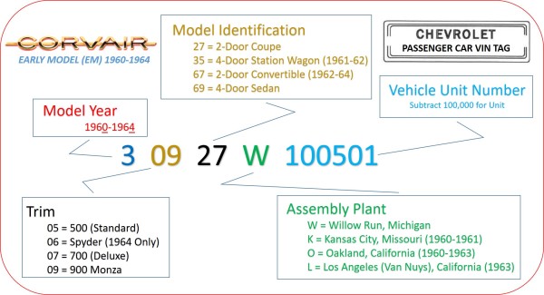

The VIN tag is located in the left door jamb.
I have attached a copy of the 1962 GM Heritage Center Specifications and Owners Manual
