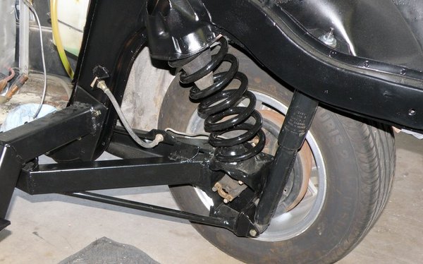

In an effort to be honest on this build, I need to report we had an EPIC FAILURE with our original trailing arm design. As the car was moved around from the main garage to the storage garage, the rear tires cambered in and out at will. At first we thought it was no big deal figuring the mounting plates might not have been tight enough and were slipping. Once we got the car back into the garage and took a look, we found the use of the metal surrounding the original rubber bushing was not going to work. We had cut the rubber bushing out of the sleeve thinking that would be all that was needed.The sleeve which was a pressed fit broke loose and that was the end of that. You can see the sleeve in the main mounting hole in this previously posted picture. We never welded the sleeve in thinking the press fit would do the job.
Next was finding a solution. I found some 2 inch OD pipe with .250 wall. We took it to the machinist. He turned down the OD to match the trailing arm opening. He also turned down the aluminum bushing to fit inside the pipe. The piece of pipe ( about 2 inch long ) was tig welded to the arm itself after squaring up the entire assembly. Yesterday ( November 14th ) we brought the arms back to the garage and bolted them on. BINGO....we pushed the car out side, down the driveway, turned it around and around and around and around again........rear tires still standing straight up as planned. We were happy campers. To make sure we do not have this problem again, we got some pieces together to make a wishbone mount that will run from the main cross member to the original mounts for the control arms. There will be a hiem jointed bar running between the arms of the wishbone..........problem solved !!

Big Day at the garage
This entire suspension thing has really been holding me down. After the first major failure, everything has been thought to death. We think about what to.........we talk about what to do......someone else gets in the conversation and we talk and think about it some more. I was just about ready to go up on the roof with a magnum and start picking off people in the neighborhood just to show my frustration :assault: ............We finally decided on what we were going to do. First we stocked up on some thick wall (.156 ) tubing. We cut a couple of small pieces of tubing to make spacers. We added some washers to the ends to make them 2.750 wide. These will be the basis for the Camber adjustment units on the bottom of the trailing arm. We got our heim joint and some brackets together to make our center pivot. We made our center pivot mount out of 3 nuts which we welded together.....more on this in a minute
Here are the bits and pieces
Next came the arms. We welded nuts to the end of the thick wall arms and used 1/2" X 1/2" heim joints as rod ends. Laying next to the arms is another piece which slides on the spacers. The tube and tab are chormemolly . The arms will bolt to the tabs.
Here are those pieces
Once we made sure the concentric was centered, we could start the assembly process. Here is how the arm bolts to the slider
REASONING !!!
As the trailing arm moves up and down, the length of arm will need to change. The slider over the bushing will allow the change to the needed rod length. We have only a small amount of travel ( 2 inches up, 3 inches down from ride height ) on the trailing arm. This slider should only need about 3/16 of an inch of total travel. We gave it a total of 5/8 inch of travel.
The arms attach to a center pivot. The pivot is attached to the main cross member. Even with the uneven mounts, we have no binding in the travel of the arm. If we had more travel in the arm, this might not have worked. Here is the center pivot mount
And of course from above
Once the final welding has been done and the mount brackets are fully welded, We can put the suspension to rest. We have toe in/out adjustment as well as full camber adjustment. Time to build the axles.......woohoo !!

I have been doing a bunch of little stuff recently. Things that have to be done but are not very pretty. So here are some detail shots that probably do not need description but are part of the build
This is the piece that bolts to the camber concentric. I have had many discussions with a mechanical engineer friend over this part. He feels that since we are not going to be doing heavy cornering like on a road course, that this will serve the purpose fine. Time will tell !

I have been trying to get back into the swing of things with the car. A few weeks ago I posted this photo of the beginnings of the wishbone. This is what will allow camber in and out adjustments
So we rounded up some 1/2 inch bar stock and made some modifications. The new cross bracing is in and I am pleased as punch with the final product. We have the mount brackets on the cross member to be welded in.....a little paint and this piece is finished. I guess I should have turned the wire speed down as these are not my best looking stuff
