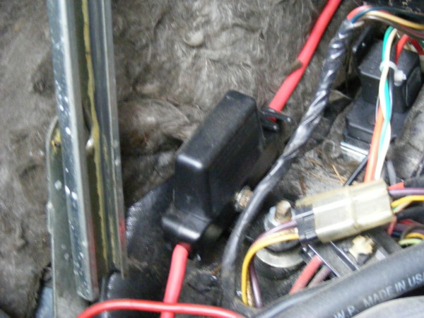

Here's another one of my durability mods: Main Fuse to battery
Corvairs made prior to '67 had no fuse protection for the "big red" main power wire that spans and connects the alternator/battery/fuse panel/headlight switch/and lighter.
I add a hidden 60-amp main-fuse between the battery and regulator (EM/FC) and battery and LRPT junction block (LM)
In the case of a short anywhere in this circuit, the fuse isolates the relatively unlimited battery power from the circuit and thus prevents a meltdown or fire.

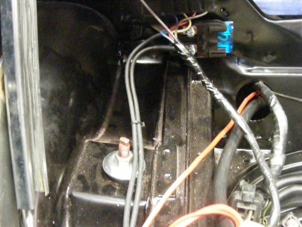

Craig --- I also install a fuse on the main power wire and on LM cars I use the fuse holder to by-pass the bulkhead connector.
As the bulkhead main power connectors corrode over time they get hot conducting amperage and then the plastic plug melts and contacts get loose and suddenly NO ELECTRICAL POWER. Great reliability LM upgrade to remove power wires from bulkhead connector and join them with a fuse.

Strategically placed, the fuse when removed could also be utilized as an "Anti Theft" device/deterrent.cnicol wrote: ↑Thu Mar 06, 2025 12:06 pm Here's another one of my durability mods: Main Fuse to battery

I have my battery in the trunk with a negative cable switch to disconnect it. I use a fuses in the engine compartment to protect the alternator and main supply to the fuse box.
A fuse on the main cable to the starter would have to be fairly stout. While starter run amperage is stated as 58 Amps plus the solenoid hold in amperage of 10.5 to 12.5 Amps, the surge amperage when the starter is first engages amperage can surge to 280 Amps!!!!!

For those of you that add protection to the main circuit DO NOT use a self resetting circuit breaker. There is a reason it blew in the first place and if the breaker keeps on resetting it's self that you could cause a fire. Always use a fuse of the correct size.
The big red #10 wire is really only rated for 30A but will take 40A for a while. I never put more than a 50A fuse in line there.

Good advice, but manually reset circuit breakers are O.K. Any thermal fuse will have voltage drops due to resistance as the amperage increases. There are some advanced magnetic breakers that minimize voltage loss, but the good ones are pricey!! I'll add that maximum amperage design requirements are NOT to protect devices, but to PREVENT FIRES.vairmech wrote: ↑Sat Mar 08, 2025 7:51 am For those of you that add protection to the main circuit DO NOT use a self resetting circuit breaker. There is a reason it blew in the first place and if the breaker keeps on resetting it's self that you could cause a fire. Always use a fuse of the correct size.
Wire amperage ratings are complicated and why you see different amperage numbers for the same wire size. The critical maximum amperage is were the insulation starts to fail (melt or catch on fire!!!!!). A lower amperage rating is calculated on voltage loss per length and that depends on if the wire is solid or multi-strand. One reason it is difficult to get the full alternator output up at the headlamps is due to the LOOONG wire from the engine up to the headlamp switch and out to the the headlamps. Some run a second 10 gauge wire from the engine compartment (alternator/battery) up to headlamp relays controlled by the headlight and dimmer switches. NOTE: In a Corvair anything over 30 Amps over 12 feet with a 10 gauge wire will result in a voltage drop (loss) that is considered excessive by some guidelines (older cars are notorious for being designed with wide voltage tolerances).
ANYWAY ------ Yes a 50 Amp fuse on the supply wire is a good choice with a 10 gauge wire. Better yet, if you are running a lot of electrical loads and a 63 Amp 10SI alternator, then install a second 10 gauge wire up to an upgraded fuse box. Calling Craig Nicol!!!
On my cars the A/C compressor and fans run off relays fused in the engine compartment (with an additional 10 gauge wire off the battery/alternator junction). The battery is up front in the trunk and the headlamp power for the relays comes off the battery and is fused separately. That way I was able to keep the stock fuse box under the dash (it is new with a new stock wiring harness). I'm not saying that is the best way, just another way of optimizing the electrical system.

Definitely concur: Battery main fuse should NOT be a self resetting circuit breaker.
