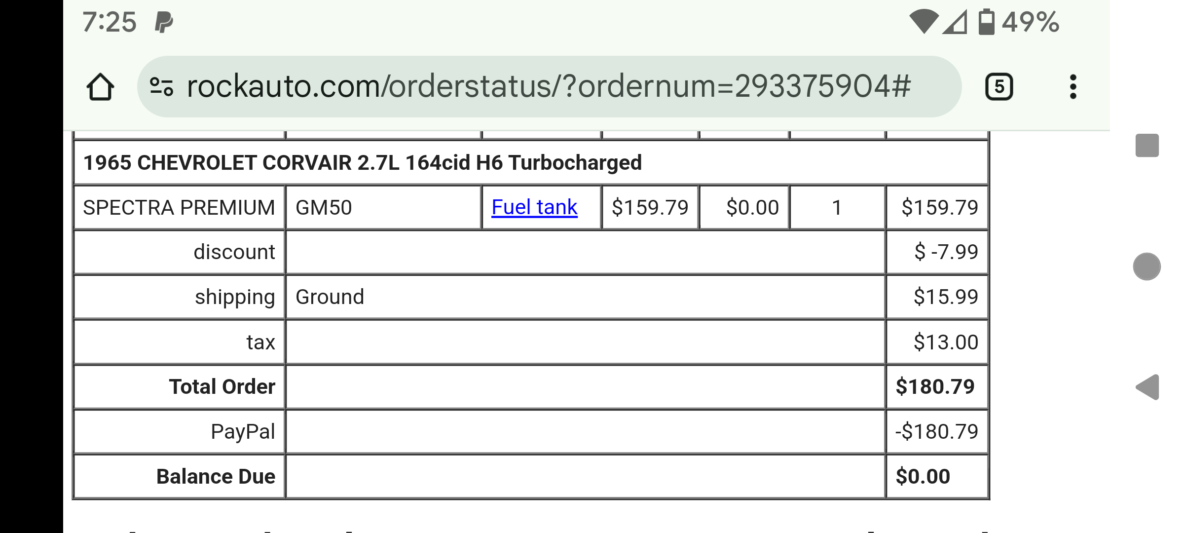

So I have a tank on order from rockauto. The shipping option they gave was surprisingly cheap, plus the discount code made it a great price, see below

Good delivered price on a new tank.

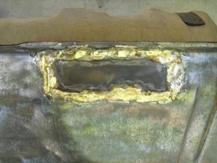

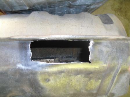

I got a hole punched in a good gas tank and I took it out and filled it with soap and water for a day to get the gas fumes out and then brazed a patch over the hole. I use the brazing to patch pin holes as well, just clean the tank out really well to eliminate the fumes before putting a torch to it!
Did this in 2009 and still no leaks.

Another added safety item if going to flame weld/braze a gas tank is after cleaning well, position the tank so you can fill it with water up close to the weld/braze area, so the air space for fumes is small. Then even if fumes, they just poof without drama. I did this when cutting tops out of 5 gallon thinner cans with a cutting torch to uses as open top cans (trash, wash buckets, etc.)

As to the gas tank shipping $15.99! How do they do it??? About 6 months ago I bought carb gaskets weighing just a few ounces and the cost was $22 to go 90 miles by regular USPS. Glad the tank shipping was reasonable for you.
