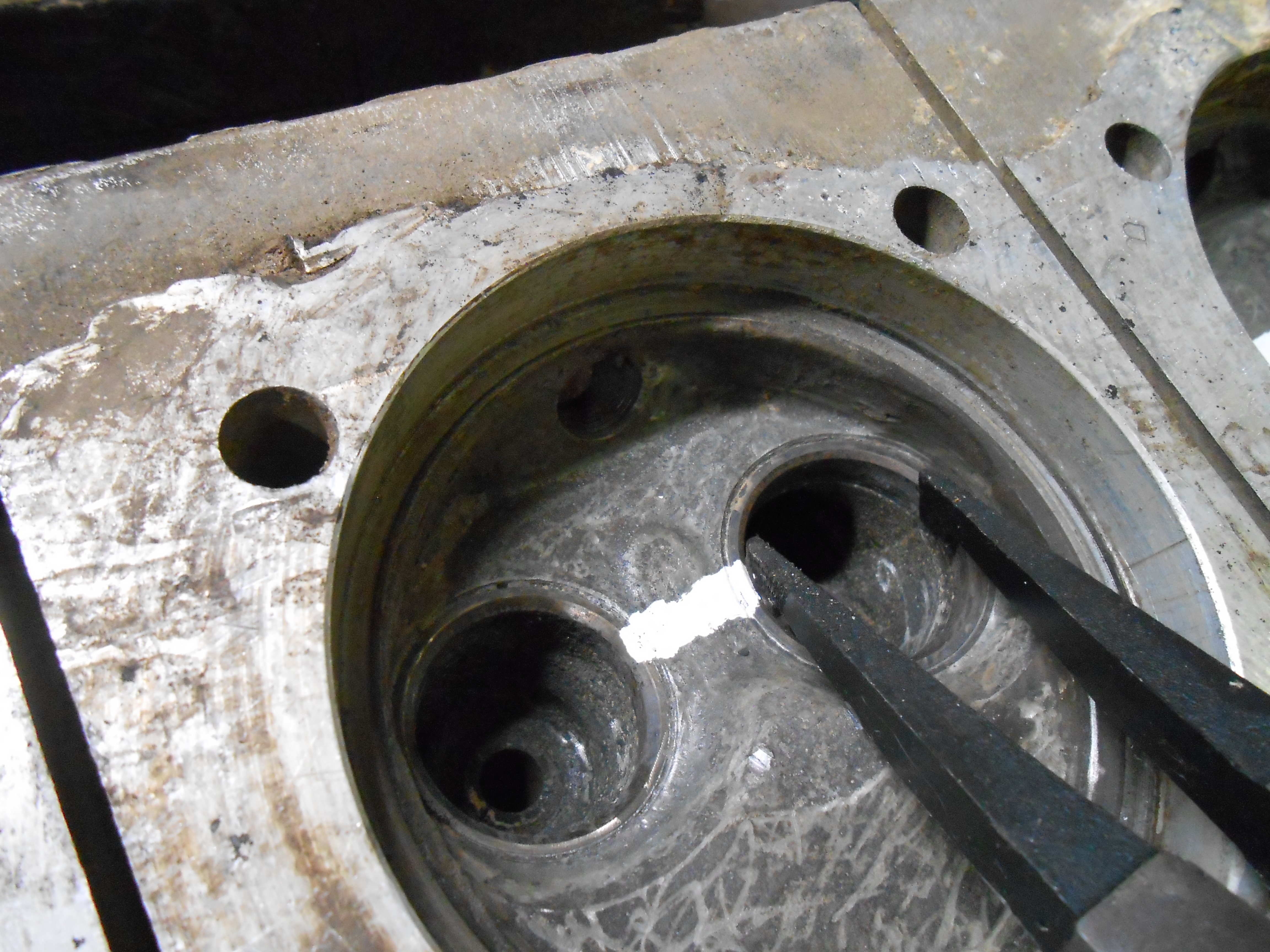

I've always been much chagrined that it was hard to know by looking if a valve seat was ready to come out. Sometimes you can see some erosion of the aluminum but not usually. I was much intrigued by Tom Keosabian's method of heating the head in the oven to check for loose valve seats and decided to give it a try.
When I first read about it I thought the method was to drop the head on the bench when taking it out of the oven. It turns out that was just one time when it was hot and he dropped it by accident. It's funny that when that happened, the two deep seats that had been replaced fell out and the four originals stayed in.
I wrote to Tom and asked how he does it and I hope I have it right. I'm happy to be corrected if I don't.
He says a loose seat will turn easier than it will fall out so he marks them before putting in the oven with correction fluid. He says if the seat moves you will see a crack in the "paint".

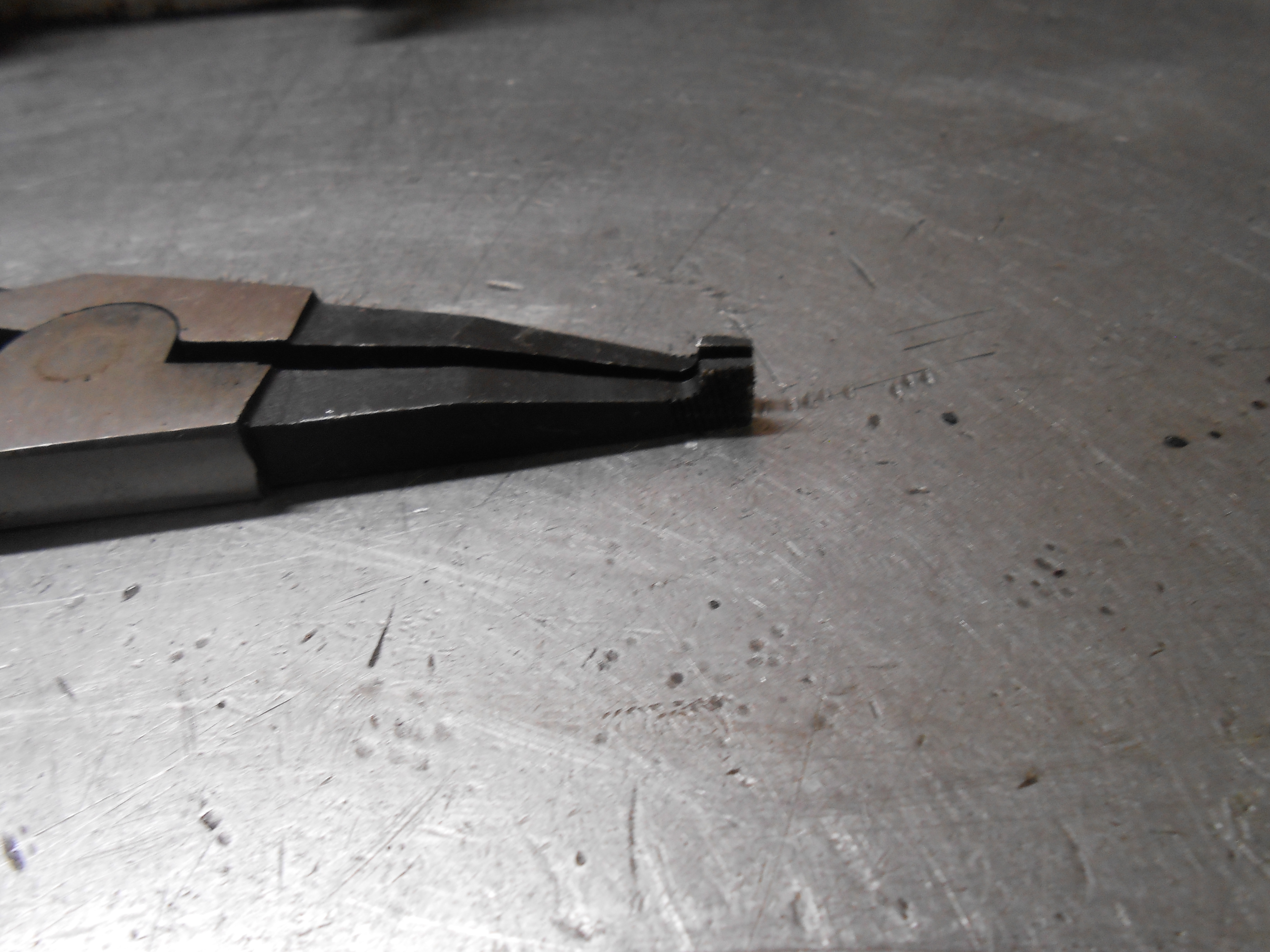

I purchased a Leontools heavy duty lock ring pliers on Ebay for the job. I'm using the 11" but I bought a set of two with a 8" as well since it was close to the same price. I had two of these tools before for internal clips in transmissions but they were not as heavy duty.
I looked for a while to find an old LP cabin size oven. I waited for cooler weather to bake my first pair. I'm glad I didn't wait for cold weather because there was a fair amount of smoke so I had to open the doors to ventilate. I didn't go hog wild with cleaning or deflash in case they failed the test.
Both of the heads I did today passed the test. I suppose I'll know more when I get one to fail.
I set the oven to 450 and put the first head in without preheating. It took about 45 minutes for the oven to get to temperature and I left it in there another 45 minutes. When I did the second head it got to 450 in a lot shorter time, maybe 15 minutes and I left it in there for an hour maybe. I bought an oven thermometer that hangs from the metal rack to monitor the temperature.
When I took a head out with leather gloves I did drop it on the bench to see if a seat would fall out before trying to rotate the seats with the pliers. After trying them once I sprayed brake cleaner on the seats to try and cool them more rapidly and tried them again. Maybe a thin stream of water would be a better choice. Maybe this extra step isn't necessary.
I'm sure some folks will think this is folly. They will say deep seats with a .007 or more interference is the only way to go. At the very least testing the seats is better than nothing. I asked on the other thread what folks are typically paying for deep seats and got no reply. I've had deep seats done and it's a good thing as long as you've got someone who can do it right. Internal Lock Ring Pliers 11" Lock Ring Pliers and Correction Fluid with brush Trying to turn the seat Line applied before baking After baking and testing

I was reading through a reply I got from Tom where he said 450 should be enough but he thought a few hours at that temperature. I probably went an hour. I've always figured an aluminum part gets to a consistent temperature throughout fairly easily.
I can certainly leave the next pair of heads in longer. I have either a 63 turbo or 140 to do next.
