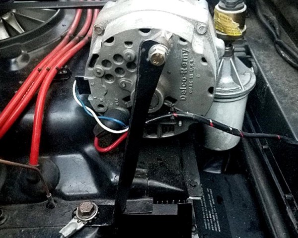

These photos of the mounting will probably help also
Next time, I will cut red lead back and install a new ring terminal. Just to get rid of the sharp bend.

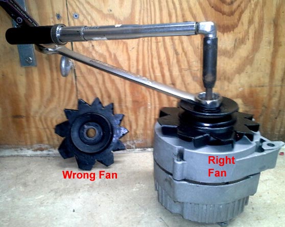

I am glad you find the instructions useful. Procedure has done its job of making the alternator model changeover procedure easier and less daunting to anyone attempting it.
Using an electric or air impact wrench to get the nut off is the recommended tool. I usually slip ratchet straps under the fan. Then Donna lifts the alternator up slightly, so it can drop on its weight, when fan comes loose. I pull up on the straps, while gently tapping the shaft with a plastic mallet. Usually it is 2 or 3 taps and the fan is off. Doing the same method while holding straps and letting alternator drop about inch onto a thick foam block can be the one person method.
The photo shows what I use to torque the nut back on. You have to have a torque wrench capable of CCW torqueing.
These are the Delco instructions for the nut's torque value. You will get comments that using the impact wrench to put the nut back on will work. I like knowing what the actual torque is when installing the nut. This is a high torque value to apply.
Delco specifies a torque for a reason.
