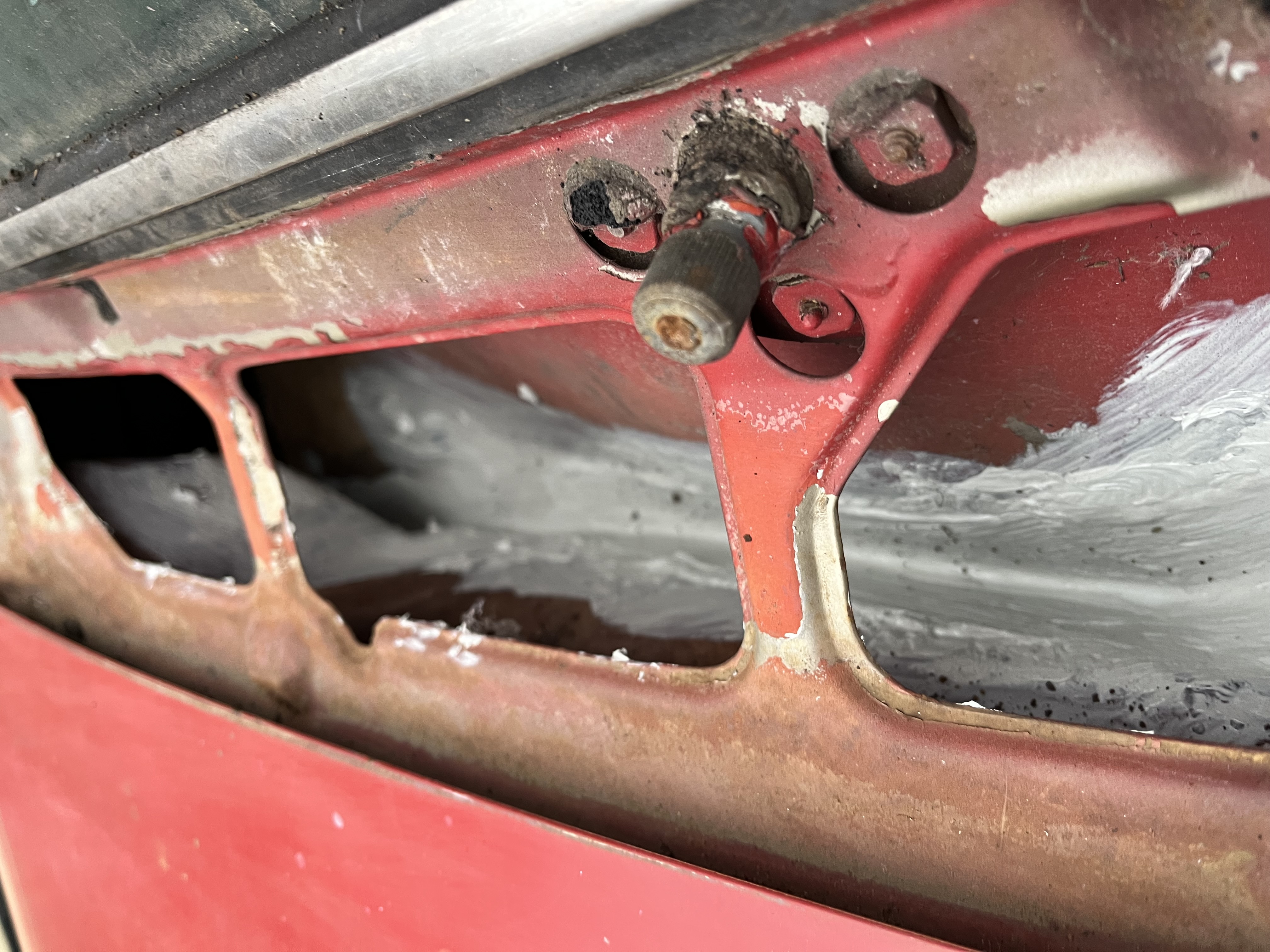

Hi all HNY been a while, I’ve used panel seal after removing old that was flaking under the window wiper to bulkhead grill seems to be fine now :pray:
Panel seal
Panel seal
Panel seal
Panel seal
Getting there slowly obviously rains nearly every day here or so it seems.
