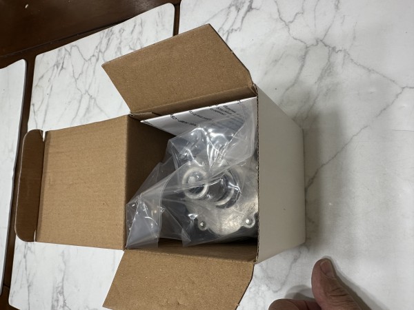

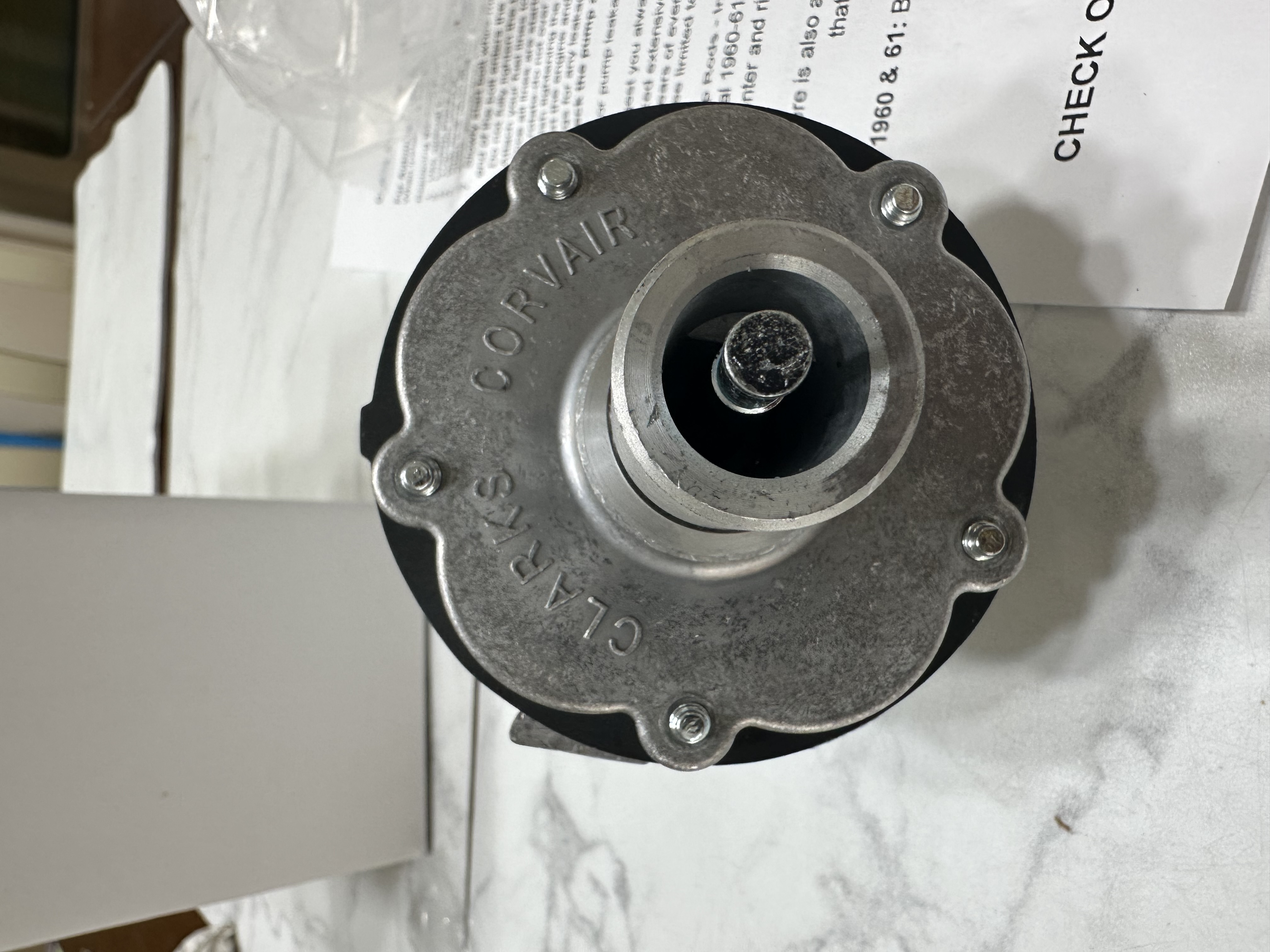

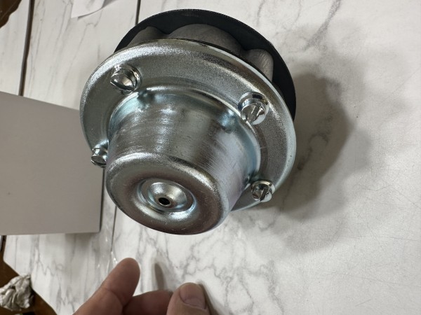

I got my Clark’s fuel pump today!!

That looks good, Bill! Mine was "delivered" by Fed Ex, of course I have no idea where the package is, driver noted left by driveway because of my gate. I have NO GATE! Neither do any close neighbors here in the country. I have a "case" open now, we shall see. They (Fed Ex) never found the coffee order they lost several months ago, and the vendor refunded my money. I wonder if they got money from Fed Ex? I hope Clark's is not on the hook for Fed Ex losing this order. I would like to have my fuel pump (and the other $200 of stuff in the box too).

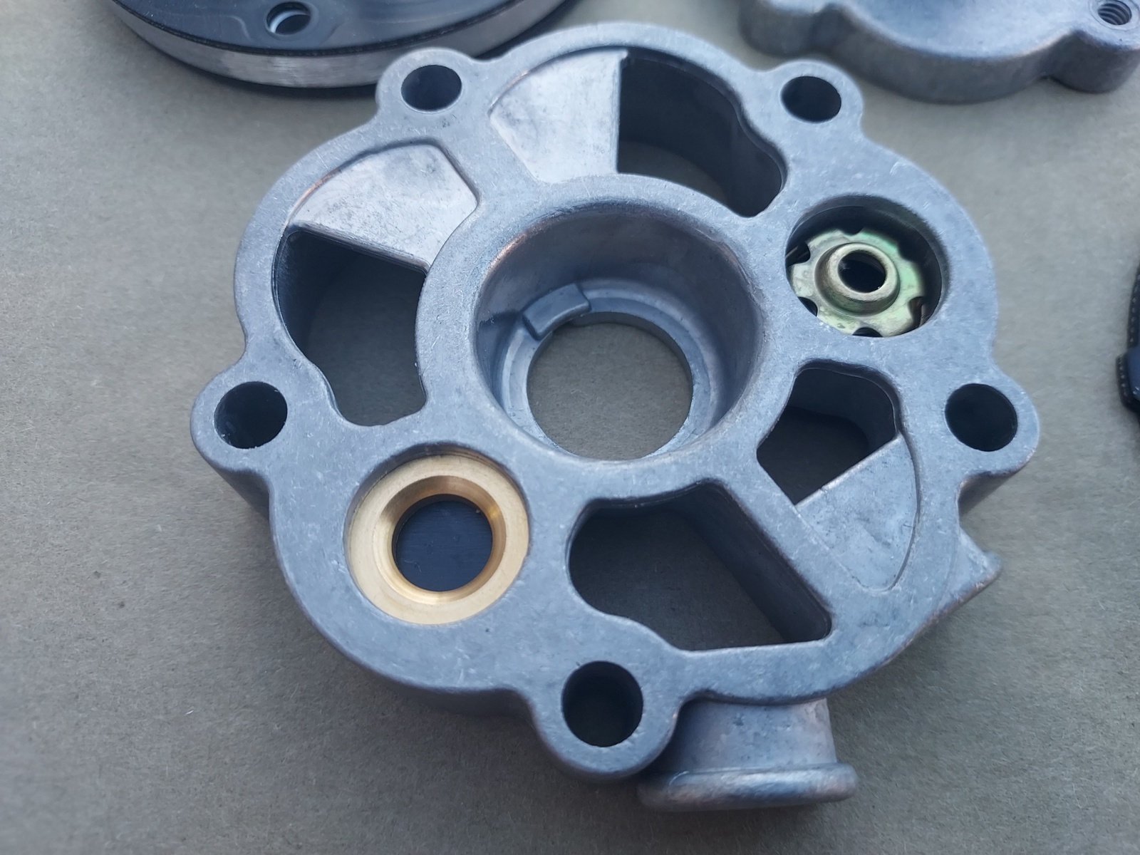

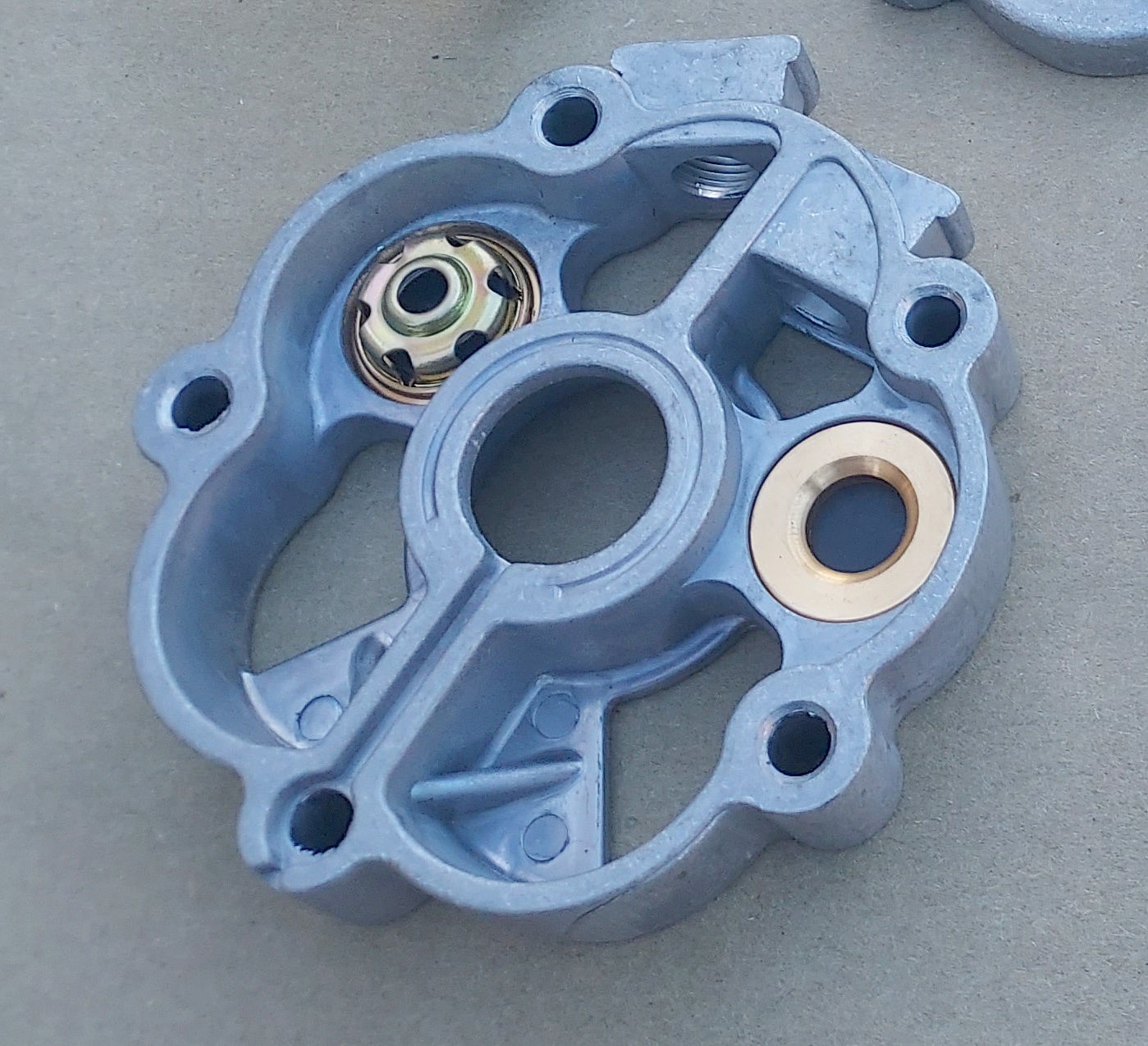

Interesting. Based on the photos, the “stem” and the base appear to be separate pieces. Maybe that is just this lighting.

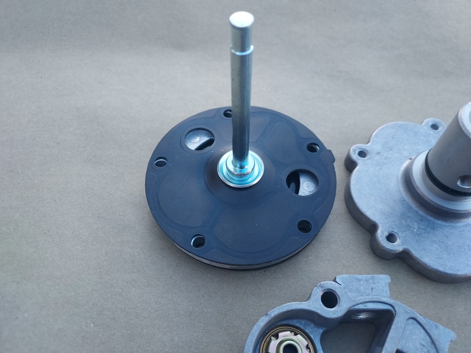

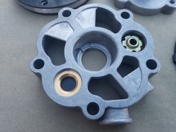

Here's my two cents, some photos and a how-to on voiding the warranty.
The pump looks to be of far better quality than the China pumps and all pieces fit well with no alignment issues. One person here mentioned that the pump base appears to be from two parts but it is one casting. Where the machined and non-machined surfaces touch looks like two halves were joined but that is not the case.
I have to be a little concerned about the check valves not being staked in place but I'm sure Clarks knows about past issues with check valves popping loose on other brands and assume they would be confident in this new design. The rubber flap disks used on the check valves does not thrill me but they sure seal perfectly, holding either pressure of vacuum for a long time during dry bench tests. I much prefer the hard phenolic discs for long-term reliability.
The 1/8" NPT port threads are clean and not threaded too deeply. The base rubber gasket and center diagram discs are supple and fiber-reinforced as they must be to survive. I have not measured the spring force or coil spring diameter yet but the height is about 1/8" less than most other pump springs I have around. I'll be testing the actual pump pressure under running conditions later today. I'll test both initial cold and hot running pressures.
Fuel here is E10 but it will of course take time to see how the rubber holds up to hot fuel after many months. I'm debating running this on a car or on a test rig. I can run the pump 24/7 at about 1700 RPM on my test rig for weeks at a time which would equal years of use on my Corvairs.
All signs so far are that this will be a good pump and far better than the junk being sold the last few years (which all originate from a single source in China under 4-5 various rebranded names).
I like e-pumps but mechanical pumps have a few places in my fleet too.

WOW! An internal look see.
Thank you.
