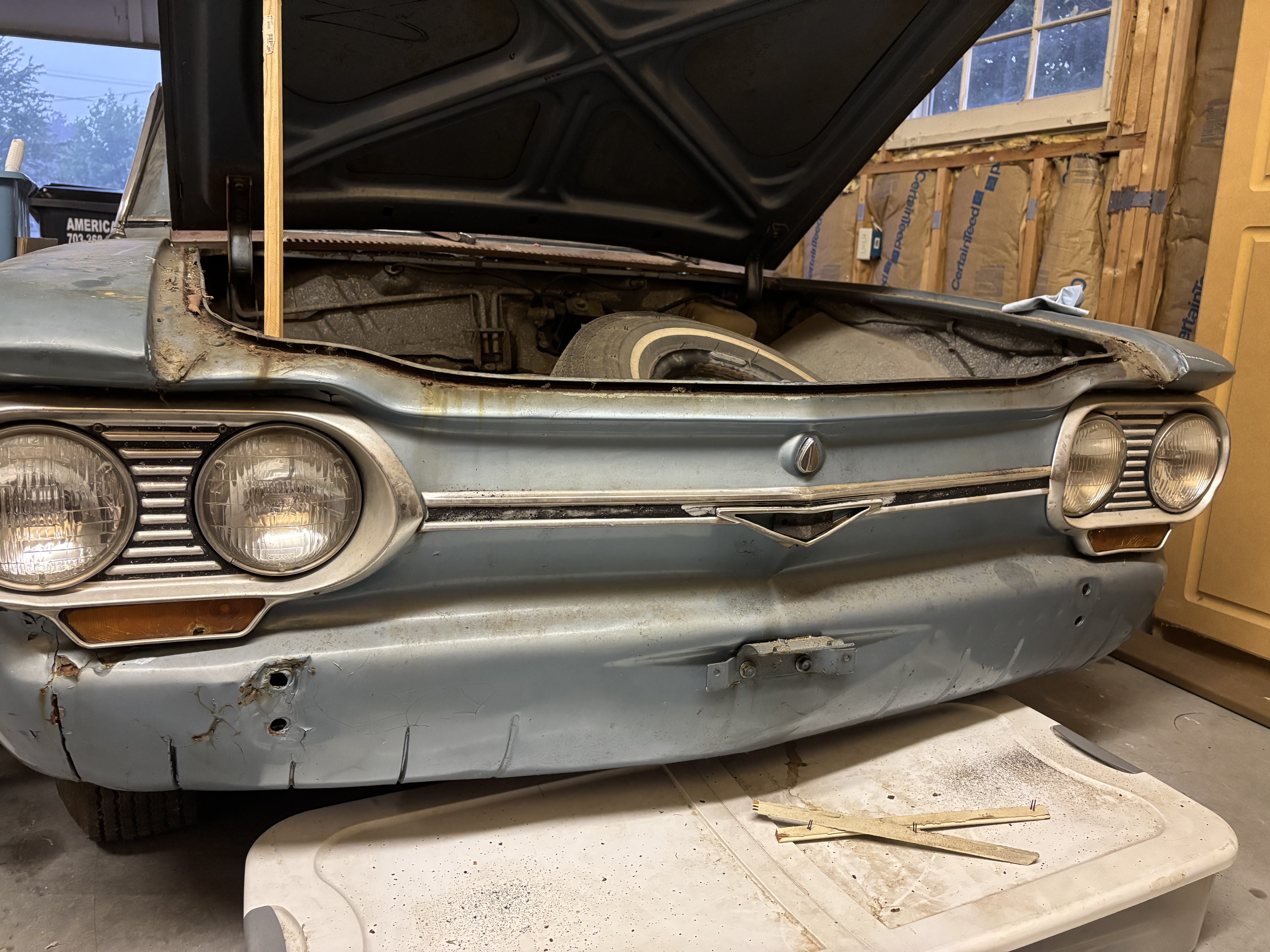

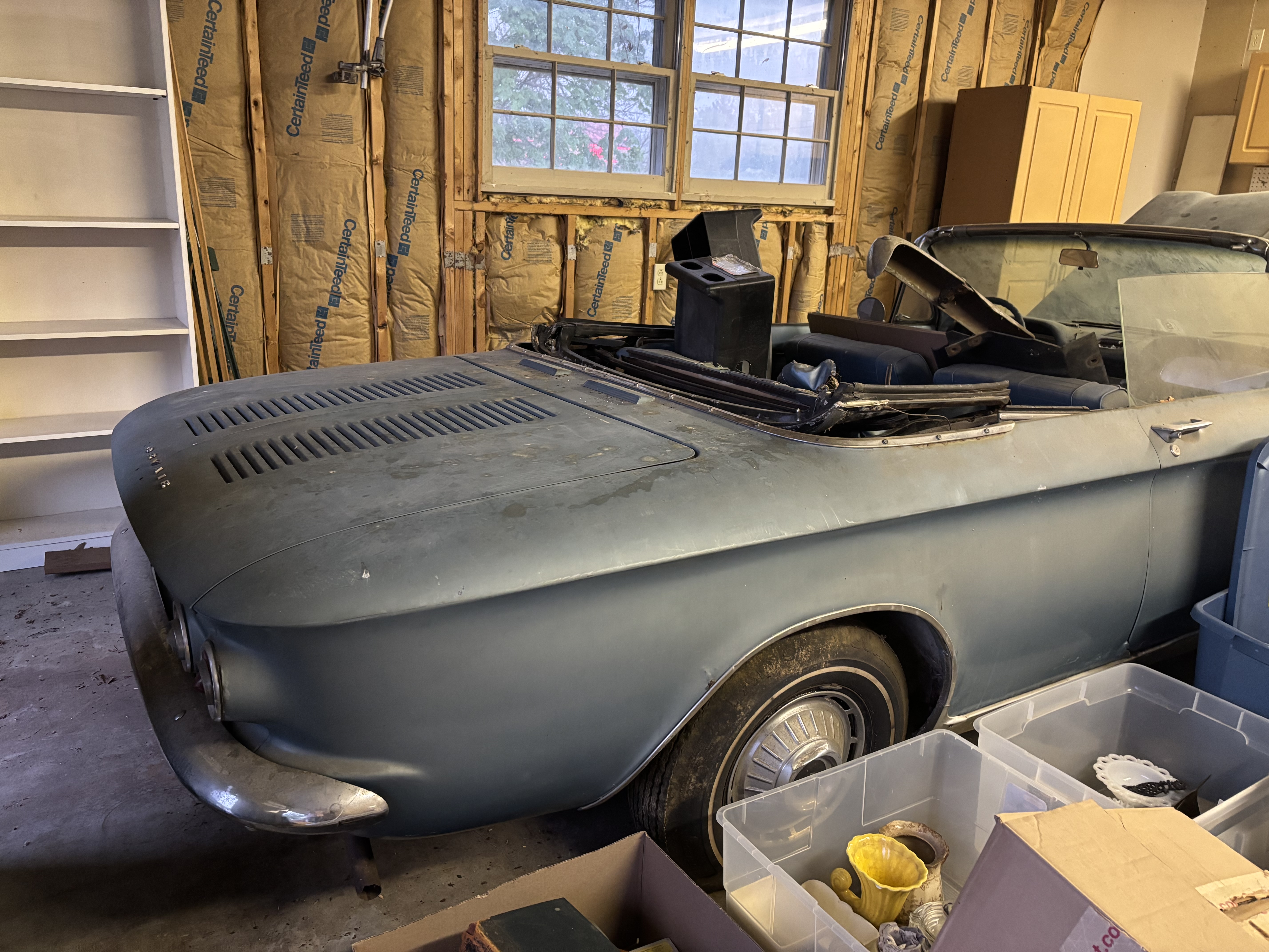

I just purchased my dad’s 1964 Corvair Monza Convertible, Automatic from his estate.
It hasn’t been on the road since 1987.
I spent my younger years working on it with him, as my family says, I was my dad’s son (I am female).
It was garage kept, but in really rough shape. I am a novice in restoring a car, but this is going to be a family project and several close friends that are mechanic's..

I am in Winchester, as was my dad before he passed. I can’t wait to bring this beauty back to her glory, that was always my dad’s wish. I can’t make it this weekend, but maybe in the future I’ll be able to make one. I have just started this adventure and it’s scary but I know it will be worth it.
Thanks for reaching out. Temple

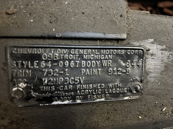

I was questioning the two small air filters (as seen on 1961 to 1963 models) instead of the typical one big center air filter, so I looked at the body tag. Yep, second week of September production (the 09B at the top), that's early!
Color Code 912 is Silver Blue Poly, looks like it still is that color.

Thank you and everyone for your response and suggestions. We haven’t tried anything on this yet. We are moving “Lola” next week and the work begins. I was just pleased to get the truck open, I thought I was going to have to remove the headlight, trunk would only open about 1/2” but would not release all the way, even turning key all the way right and pushing down, last resort, WD40 did the trick. I think I found the differential dip stick in the trunk and possibly the original oil dip stick.
She is sitting on 3 flats, putting new tire on tomorrow to pull her out of the garage to get her moved.
The drivers door is broken, but I was able to finally open passenger door tonight.
I have attached a few more pics.
I am looking forward to reading this forum and getting help when I need it.

Hey that thing don't look too bad. I'll be anxious to read about how it's going.
