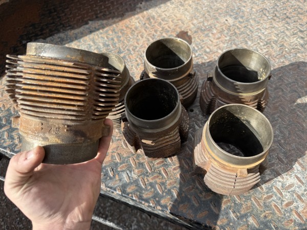

I have the engine, trans, and carbs in hand! And holy moly I have some assembly to do. I ordered manuals today, factory assembly manual as well as shop manual. Crank looks like it’s in fantastic condition. Cylinders look a little rough for wear. 5/6 pistons look clean. 1 needs a bit of corrosion clean up. Carbs are definitely going to need some love. I’m hoping to verify this engine matches this body. I’ve been told they do but not sure how to find out. Engine code is T0807ZF. Body tag… I’ll include in the picture with this post. This portion and really this entire car is still very new to me. Definitely going to be a learning experience. But as of today… I have:
Case (assembled)
New oil pump (installed)
Oil pan (installed)
Cylinders
Pistons and connecting rods
Heads
New set of valves (appears intake) with new guides
Piston rings
A few seal kits (I’ve yet to look and see what they are for, looks like a cylinder/head kit)
Carburetors
Torque converter
Starter
Transmission
Distributor
Body and seats.
Case (assembled)
Oil pan (installed)
Cylinders
Heads
Piston rings
Carburetors
Torque converter
Starter
Transmission
Distributor
Body and seats.
-Evan Schantini

- Posts: 840
Re: 1962 Chevy Corvair Monza 900
ZF could be a 62 102 HP PG but it could be some other years as well.
What's the head numbers located on the end? A lot of 102s seem to have 3813516.
What's your distributor number? Usually on the outside of the distributor body clockwise from the vacuum advance bracket. 62 102 PG may have 1110272.
For crankcase venting does it have a road draft tube going down or a tube for PCV going up?
Perhaps we already went through this stuff, I didn't read the whole thread again.
- ESchantini
- Posts: 14
- Joined: Tue Jul 09, 2024 5:19 pm
I’ll attach some pictures of the block and engine components I have on this post.
-Evan Schantini
