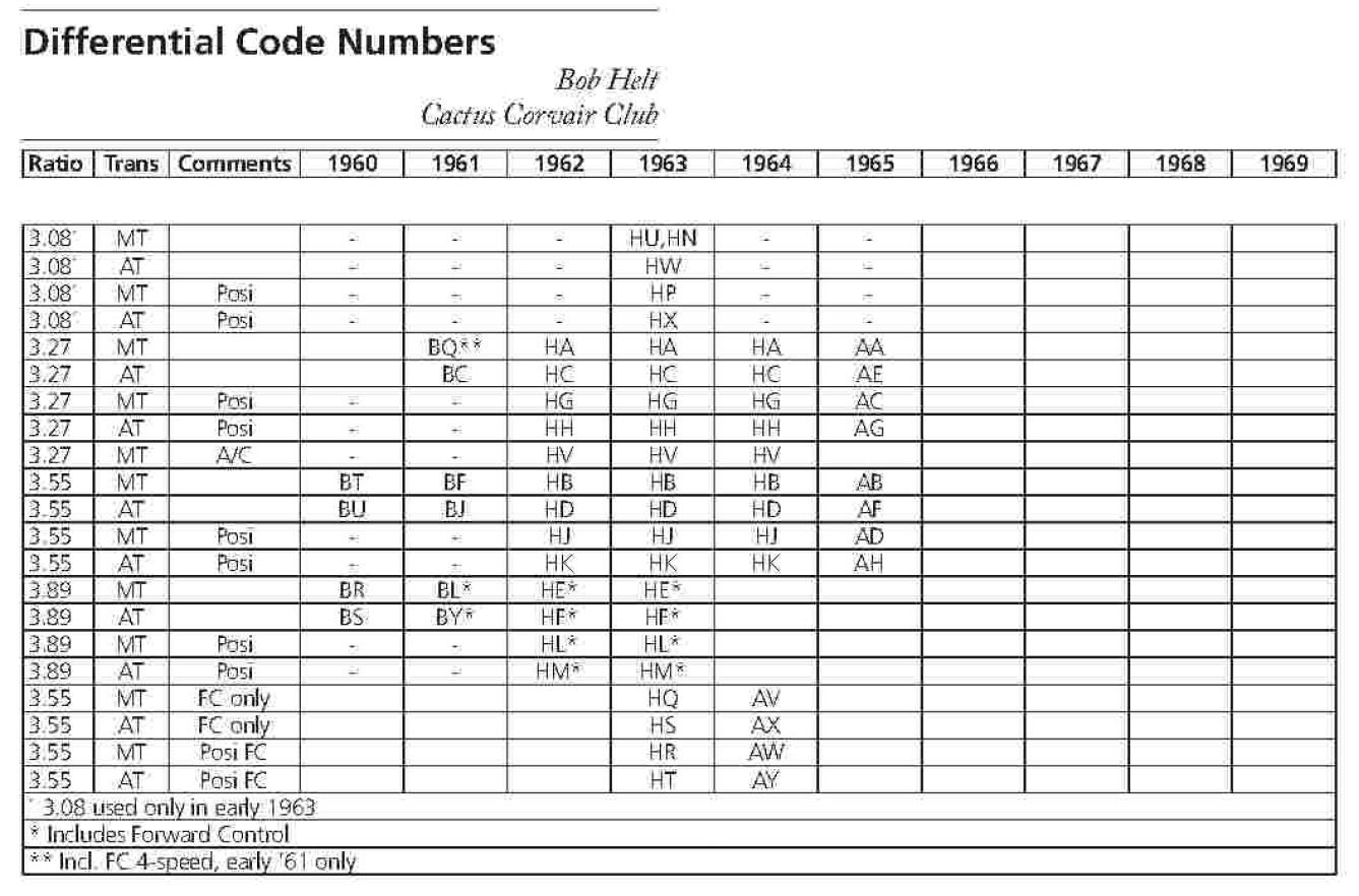

They are not common. There are 3 stock gearing options(open or posi), 3.27, 3.55, and 3.89. There are alos some after market options like 4.11.

So are diffs compatible between the older straight axle and IRS transmissions? Not that I plan to build a trans anytime soon, but if I were, I'd probably think about putting a 3.89 in if it would fit....
Re: Limited slip diff's and gearing options
No. The swing axle and IRS axles will only work with their matching diffs. If you note from the chart above 3.89 was only available stock in the earlier swing axle transaxles.

Yep, I noted it. That's why I asked the question.

3.08 also but rare - 1 yr only.terribleted wrote:There are 3 stock gearing options(open or posi), 3.27, 3.55, and 3.89.
