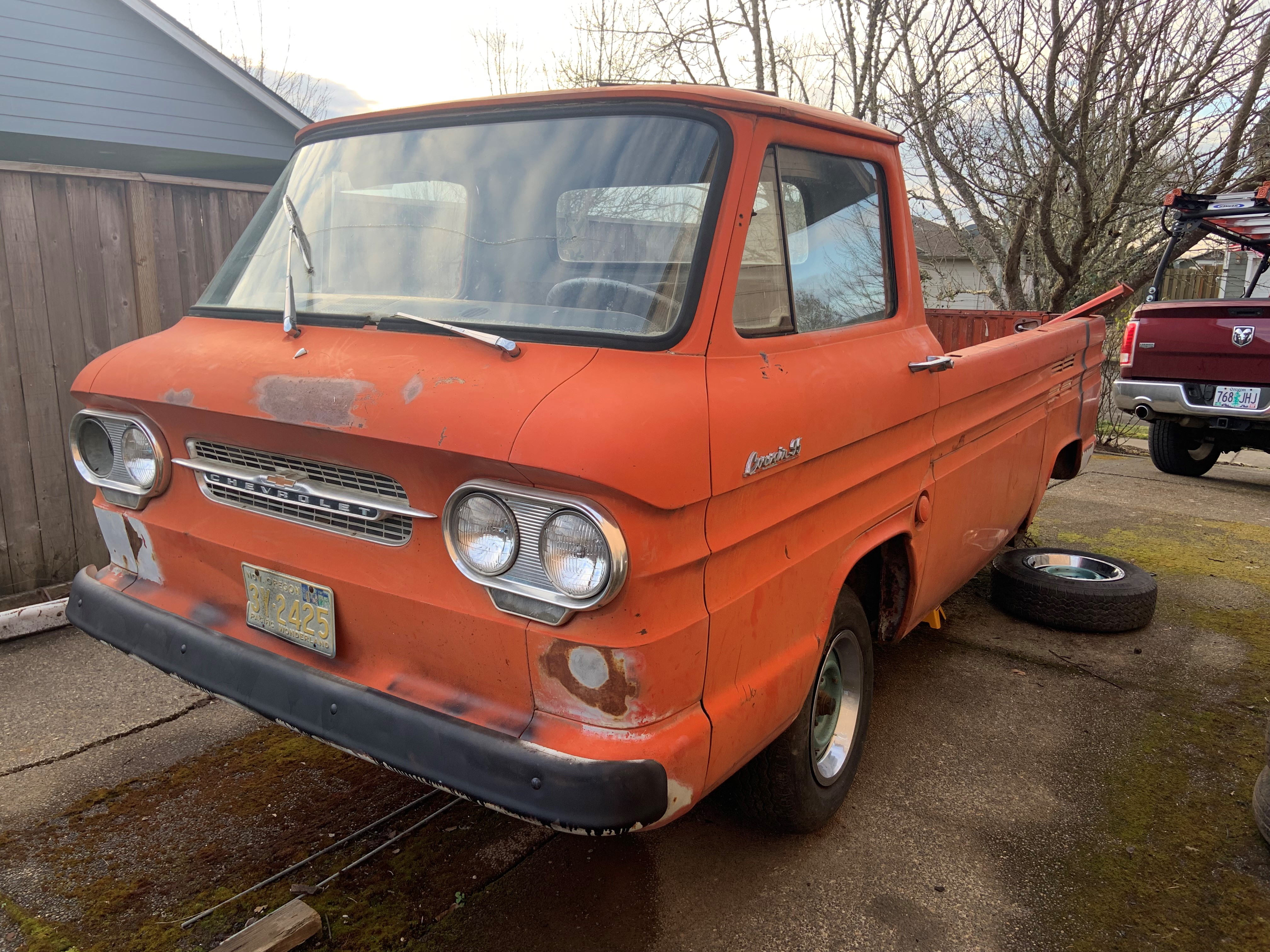

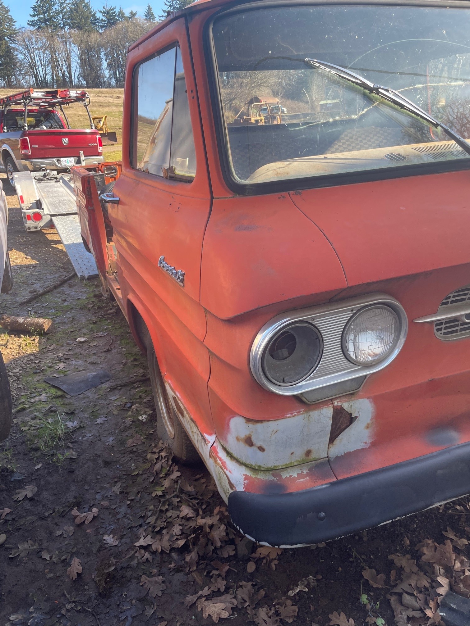

New purchase, 1961 Rampside. Hasn't been registered since 1968. Was a forestry truck in its youth. I plan on putting a 140 in her and putting her back on the road.

It looks real solid. A great start into the FC world. Keep us posted on your progress.

It also looks like it was Omaha Orange like the Clarks truck, but it was actually born as Cardinal Red. Which am have been told fades to a orange.
