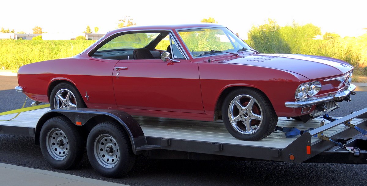

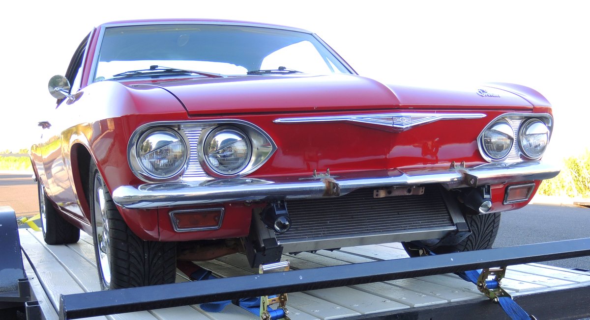

I'm sure you will make it all look professional but changing the looks of the front of a late model pains me. That is why I have put up with my mid-mount radiator for almost 10 years.
The last 455 Corvair I got still needs the front radiator install cleaned up. Photos below shown what NOT to do. ::-):

Dave, I'm not sure what to say .......... but I feel sure that has been said about my car as well. I'm sure you will get that fixed quickly
