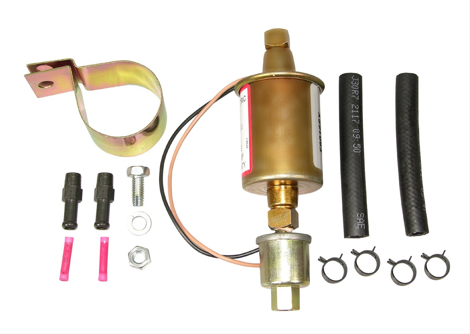

Those square box diaphragm pumps are noisy as hell. I ran one of those once and replaced it shortly thereafter. The Airtex E8016S has been my choice for years now. Rotating vane type pump makes a hum rather than sounding like a midget slapping the bottom of the car with a hammer:) I have used these and an intank unit that David Herrin supplied when he was operating The Source years ago ( these were really nice and almost silent). The E8016S makes 3-4.5PSI and is perfect for the Corvair with no additional regulators or similar required. For those who prefer to use and oil pressure shutoff switch I recommend a toggle switch to bypass this safety switch and power the pump when there is no oil pressure as after sitting crank to start times can be extended due to no fuel in the carbs.

terribleted wrote:The Airtex E8016S has been my choice for years now...
https://www.summitracing.com/parts/atx-e8016s
Issues with Airtex E8016S electric fuel pumps
http://corvaircenter.com/phorum/read.php?1,819416
The Facet cube seems to have a good reputation for reliability. Perhaps this Facet pump would be reliable, a good fuel pressure for Corvair Rochester HV and Carter YH carburetors, and quiet too!
