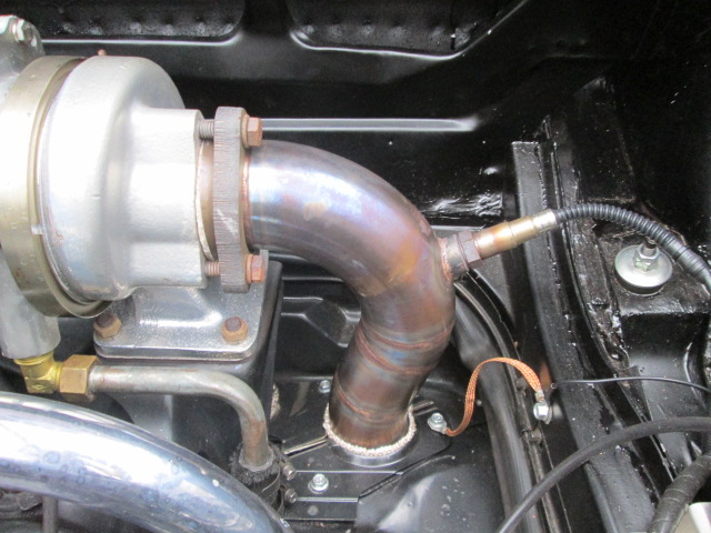

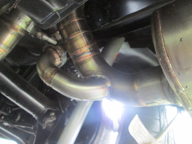

Some more exhaust pictures for you.

Lee can you give some details on your exhaust, size of tubing, where you got the flanges at, exhaust logs, etc. The pipe and fittings aren't going to be to much of a problem for me being a plumber, we've probably got most of that stuff in our shop, have to do some digging. Jeff

My heads have been modified and have 140 exhaust tubes and I use stock 140 exhaust manifolds. The cross over I believe is 1 5/8" and the inlet to the turbo is 2". The outlet/down pipe is 2.5" inch. We made the flanges where the donut gaskets that seal to the front of the manifold. My buddy has a steel mandrel to swage pipe with so that was done in a press and it was 2 pieces (an outer portion that was swaged and a straight inner portion that the donut gasket fits over).
The V band flanges came from Ebay. The cross over has a slip joint in the middle to allow it to expand and contract. The inlet pipe below the turbo has one as well so that if I need to work on the engine I can unbolt the turbo and pull the flange with part of the inlet pipe up and off without spending an hour trying to separate them under the car. The flange that the turbo mounts to was cut off a rusted out OEM inlet pipe. I ended up setting it up in the mill and working the weld joint off with an end mill and then belt sanded both sides flat again.
The triangular outlet flange is stainless and I made that from a rough blank. The flange for the donut gasket at the turbo to outlet pipe was made the same way as the ones at the cross over.

Nice job on the exhaust. How does the expansion joint's not leak with out some kind of a clamp? Jeff

Thank's Jeff. I can't take credit for all of it. My friend Keith did the cutting and welding. I did the smaller stuff and had some of the ideas.
The slip joints are tight when cold. When engine gets hot the inner pipe expands intake the outer pipe. No leaks. Fabricators do the same thing with the slip on collectors on a lot of V8 headers. The only clamp that I have is on the inlet pipe and where the muffler slips on.
