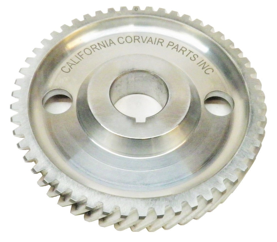

Yes I remember seeing that gear at Palm Springs as he was very excited to show it to me.
It's from the early 2000's (old phone number).
I was puzzled why it had been drilled and tapped with two set screws onto the cam.
That made me think it was a very high RPM application but he insisted it was not.
Mine are made from high quality 6061 T6 billet aluminum and manufactured by an aircraft gear company
here in the US.
Approximately 600+ gears later it's good to know that's the only one of mine I've seen fail.
I ran out of stock due to a unusually large order earlier this month but more are in production now.

Jeff, since you are having them made why don't you have them put the timing mark in the correct spot?

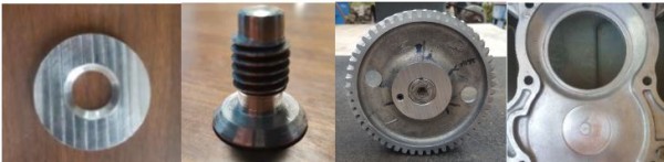

Years have shown that the set screw method works but I was skeptical without milling the holes to tap that a drill would just walk off into the soft gear metal using a drill press. In the end my son fabricated a washer for me and he notch milled the bellhousing for the washer clearance. We then drilled and tapped the cam for a tapered head, flush surface hex bolt. There is a Cummings Diesel engine that also has a press fit cam gear and there is a bolt on washer available for it https://apexdieselperformance.com/product/443/. So, the concept seems sound. Permatex 64000 is used on the washer to gear surface, red Loctite on the bolt and there is a notch on the bolt to stake the washer to. So far, so good.martyscarr wrote: ↑Mon Apr 01, 2024 9:20 pm ... As far as set screwing the gear to the cam, I always do this and think it is cheap insurance against having a failure at that connection.
