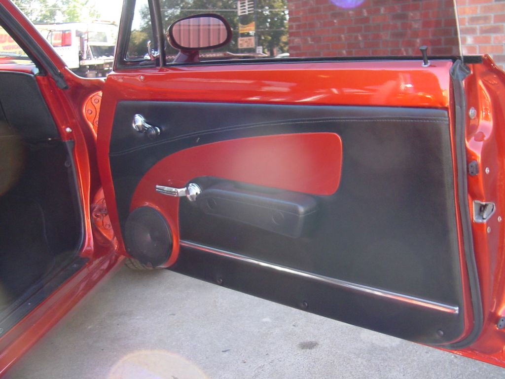

Here are a couple I made in the past:
In a 65 Coupe
In another 65 coupe Crown V8 conversion. Power windows in this one so no window crank in the way The stainless edge around the inserts and the arm rests were from a late model Ford Mustang. The stainless trim was inverted and swapped left to right to attain the angles I liked.
Construction of both sets of panels started with a sheet of luan door facing sealed with coats of exterior polyurethane. Build up from there involved varying materials including MDF, Fiberglass mat and resin, Auto Body fillers, 1/8" Masonite sheet, etc..

Nice! I like the molded speaker pods as well. Can't seem to decide if I want to sacrifice my vents for that.

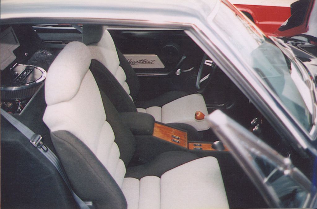

lol alright, I found an example of an EM coupe with wood panel... I dig it.
-Steve
1961 Corvair 700 Sedan (80hp 3spd Gasoline Heat)

County98 wrote:Nice! I like the molded speaker pods as well. Can't seem to decide if I want to sacrifice my vents for that.
I like my floor vents and to me they are not as good a speaker location as the doors. You can mount 6" round drivers into the doors below the window cranks with little to no modification(discounting cutting the inner door and door panel to fit the speaker). Deep magnets may require spacing out for window clearance. The molded pods were of course for visual appeal as well as to point the sound more toward the front seat passengers.
