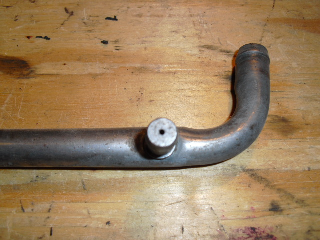

When you say "new PCV valve too"......you know these cars don't actually have a PCV valve, it's just a pinhole orifice in that metal breather tube. You don't actually have a PCV valve on this car (like from a regular engine) right? If it were my car, I would also start by plugging every single vacuum port (even the crossover) and go from there.scottydont wrote:I know it's just as it should be (new pcv valve too, and I've double checked to make sure the orientation is correct), but the best idle I've had so far was with the crankcase vent to the air cleaner plugged. To me that says its too lean at idle since it's under slight vacuum from the pcv.... but the other tests I did dont back that up.... I have to be getting something wrong... Just don't know what at this point.

Sounds like dirt in the idle circuit to me,and the PCV valve? what year is this car? some early's had an actual valve,but late's don't, I was going to tell you to remove the idle mixture screws and blow some air thru the hole to blow any dirt out,as far as balancing, I have all the tools but don't use them much any more, I seem to be able to get them balanced by ear and feel Helen Keller style and they run great,there is really not much to these things. my carbs always balance!

The engine is a '65 vintage 110. What came out was definitely not just an orifice, and the local oreilly looked up the PCV valve by year and hp and came up with an identical part to what came off of it....

Your 110 should have no valve,it should only have a piece that looks like this, can you post a pic of your PCV set up?

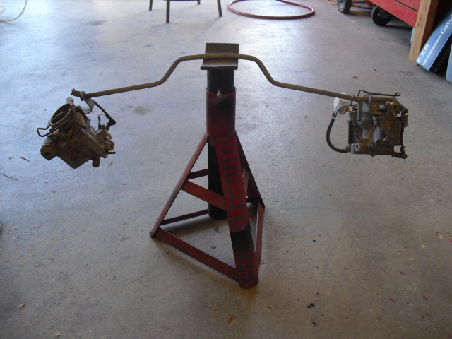

I don't use a tool to balance them either, I set them initially from a base line with the throttle linkage disconnected from both carbs and the crossover disconnected from the rod coming out of the firewall, go to baseline, then it is all about uniform adjustments from there and it seems to work.davemotohead wrote:Sounds like dirt in the idle circuit to me,and the PCV valve? what year is this car? some early's had an actual valve,but late's don't, I was going to tell you to remove the idle mixture screws and blow some air thru the hole to blow any dirt out,as far as balancing, I have all the tools but don't use them much any more, I seem to be able to get them balanced by ear and feel Helen Keller style and they run great,there is really not much to these things. my carbs always balance!

I'm at the office so cant take a photo right now, but except for the air cleaner setup (mine are stock) the breather/pcv assembly looks identical to this one right down to the location of the valve in the rubber line.http://www.google.com/imgres?imgurl=htt ... g&dur=1055 The PCV valve is a few inches from the end of the metal tube (right at the top edge of the photo).
