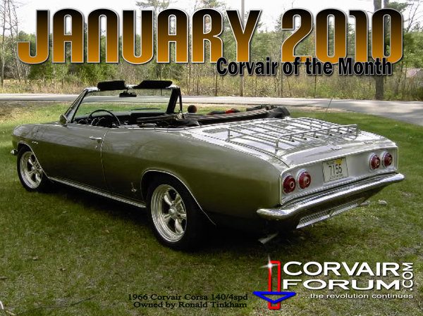

Personally, I currently have Goodyear Eagle Raised White Letter tires on my 14"x7" Chevrolet SS rims.
Front: Goodyear Eagle ST P195/70 R14
Rear: Goodyear Eagle ST P235/60 R14
I am planning on moving up to 16"x7" or 16" x 8" custom aftermarket rims with 225/55ZR16 Continental ExtremeContact DWS Blackwall tires. I had these tires on my Lexus GS460 and liked the performance.

That there is the VERY first ever Corvair of the Month car!bbodie52 wrote:![]()
Beautiful convertible! Thanks for the tire and wheel info too. Valuable hands-on experience!
