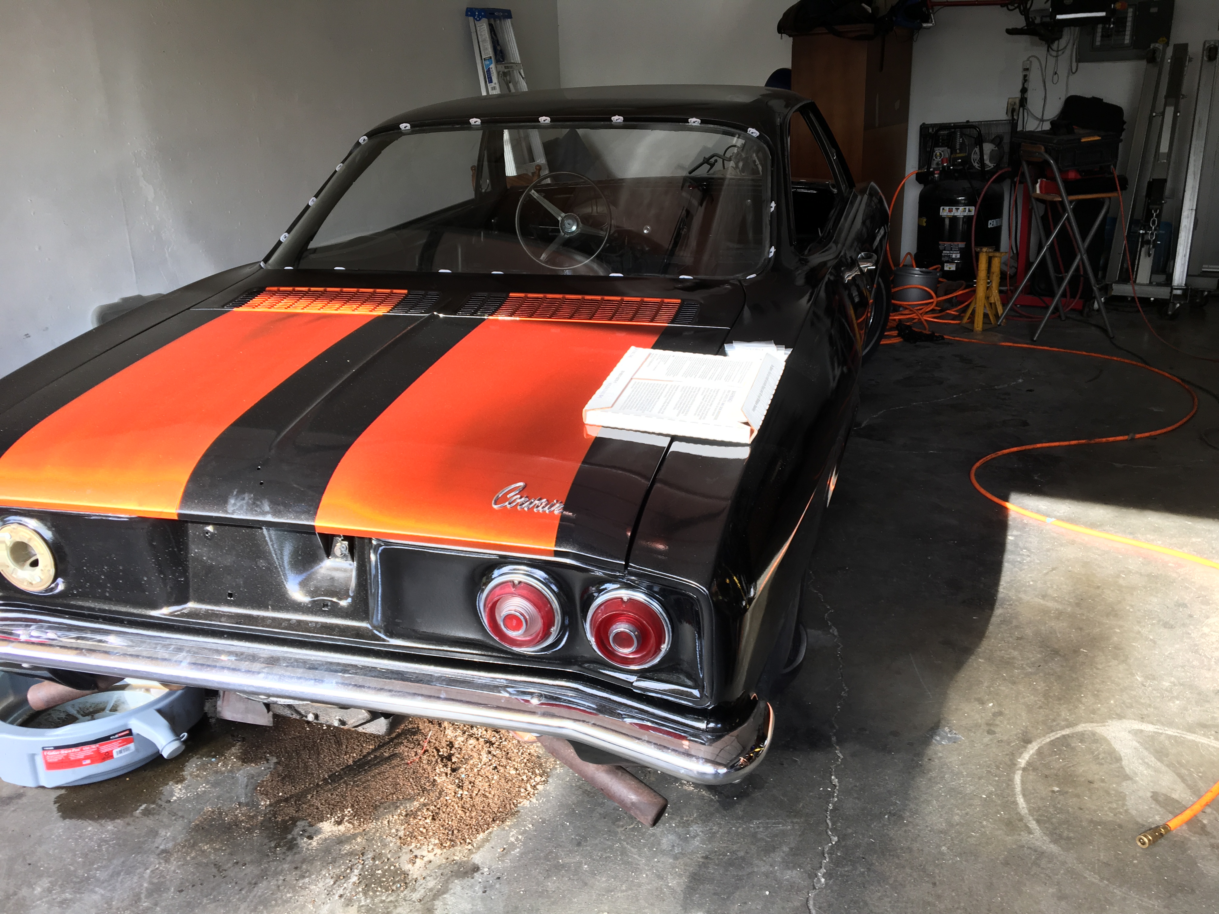

The inevitable happened.
- Gregory_Miller
- Posts: 919
Re: The inevitable happened.
Nice! No more clutch cable to break.
- Posts: 11872
This could become a popular modification! Your pictures are very helpful. If you could post a detailed list of materials, your supply sources, and perhaps a final "lessons learned" commentary to guide us along many might tackle this project for their own Corvairs.

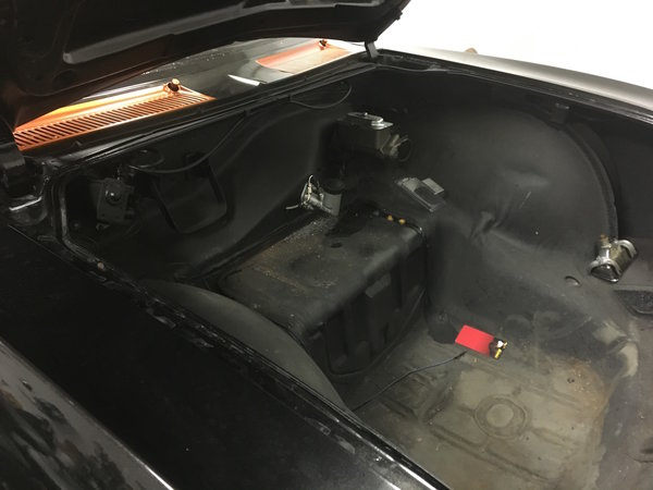

Got the clutch master cylinder in and bled, seemed like the slave cylinder wasn't pulling far enough to move the throw out bearing all the way. I think I accidentally bought one with too short of a throw, should've been about 1.5" and I ordered one with .8" no problem, just more parts to wait on. hah

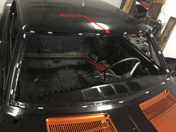

Anyway I'm installing the windows soon, and ordered all new plastic clips for the trim from clarks, everywhere I've looked you're supposed to only need 20 clips for the front and 20 clips for the back, for some reason though my front has 21 studs.... can anyone tell from my picture which one is extra? I guess I could always just order another set of clips, one of the others slightly cracked anyway so it may be good to get more. just weird though.

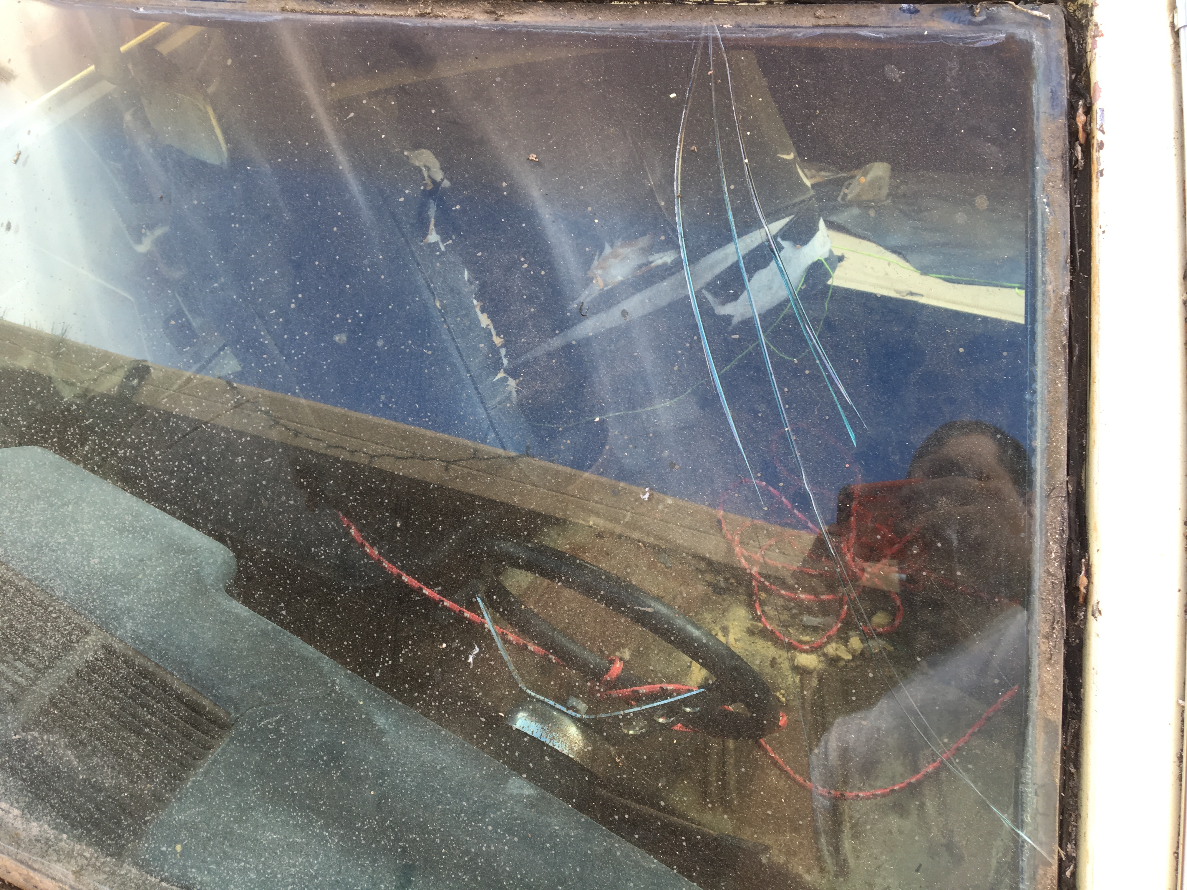

Well installed the rear window, and I was pulling the front window out of the donor car and freakin cracked it! so mad right now, very expensive mistake. Guess I'll be looking for another one.

I hate re-using old front glass in a restoration like yours. It's too much work to remove and re-install only to end up with old glass. I can find smaller glass shops around here that will sell me new windshields for under $150. I bought two last time so I always have a spare for myself or local club members in a pinch.God.favored wrote:...I was pulling the front window out of the donor car and freakin cracked it! so mad right now, very expensive mistake.

Really 150? Wow I'll have to look around I guess. I just didn't even think about trying a glass shop because I figured they wouldn't be able to get anything.azdave wrote:

Search around for windshield "DW659" Fits all LM coupes, convertibles and 4-drs.

Turns out the slave cylinder I bought was not the one I thought it was, it only had a 3/4" stroke and needs about 1 3/4" so I went ahead and purchased a new willwood cylinder and so far so good.

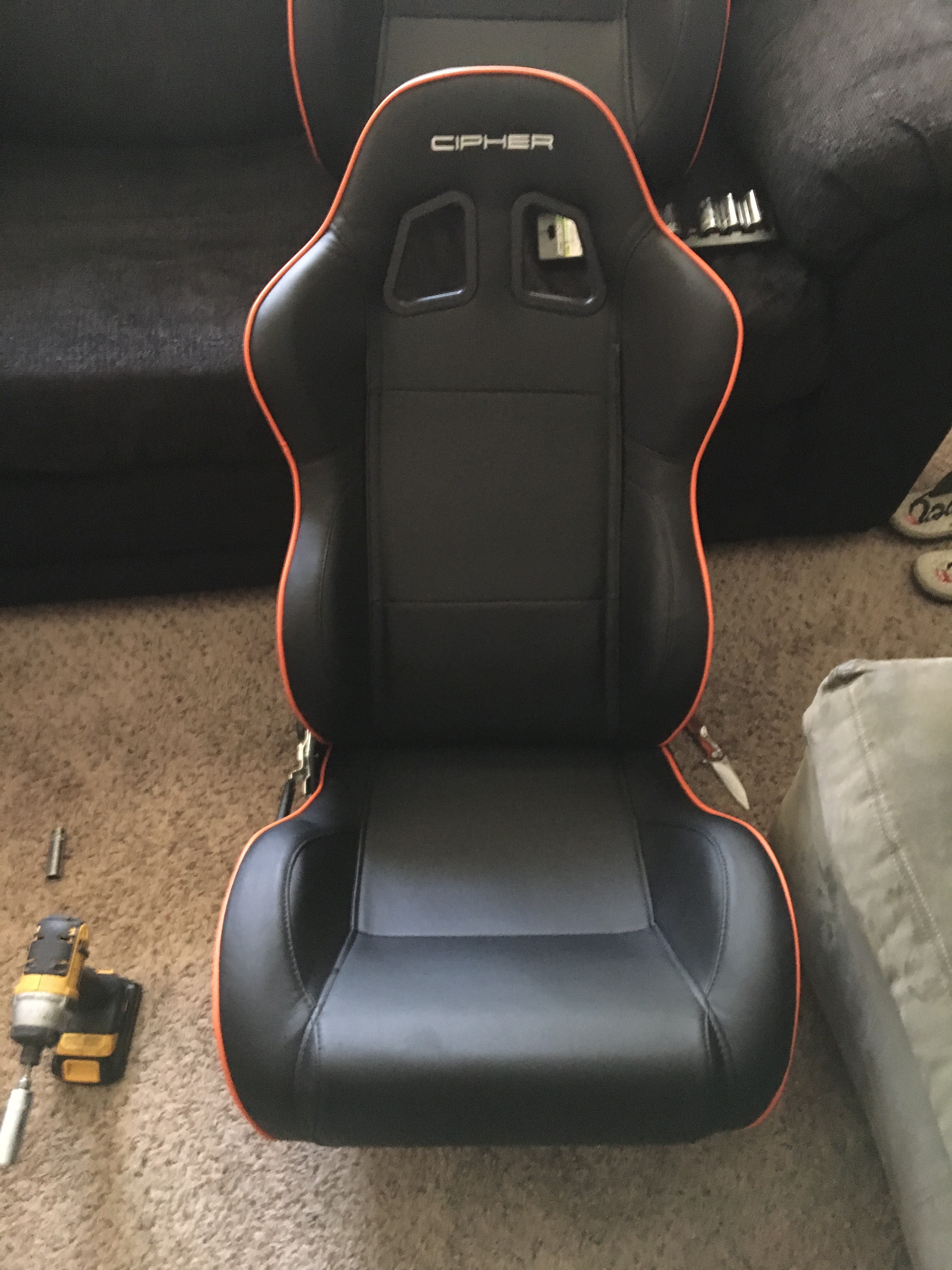

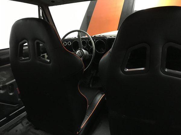

Picked up some seats. Love how they look, and for racing style buckets they're actually pretty comfortable. Installed a new holly electric fuel pump and relay, need to put the cutoff switch in the front still, already wired everything else and ran the wire for it.
