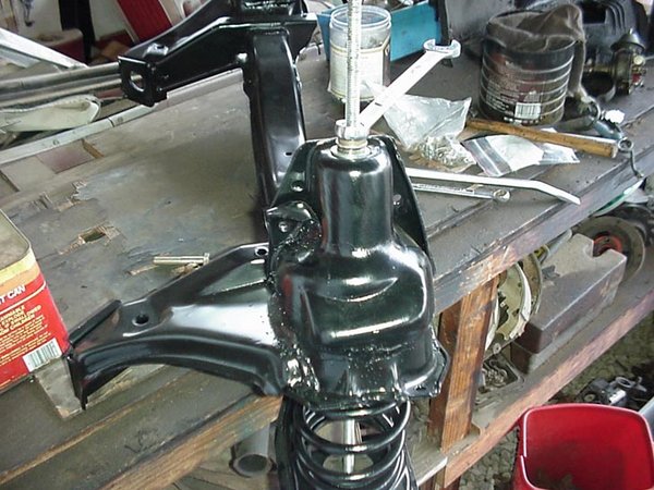

BobWitt wrote:I was talking to one of our technicians at our shop today about fabricating a spring compressor -
Many of us fab up a 7/16 all-thread rod with some washers and brackets. These pics are from Vairchet on CC.
Re: New-to-me 66 Corsa!
Dave – Is that the one that uses the shock mounting holes in the LCA? That was what I was going to Fab! I’ve seen that or another thread (Dave Motohead maybe) that I was going to copy… The tool I borrowed used the shock hole at the top, and had ‘claws’ that clamped the lower spring directly – worked like a charm and took no time to fab…

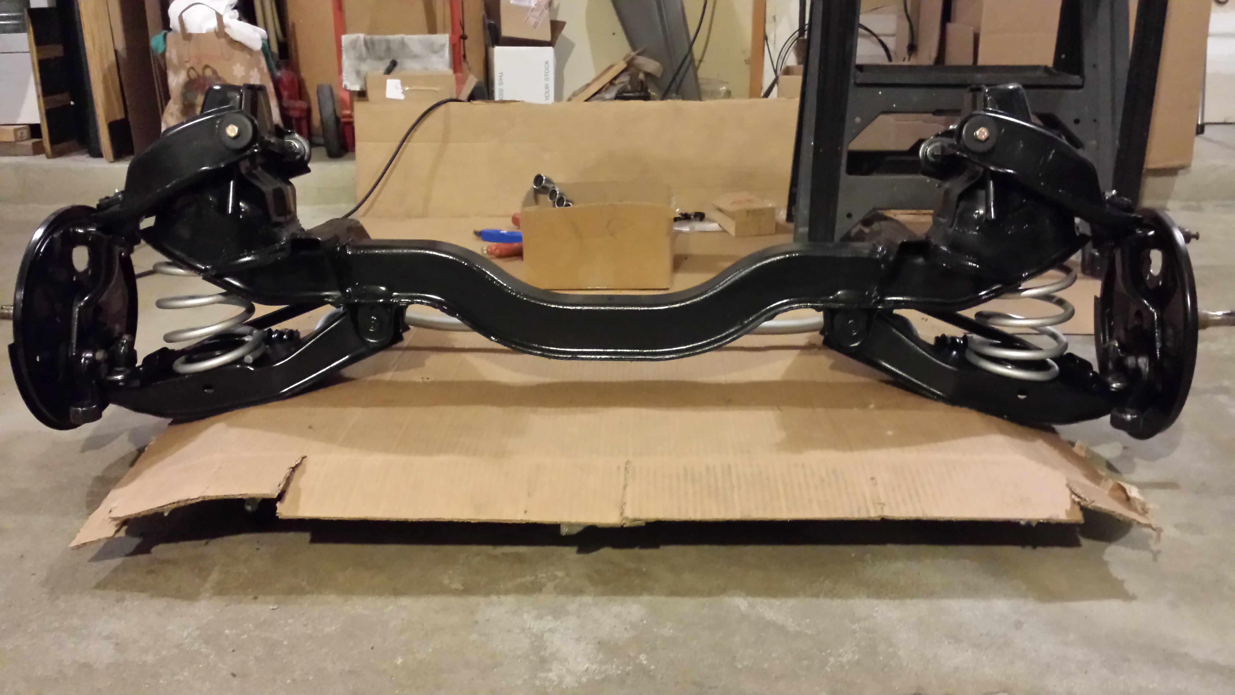

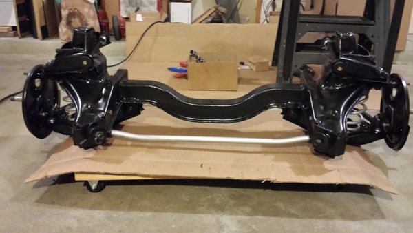

Well it has been a while from my last post. Everything takes about 4 times as long as I estimate. In my last post I had the front suspension disassembled and the big parts were off to the blaster. Once I received them back, I decided to prime and paint myself. But, in typical fashion, the Michigan weather was not cooperating. I needed the steel warmer to paint, so I came up with a ‘redneck paint oven”. This allowed me to preheat the steel after cleaning, and bake after paint. I had no problem keeping the box interior at ~120*F! the following shot after prime and topcoat.

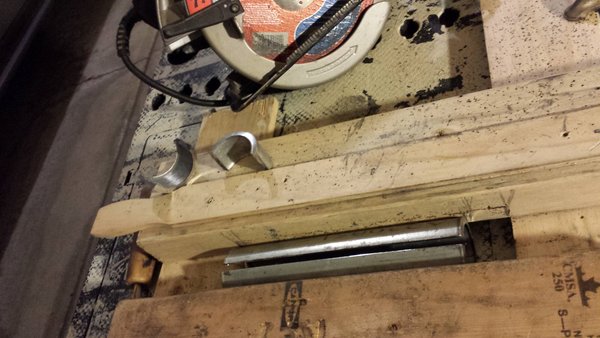

I needed a set of tools to press the new bushings into the control arms, and found a good thread over at CC - http://corvaircenter.com/phorum/read.ph ... 222,402737 - with this guidance I made my own set of tools to do the control arm bushings. I had Home Depot cut the pipe to the correct length and then I split lengthwise with a cut-off wheel…
Worked like a charm. I also borrowed a ball joint press set from O’Reilly’s just to have a variety of spacers. After a lot of small parts clean-up and paint, this is where I’m at…
Still have some odds and ends to finish up on this assembly, but the big parts are done!

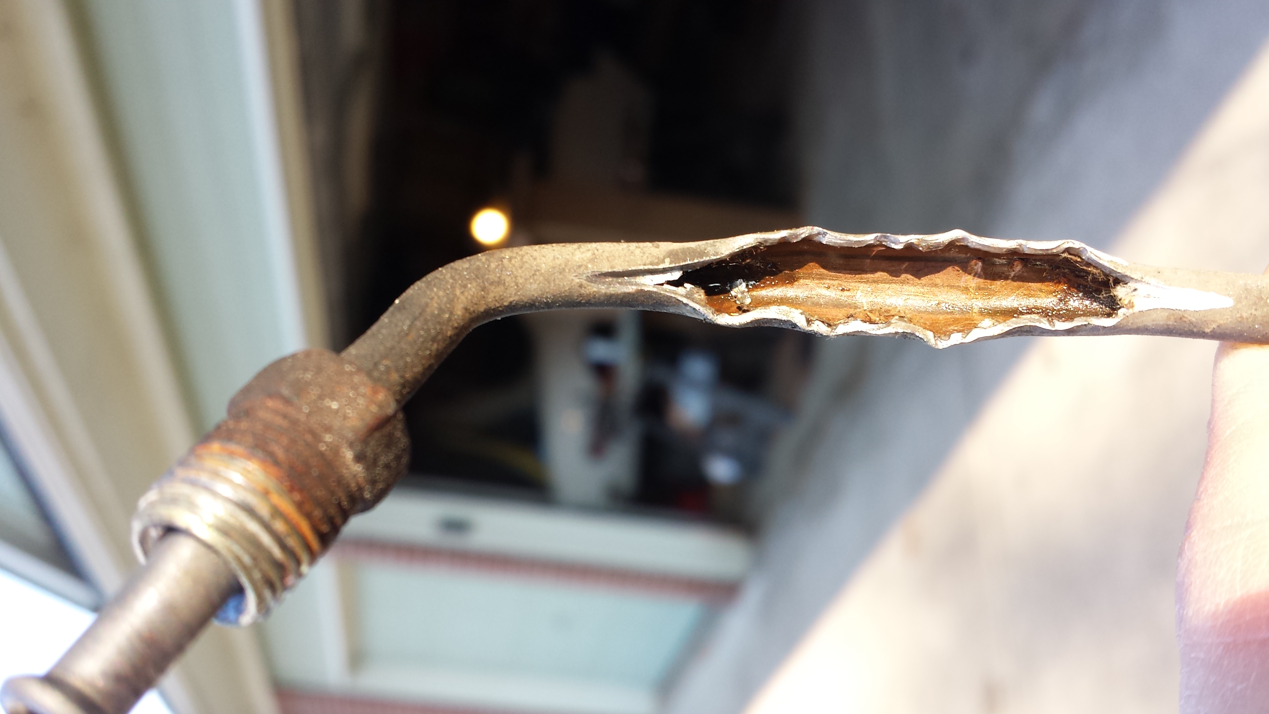

New lines are the way to go. In that same thought replace the whole system- cylinders, lines, hoses, & mc.
You don't want any failures

About the brakes, I decided to replace the front lines and flush those to the rear, and replace all of the slave cylinders and of course the hoses. I have received all of these parts and this evening I decided to do something mechanical – so I decided to assemble the brakes onto the front suspension. When I finished the right front, I had one washer left over and am not sure where it goes! It is not the one for the star-wheel; it looks like it is the right size to go under one of the shoe retainers – not sure if it would go on the front (smaller) shoe between the shoe and spring, or if it nests on the top of the rear tube washer… Any thoughts or guidance would be appreciated!

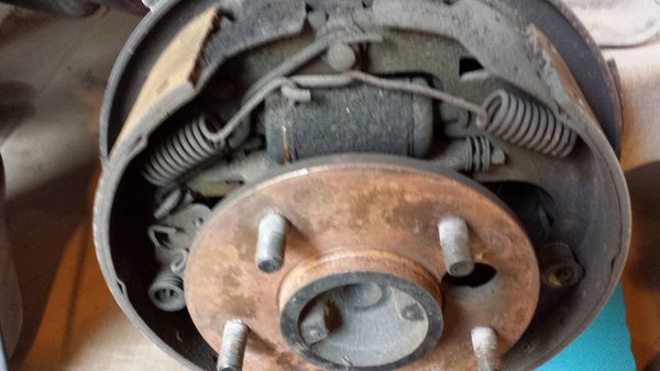

What is wrong with the following before-disassembly photo?
As I was putting the two rears together, I realized a part was missing on both sides. Worse yet, I cannot find in Clark's Catalog! So I've done all I can with corner assembly until I acquire these parts...

Maybe I'm not seeing it, but what is missing here? If you mean the washers that are on the front brakes, the rears don't have them. At least mine don't anyways.

No "Guide Plates" on either rear corner... And mine had all the washers at the shoe attachment springs like the front.
I cannot locate "Guide Plates" in Clark's Catalog - have an email into them...

Clark's lists used brake retainers, but they are also shown as out of stock.
http://www.corvair.com/user-cgi/catalog ... ge=USED-22
You might be able to find them at the Corvair Ranch in Gettysburg, Pennsylvania...
http://www.corvairranch.com/
My understanding is the rears don't use the retainers. They could but it is not needed. Mine doesn't have them-
