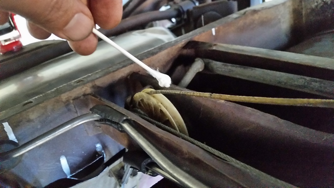

Next up was a quick lube of the 2 pulleys right next to the shifter. I used a small tube of White Lithium Grease and a Q-tip to get it deep into the grooves. Cleaned out the pulley's with a wet paper towel first to get the dirt and crap out of there.

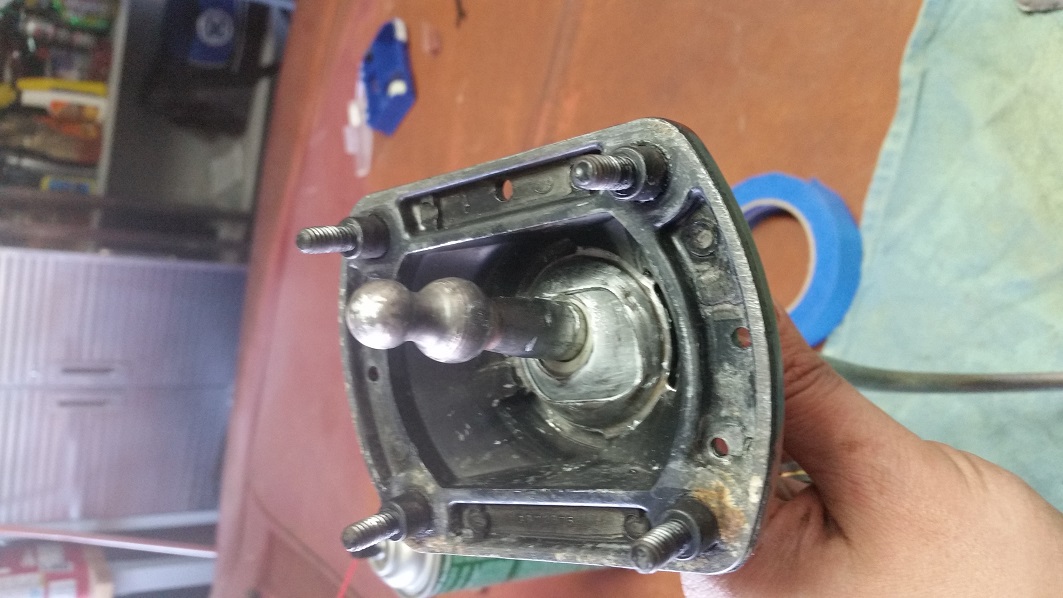

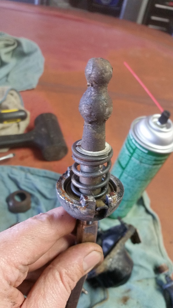

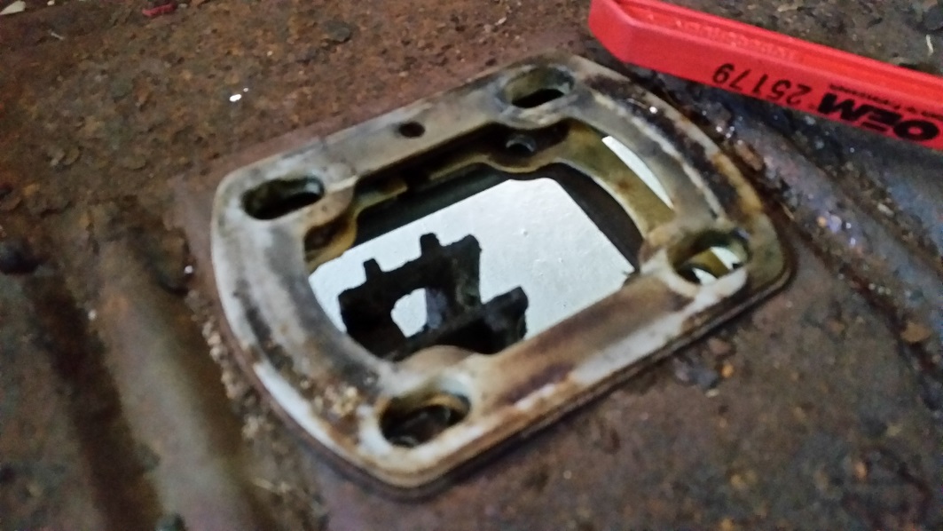

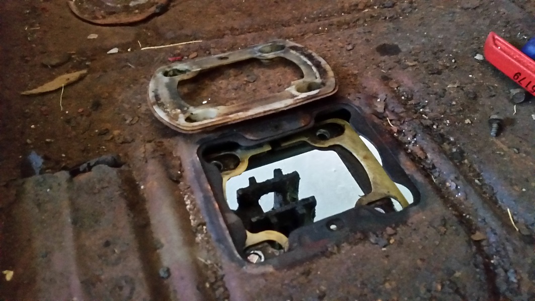

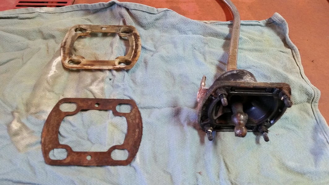

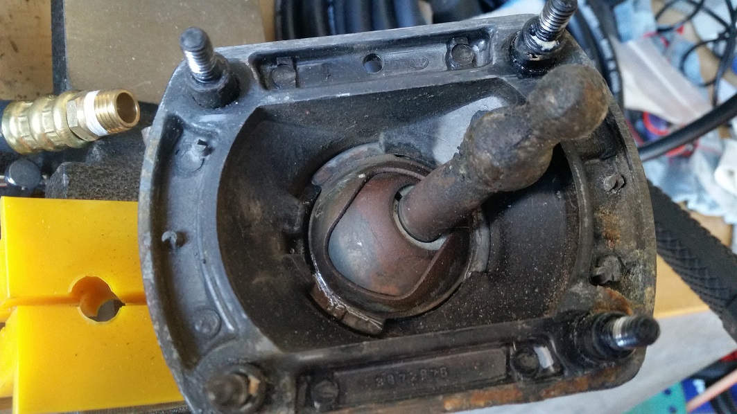

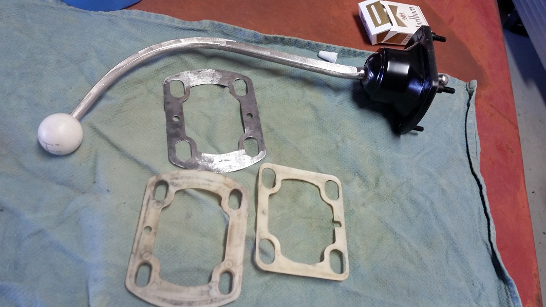

This one was more interesting for me, since I've never taken apart a shifter before. While the tunnel is down and I'm slowly gettig ready to clean up the interior floor, I dropped the 4 nuts in the tunnel and the shifter lifts right out. I had THOUGHT that it wasn't bad at all, since it seemed to move easily enough in the car. Leverage works wonders I guess, because it was completely gummed up with dried out 48 year old "lube", rust, and dirt.
The floor had the shim underneath (teflon?), plate, and top plastic plate all intact, just filthy, gummed up and had ridges from rust and disuse.

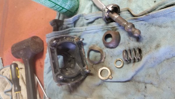

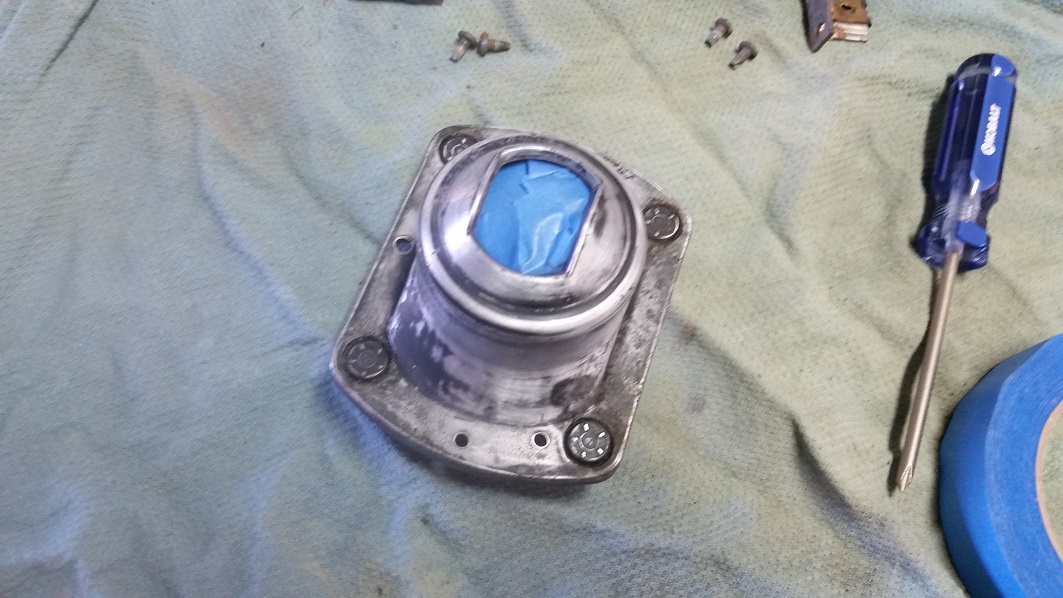

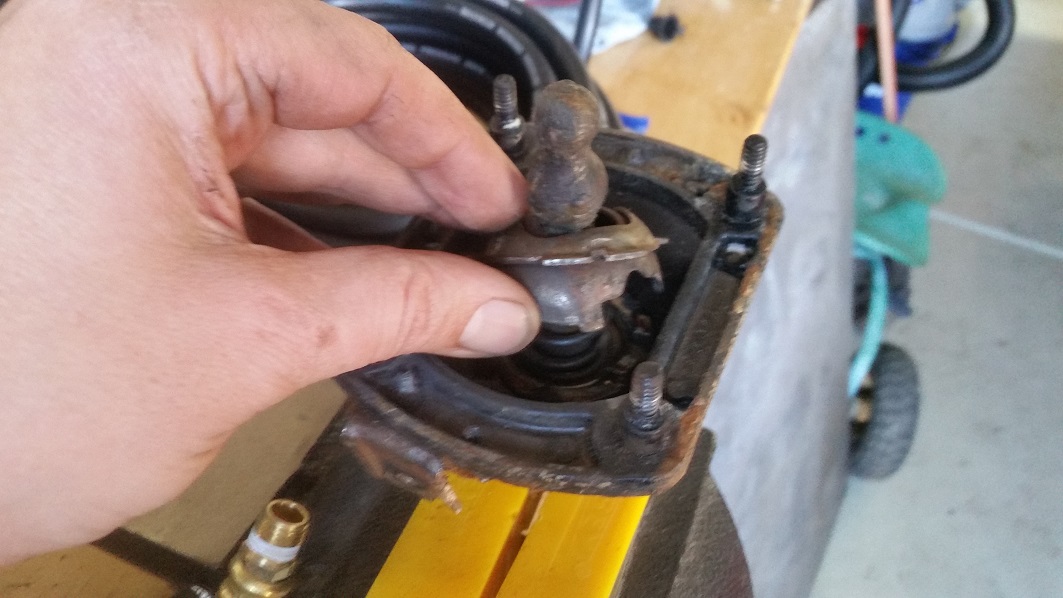

Dis-assembly is simple enough, just turn the retainer inside the shifter cup until the tangs move to the open areas, and it all comes apart. It is spring loaded (not scary, but some), so I just put a rag over it and turned it until everything came free.

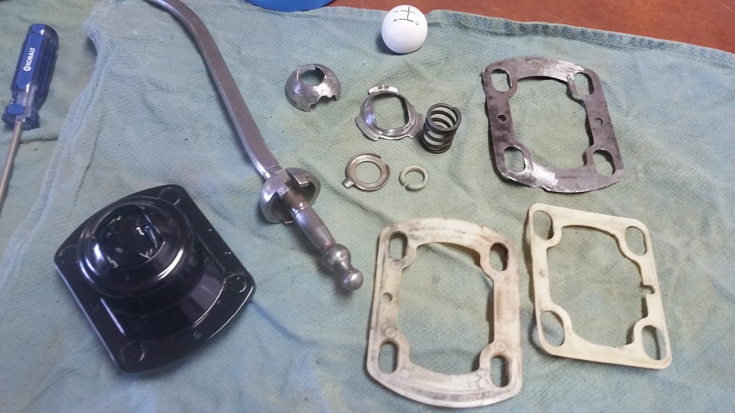

Now that it's apart, the fun part begins! I just very simply used a dremel with a sanding barrel on it and went over everything. Not trying to go for "pretty", just wanted everything SMOOOOOTH. ::-): I also took the opportunity to run a quick sanding on the outer cup.
The book calls for Lubriplate to assemble, but I just used White Lithium grease on every piece as I put it back together. Assembly is just the reverse of taking it apart, but the spring seemed bigger after taking it all apart. I put the shift lever in my vise and using a piece of pipe, I pressed the end down over the whole bubble and while compressed, slide the tangs back under the slots.
Purists wont like it, but my shift lever was really rusted and pitted, so with nothing to lose, I hit it with the sanding wheel as well to clean it up some.
All cleaned, lubed, and done!!

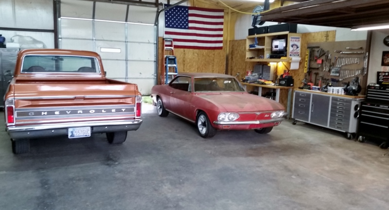

**(Skip if only interested in car stuff, lol)** Been out awhile, but I've had a lot of "life" going on. So, quick life update... Wife is now retired from Air Force also, and since my folks are both passed, but her whole family is still in Oklahoma, we put the master plan in play and moved to the midwest. Shut down working on the Corvair while we were packing up garage and house, took a couple months to actually get moved, and ended up here in Jan.
Couldn't be happier really. Vegas has lots of great food and entertainment, but we moved from suburbia to the country. Have 5 acres now, a little smaller house, and a 1200 sq ft shop. Not too fancy, but has some insulation, flow through garage doors, and a 4 car carport on the side. Love it. :woo:

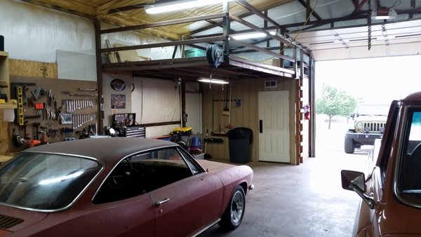

Inside, still unpacking some and re-arranging as need be. Have good lighting and air set up inside and out, dedicated 100amp breaker box with plenty of outlets.

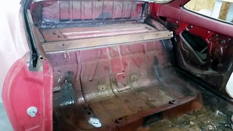

I decided that I really want to mount the front seats in the car next. I want them off the floor of the shop, and will just be nice to not sit on 5 gallon bucket when I'm in there. Before I can do that though, need to get the floor scraped and coated with some Rust Bullet.

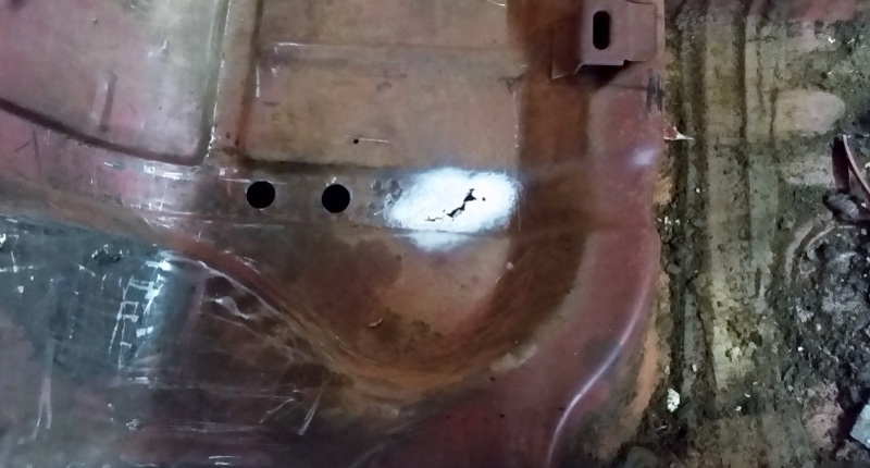

I got a lot of seam sealer out of there, but didn't dig in to the actual seams too much. Wanted to keep it sealed, but wanted to get a good look at the floor also. I also still plan on getting plenty of Rust Bullet leached into the seams and eventual dynamat. Pretty sucky job, but I'll feel better knowing what's up. Turns out I actually found another little rust spot that I hadn't seen the first time.
Hit it with a smack of white paint. Not to accomplish anything at all other than a marker so I know where it's at. Not fully done, still have the front area to do.

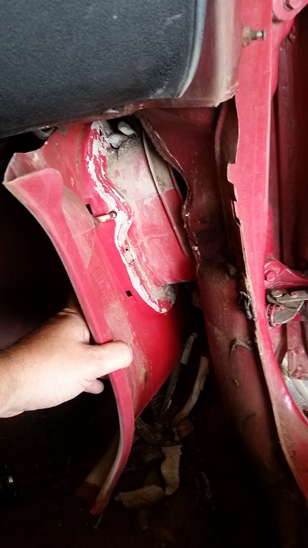

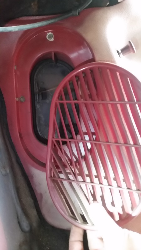

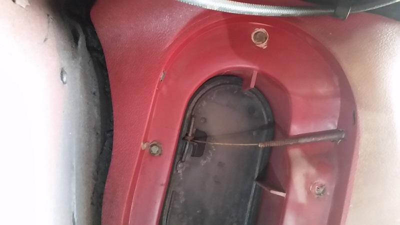

Wife spent the day with her sister, so I spent the day in the shop. Got the interior pans coated. Not very sexy looking compared to some of the actual pro's I've seen around here, but NOTHING I coated today will be visible once I get the interior back together.
First the kick panels if anyone hasn't seen them. I know this is easy peasy, but I saw some stuff about coupe vs. convertible, etc. and I was starting to think it was a harder job than it actually was.
Pop the actual vent out, not held in with anything.
4 5/16" hex head screws hold the kick panel on. This was kind of irritating. After so many years, the plastic sort of sucked around the heads of the screws in a couple places, and half of them were coated in the grey goop sealer. Cleaned the edges and pulled 'em out.

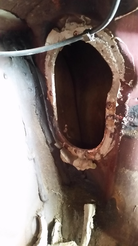

Then just work the plastic and pull it out. Lots of the grey goop for sure.
No big deal. Scraped off all the sealer and vacuumed out the holes. Didn't find too much at all which was really surprising. Anything specific I should be looking for or doing in there?
I DO see that getting these resealed may be a challenge, but in 50 years I would think sealers have evolved. Maybe just some compressible rope caulk will do the trick?
I'm not sure which way I'm going to go on these, to tell the truth. I'm about 60% sure I'm going to say the hell with the vents and turn them into speaker holes for the woofer part of some nice components. Not sure yet...
