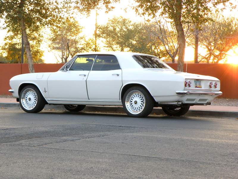

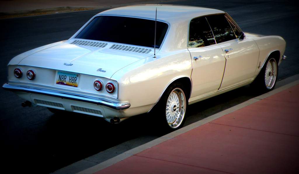

I got some new rims and rubber on the LM sedan this weekend. We took it up to the local car show that was swamped with visitors due to the Barrett-Jackson auction in town. It was a wild crowd with some very unusual cars. I even saw an old BMW M1 drive past us. I don't think I've ever seen one of those in person. We got a nice parking spot and spent the night talking to many Corvair lovers.
BMW 5 Series (BBS RC090) 17 x 8,  25mm offset,  225/45-17 rear, 215/45-17 front, (1&quot; spacer used to obtain zero offset and adapt BWM bolt pattern to Corvair pattern.<br /><br /><br /><br /><br />.
BMW 5 Series (BBS RC090) 17 x 8, 25mm offset, 225/45-17 rear, 215/45-17 front, (1" spacer used to obtain zero offset and adapt BWM bolt pattern to Corvair pattern.

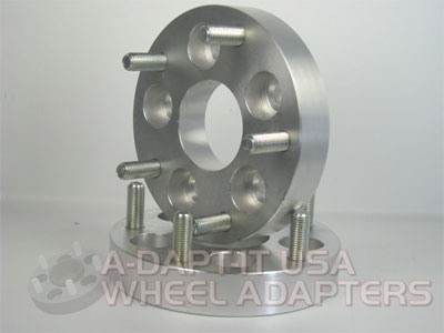

bbodie52 wrote: Do you have a source for those 1" spacer adapters you mentioned?
Adapt-it USA located in Indianapolis
http://adaptitusa.com/5x475to5x120wheeladapter.aspx
Made in the USA! Right down the street from where I grew up too. They were they only company I found willing to make the correct GM (5 x 4.75") to BMW ( 5 x 120mm) bolt pattern adapter for a fair price (USA or China). The company was excellent to order from with constant updates and around $11 shipping. From order to delivery was about 10 days.

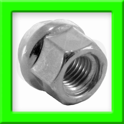

They also included the correct 7/16-20 sleeved nuts to be sure the adapters run true when bolting to the car. I like this system because the adapter locates on both the sleeved lug nuts and the tapered seats.
For bolting the new rims to the adapters I chose the standard 12x1.50 stud option. You must supply your own bulge seat acorn lug nuts and I got those from ebay for $15 delivered.
Special nuts for bolting to the Corvair hub. These are included in the cost of the adapter.<br /><br /><br />.
1.0&quot; Spacer/Adapter. $45 each<br /><br /><br />.
1.0" Spacer/Adapter. $45 each

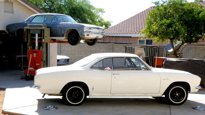

I have two more at home! They are project cars of course. One is a 110/PG and the other is a 110 4-speed with factory A/C.
In the photo the 4-speed sedan is on the lift and the PG sedan is just peeking it's nose out behind the garage. The Corsa is not for sale.

Update:
Some final details on the new rims and rubber as well as info about lowering the car for a better look.
I liked the new rims and rubber but wanted a slightly more modern look so I removed one coil from the front springs and 1.5 coils from the rear springs. I am now quite pleased with the looks and the ride height. At this height I get no wheel rub on the top of the front fender during compression while turning (entering driveways) and I can still easily roll my lift under the chassis for service work.
Please note that the front springs on this car are OEM springs but are slightly thicker than normal coupe springs to compensate for the extra weight of the spare tire and A/C components in the trunk. Your results may vary if you do similar cuts. The rear springs are the same for LM sedans and coupes regardless of factoty A/C. Convertibles have different springs too.
