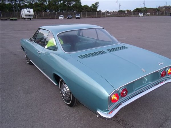

Looks nice huh? ...........wait and see
looking good in PA
looking good in PA
Looking good at liverpool dock

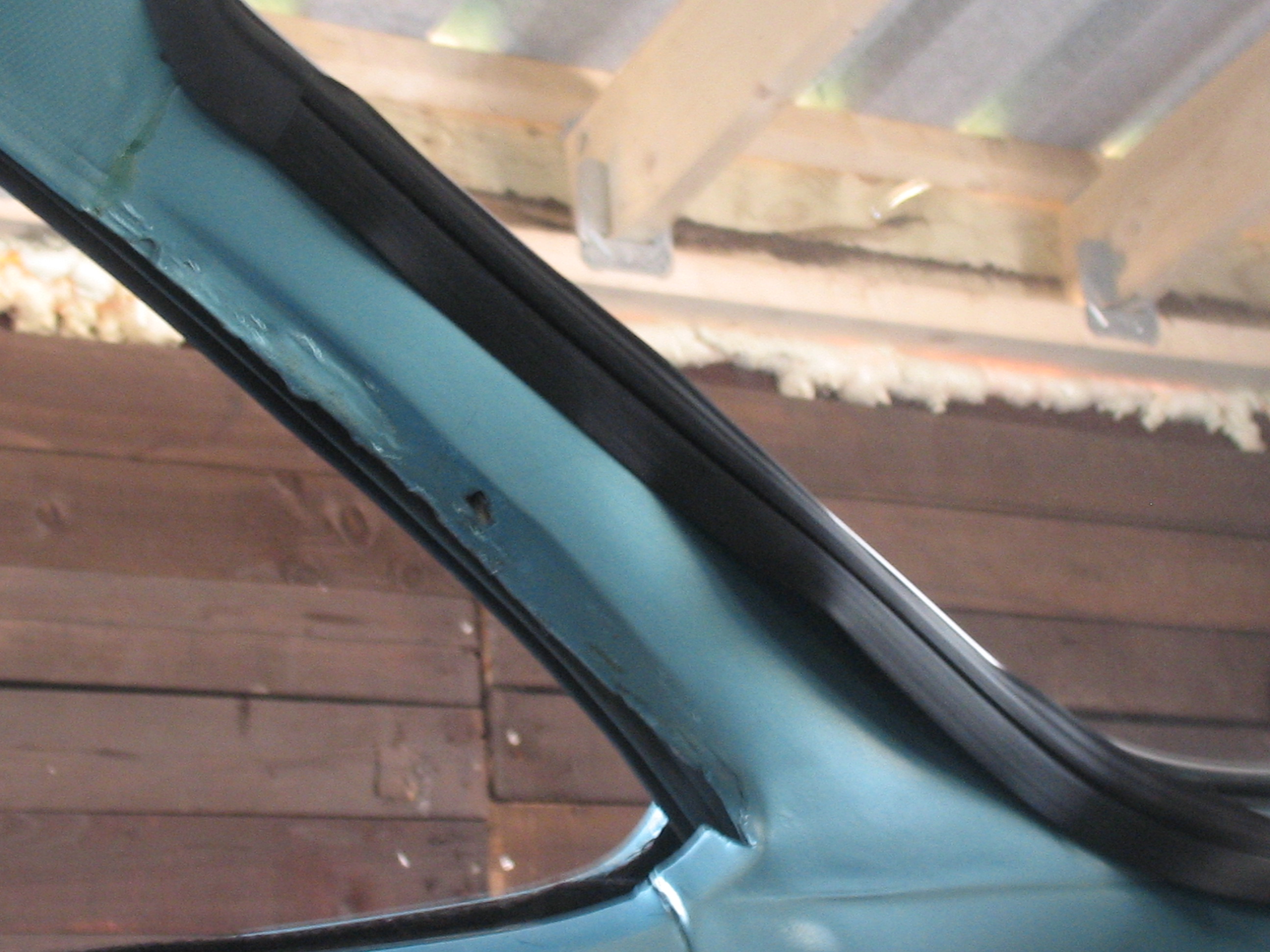

but wait whats this behind the spare tyre
and this under the carpet?

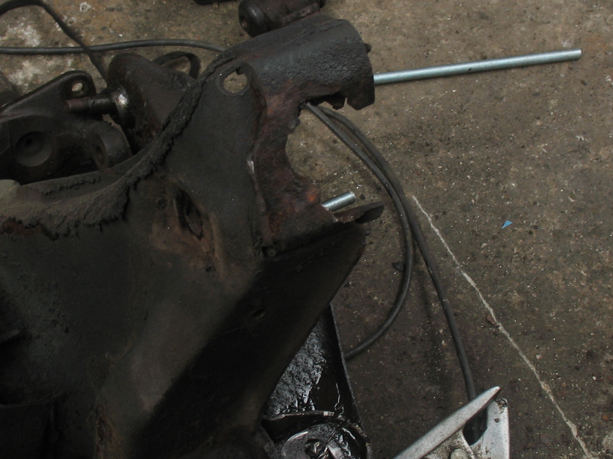

shouldnt there be a front tie rod here?
Re: pensylvania bondo bucket
Oh my gawd....so how was it steering correctly on that last pic?

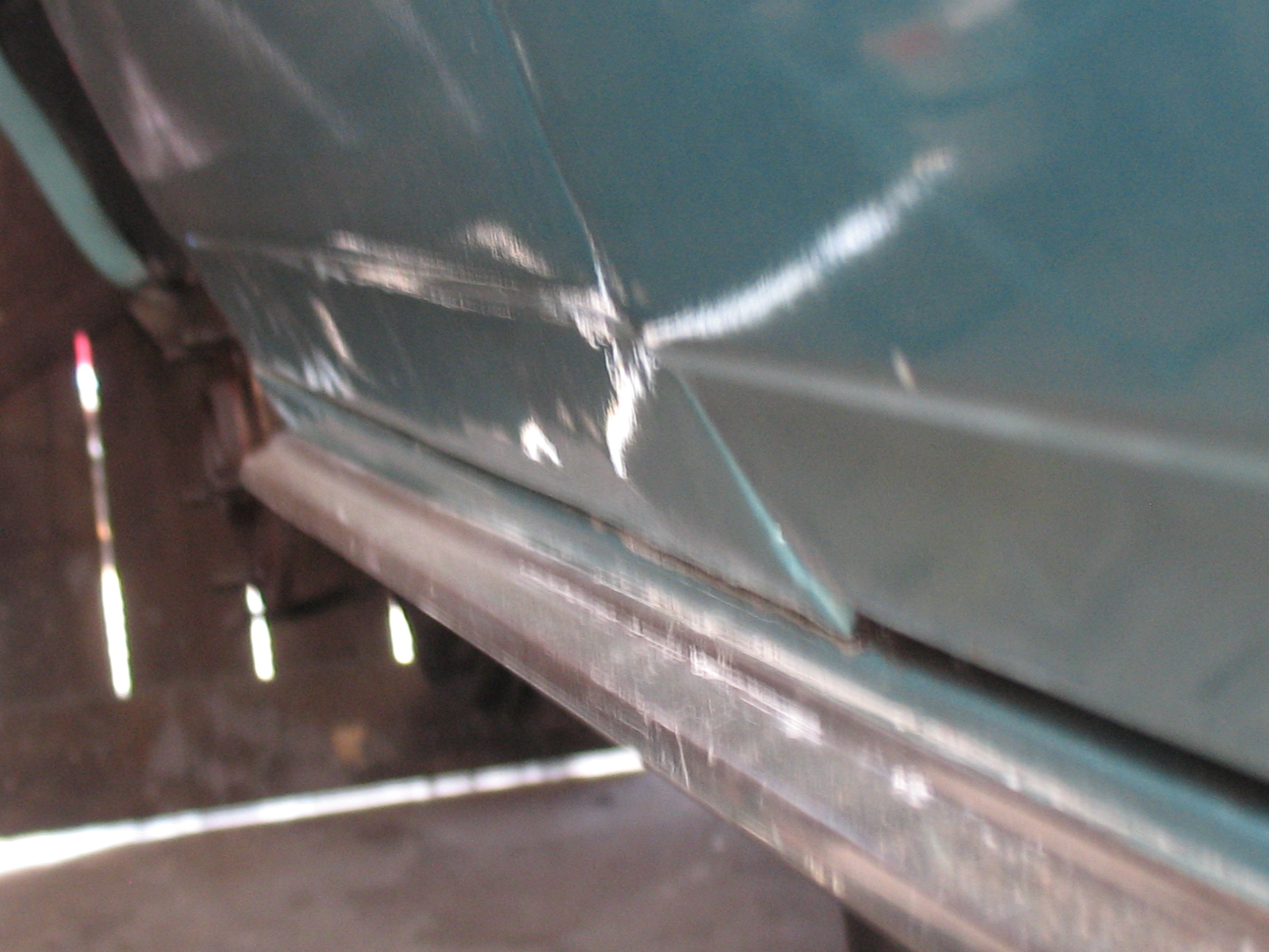

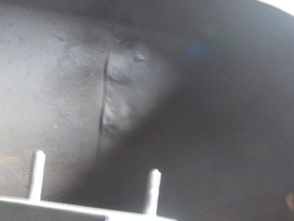

shouldnt there be a seam on the rear quarter?
silly me, here it is on the other side
bondo on the inside????????????

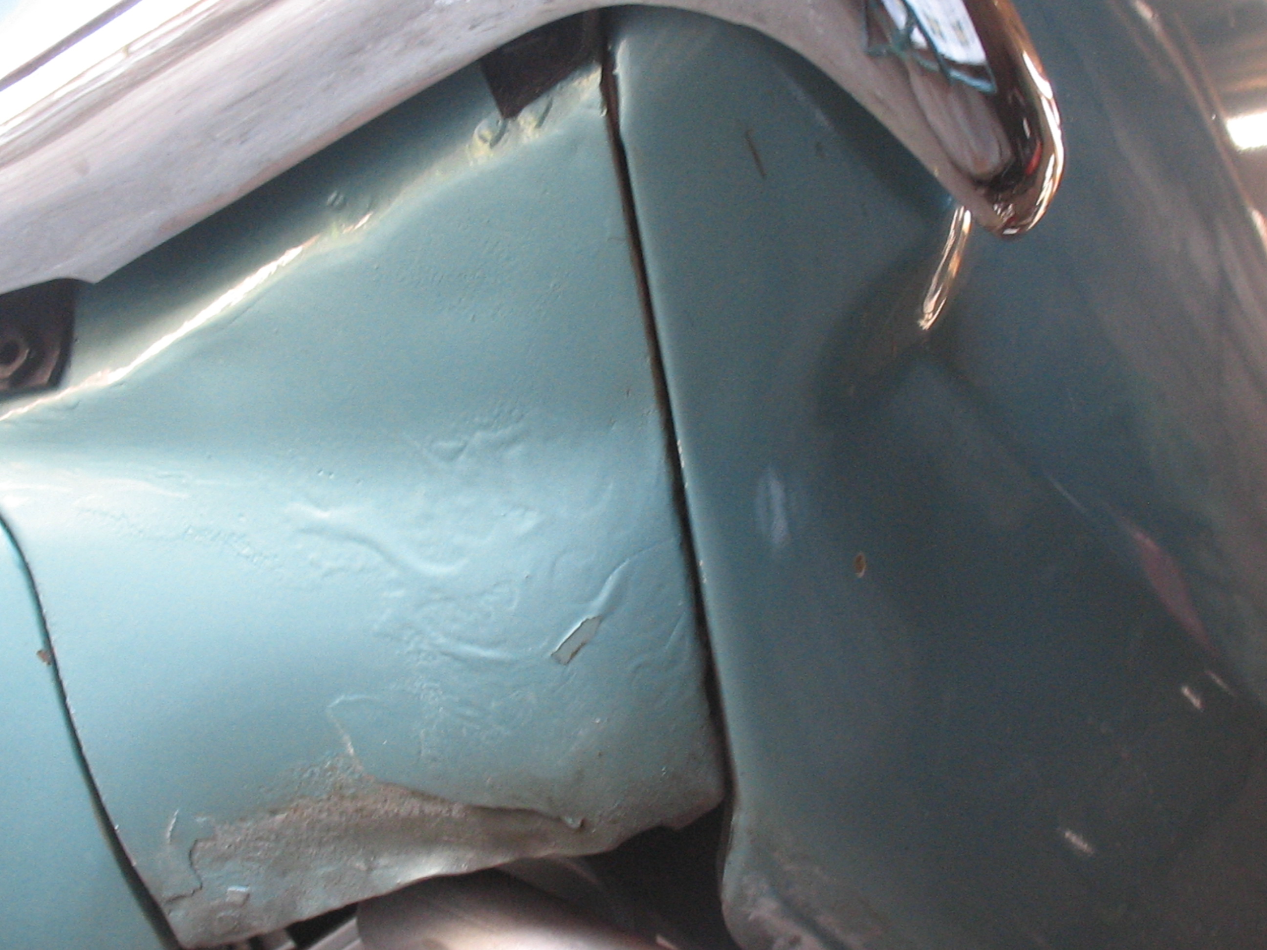

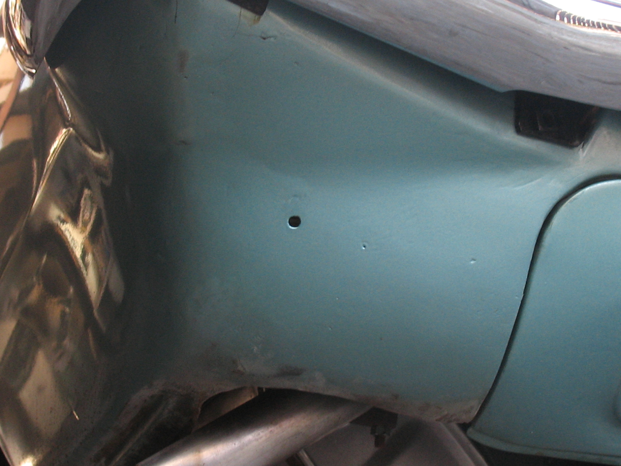

Hmmm...thats an odd shape
cant wait to see wats under here
a job well done and heres the bill to prove it

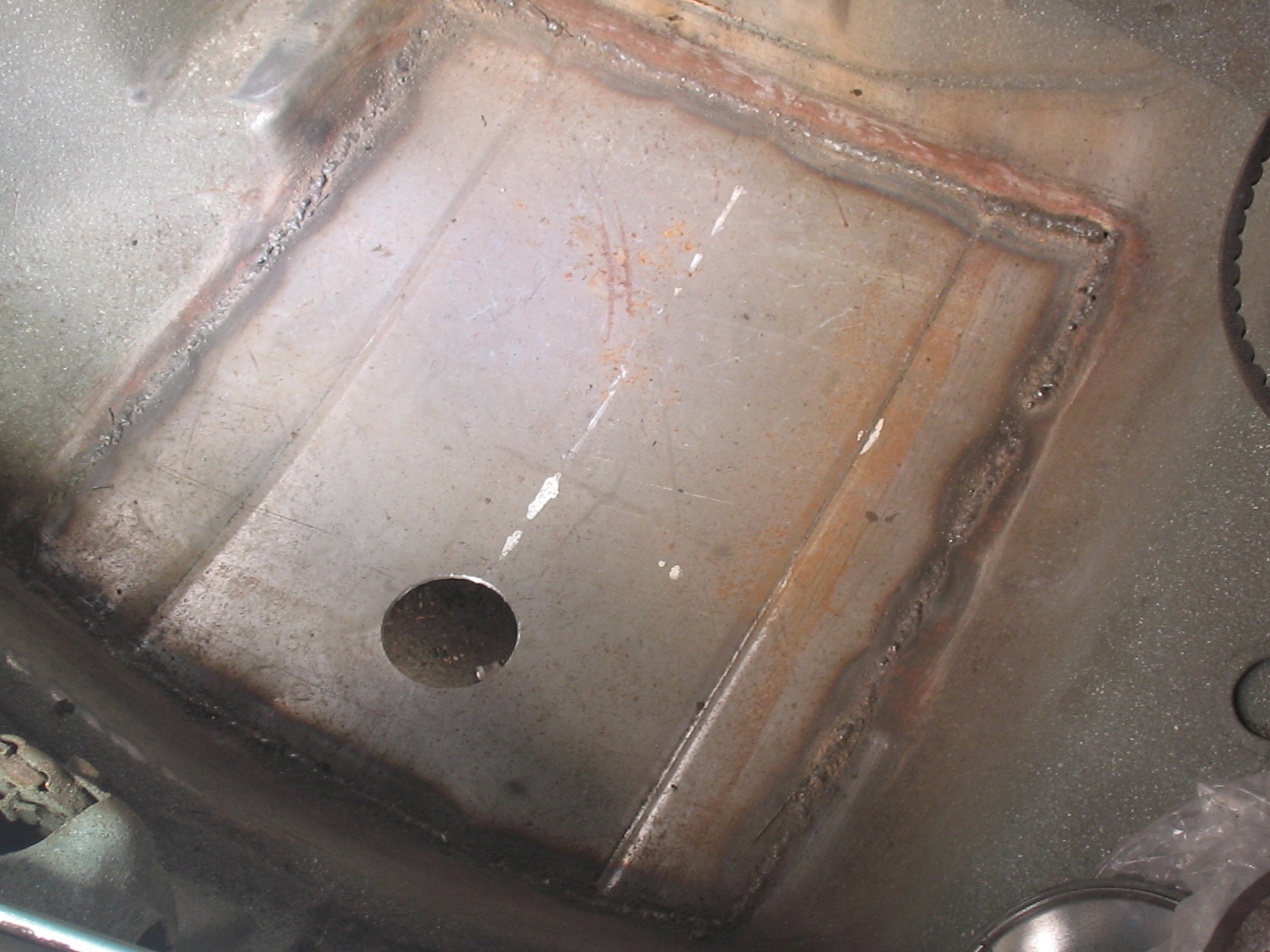

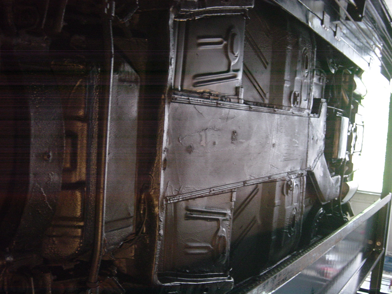

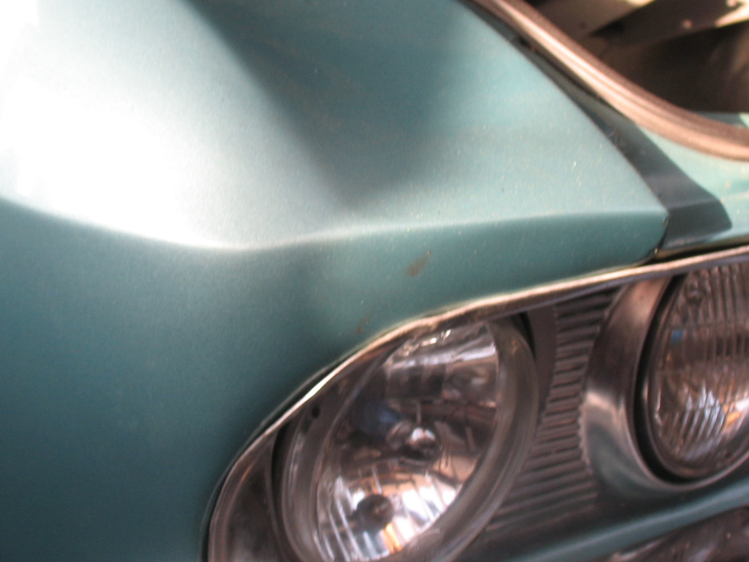

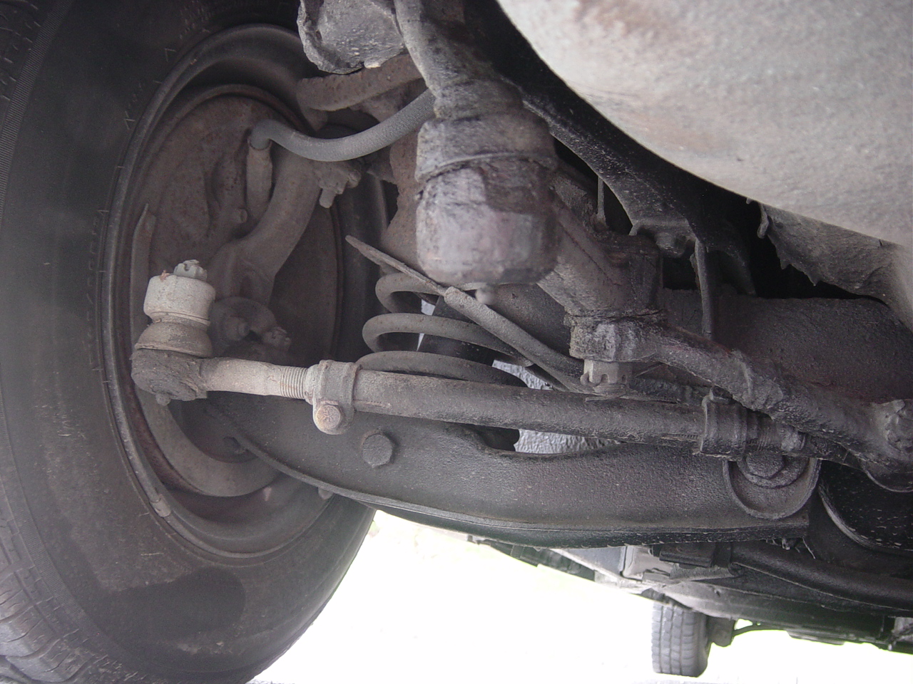

I will get it done, its just more work than I expected, and its annoying that its someone elses work I need to put right. I got loads of pictures from the seller, including underneath, but they were cleverly done, and he made sure I got pictures of minor faults to distract me away from the major ones. Having looked at the bills that came with the car, I believe it to be a genuine 2 owner car, but the previous owner was driving it around completely oblivious to its true condition, he didnt even know it had 64 sests in it as he has a bill from Clarks for 66 seat covers with a return slip to replace with 64. I knew about the seats but wasnt prepared for them being completely different colours and not being bolted down securely. It certainly fools people into thinking its a nice car until I point out the problems. I knew as soon as it arrived on the trailer that it was bad, the first thing I saw were the rear fenderwells , which I will photograph when I start to repair them, they are full of expanding foam and undercoated over the top. For now , I am starting at the front and working my way along. I have no intention of driving it until every part is gone through, although it sounds OK engine wise. As you can probably tell from my Larry Shapiro and clarks 4x1 post, my intention was to get a good car and just pep it up a little. I think the next pictures show that no matter how many photos you ask for, an experienced con artist can make anything look good :redface:

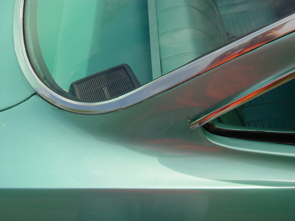

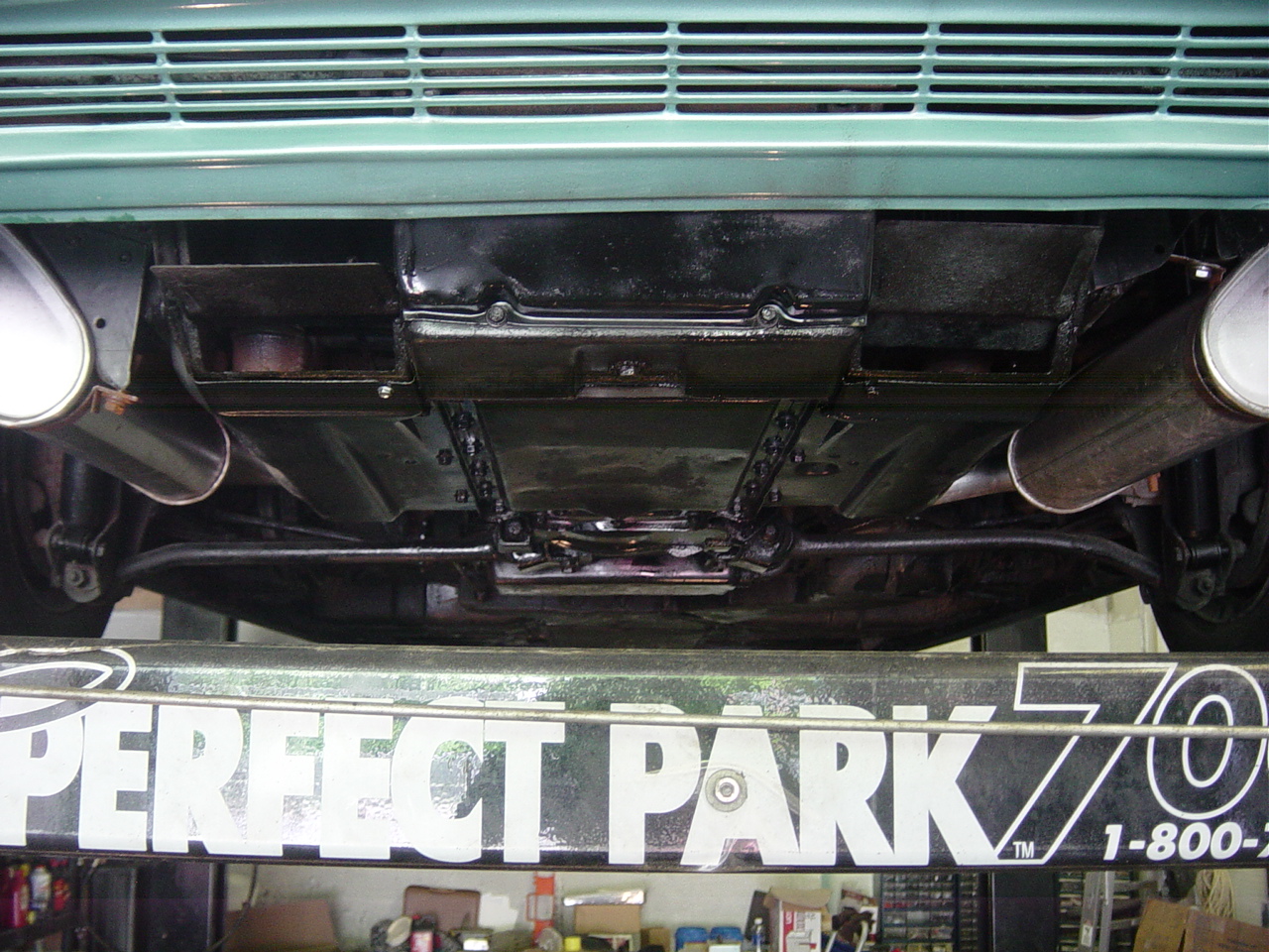

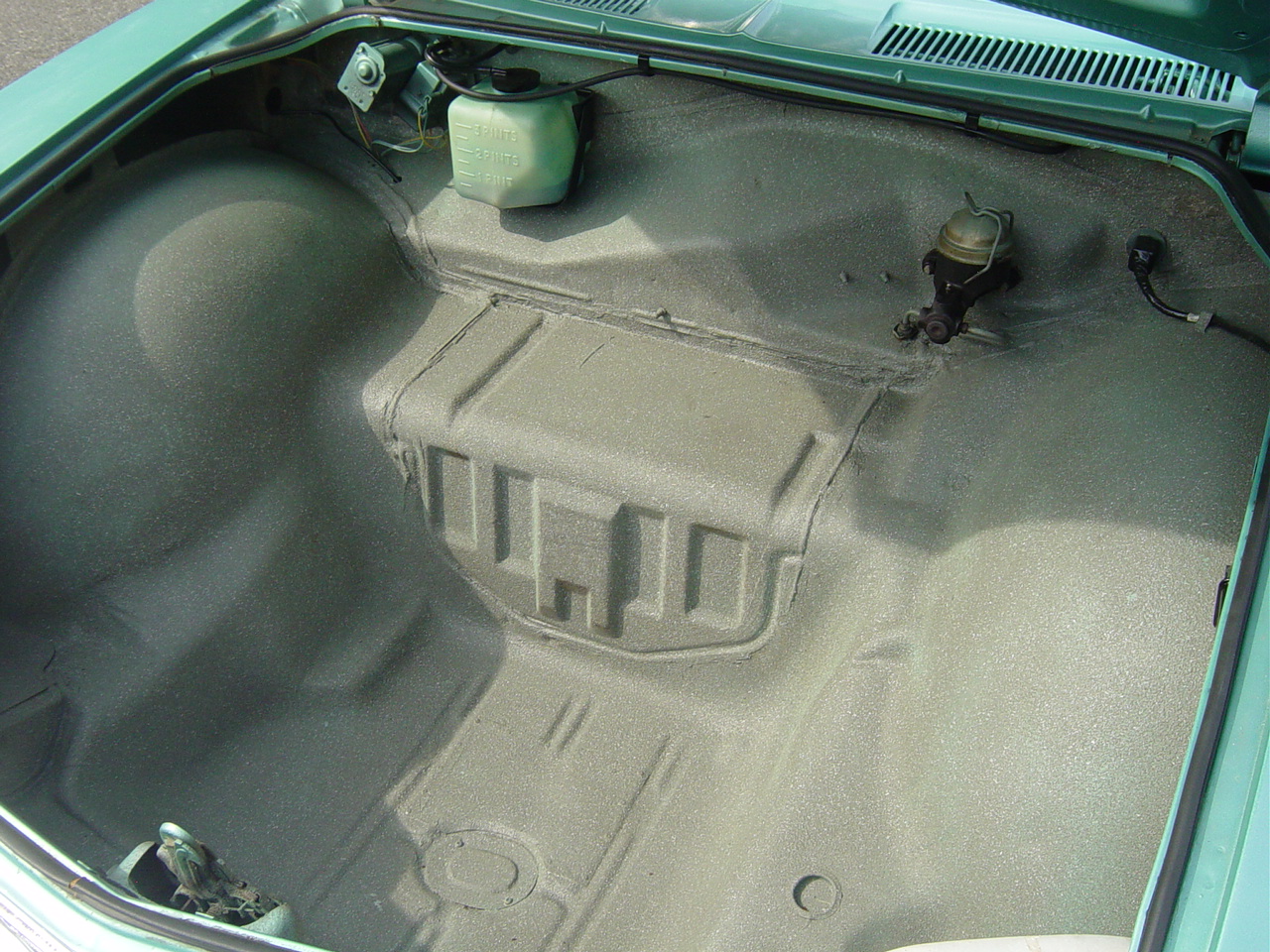

sellers pictures
sellers pictures
no sign of the damaged crossmember or loose tie bar here...well hidden
nothing here to suggest rivet pan repair
note how the photographer managed to avoid capturing both ends of rear panel
no obvious sign of riveted repairs under the spatter paint

The seats probably don't quite match the rest of the interior because GM changed its colors a bit between '64 and '66. Strange that the P.O. deliberately decided to do that.
I realize it is hard for you to pursue the seller legally from across an ocean, but the reason you should do so is that they are willling to sell cars with concealed major safety problems. Prior rust repairs may be within the scope of "as is," but that crossmember is something that could kill you. Imagine if you had jumped in the car and gone for a long drive.

I'm not the worlds best welder but its gotta be better than rivets
Am-Iron
Posts: 427
Post by Am-Iron »
Looks good. Did you make that part? A little grinding and filler it will look great! Nice start, I am sorry you did not get what you expected. You can probably get that A arm from someone on here.
mart
Posts: 928
Post by mart »
Yes I made it, doesnt look original but it will do. I will try to repair the crossmember if I can get hold of some 4mm plate and an arc welder, I dont think my little gassless mig will cope. Floorpans next for now, plus a few more hidden horrors no doubt :fingerscrossed:
