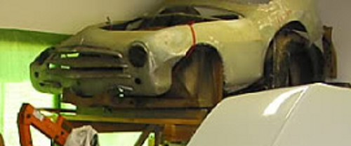

I think the real question is wtf is the body in the background?

Vanman
FORD...thirty's something Woody?
The one on the rack almost looks like a squished HHR??
Vanman
Posts: 605
Re: Porsche powered AWD Corvair
Post by Vanman »
Yeah saw the woody, its the funky one Im asking about. Hmmmmm.

Goop Of Oil
Posts: 159
Joined: Tue Mar 23, 2010 7:43 pm
Location: Westminster, MD
Post by Goop Of Oil »
This "Body" looks like the size of a go-kart but it is deformed like a Zingers model from the 70's.
It could be made out of the same stuff that they made the 58 Plymouth "Christine" out of for the movie.
What is it?
What is it?
