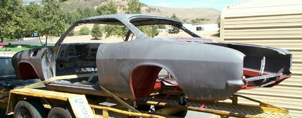

After a chemical dip and red oxide coating on the underside, the body heads home for installation of a NOS rear cove from Clark's and repairs to the dented lft rear quarter.

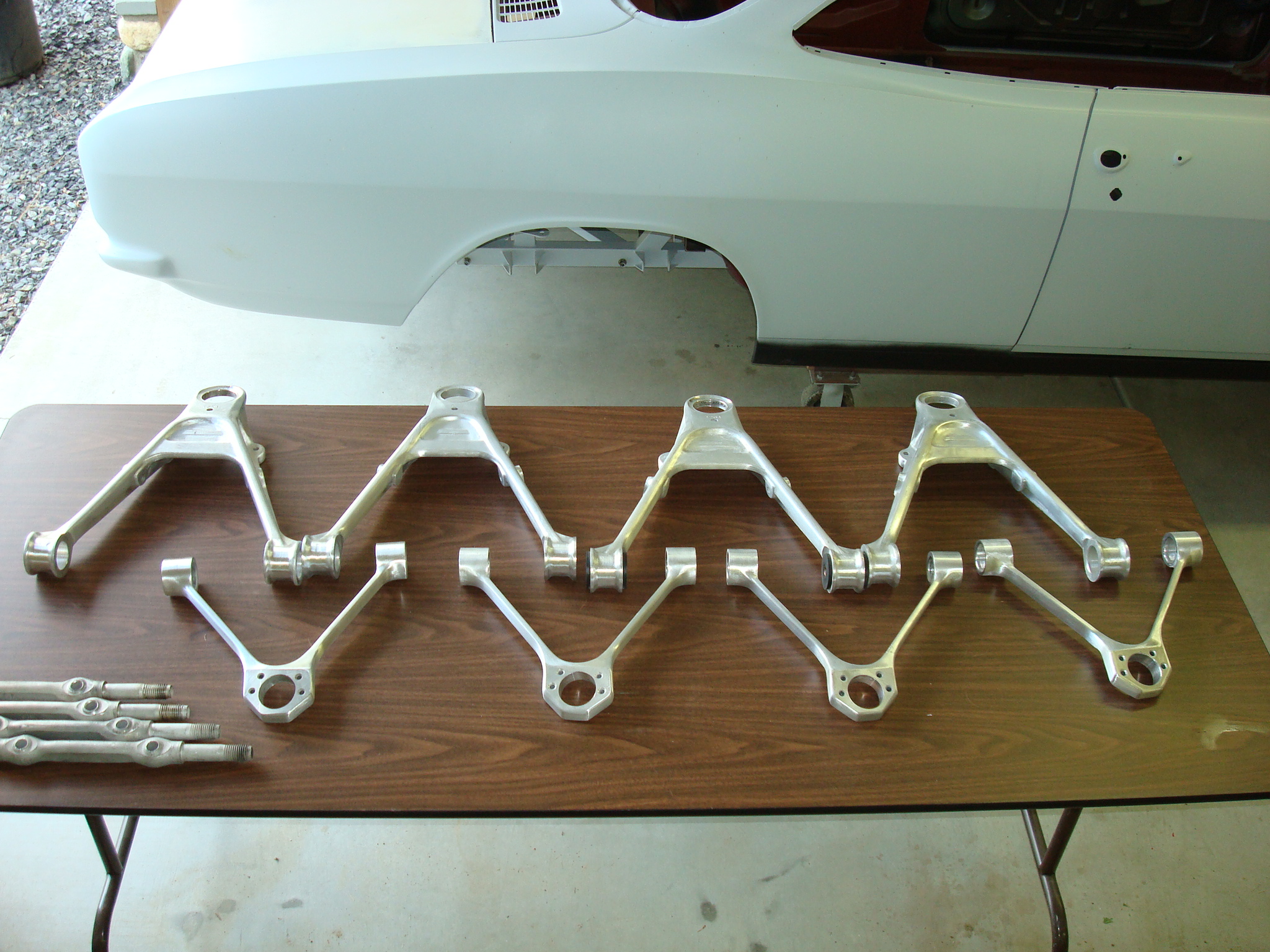

C4 lower a-arm getting the forging flash removed.
Upper control arms getting the same treatment. Before on the left, after on the right.

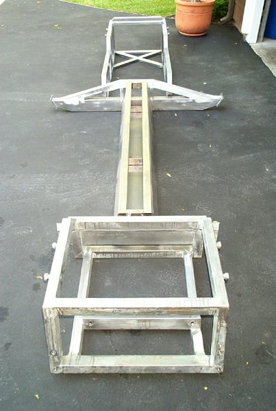

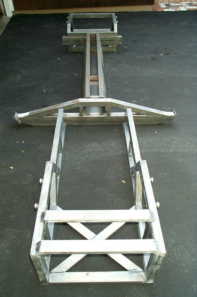

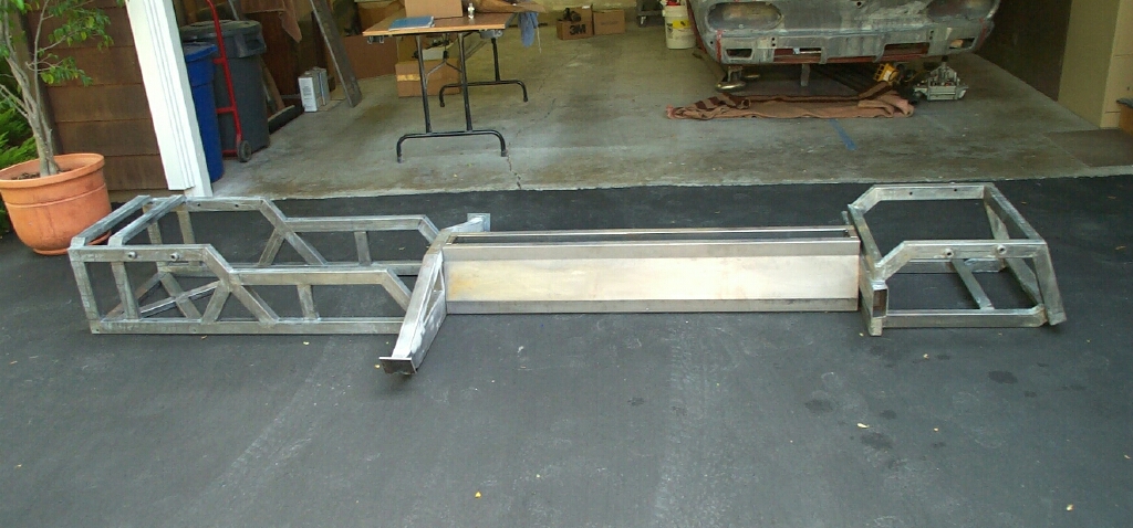

Chassis profile.
Chassis, front view.
Chassis, rear view.
The front and rear sections of the chassis attach to the Corvair's unibody frame members via additional tube links while the center crossmember attaches to the Corvair's sill boxes in line with the rear door jambs.

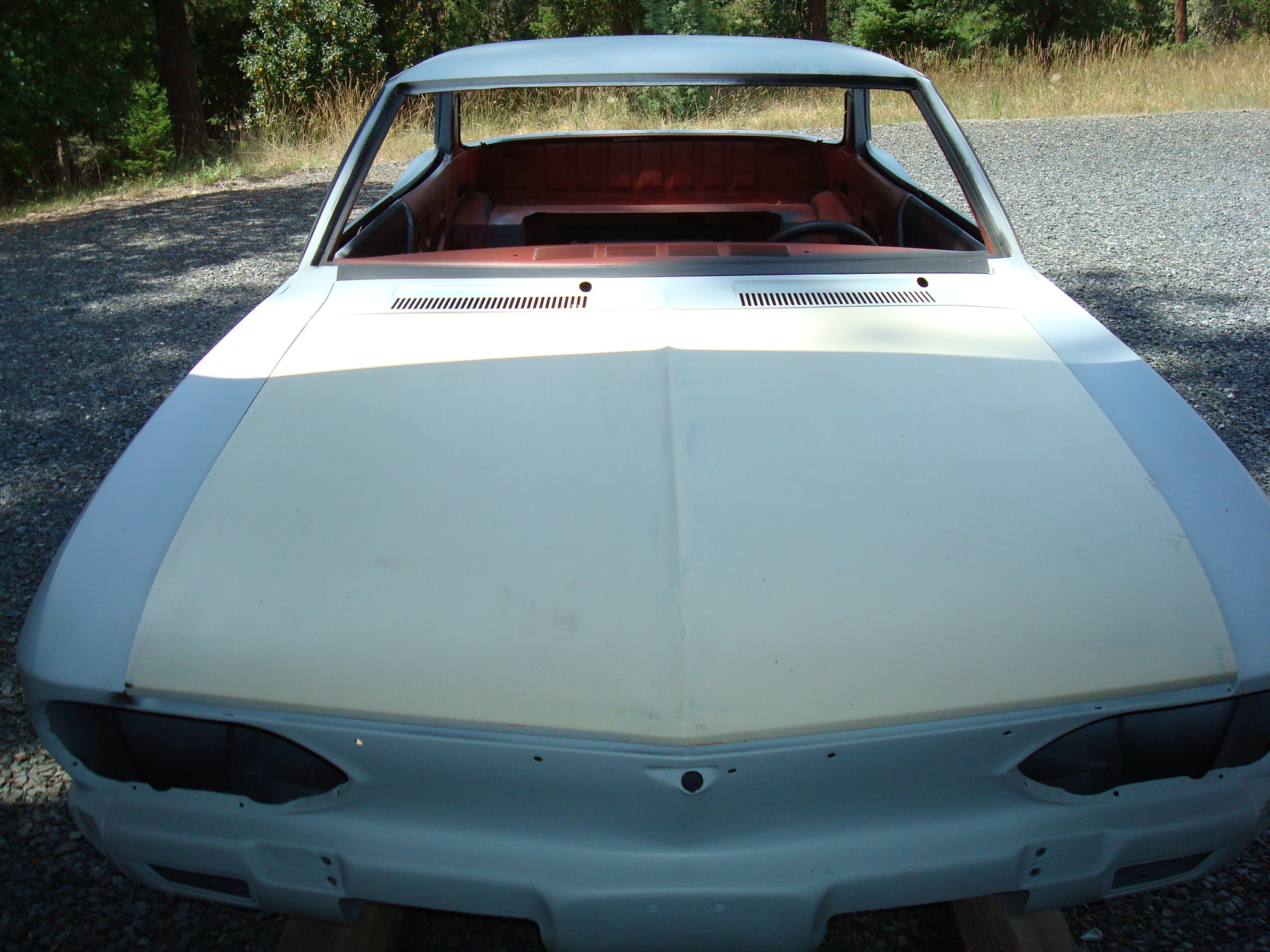

I just got around to taking some pics of the car's current condition. There's a significant "jump" from the work completed (and time) in the last post. As I mentioned I'm not very diligent about taking pictures. In this series of pics a substantial amount of bodywork has been completed, and the carbon fiber hood and deck lid have been attached but without proper alignment or gaping. While the pictures don't show them, I've got a couple of kinda' Mickey Mouse hood and deck lid props that I'm not particularly happy with. They're stainless steel and operate via a self locking function that is released by lifting the hood until you hear a "click" and then you can lower it. It works well as long as there isn't a breeze that could lift the hood thereby unlocking the catch and allowing it to crash down. I was going to use gas struts but I'm inclined to believe they might cause the hood or deck lid to distort under pressure when closed; I'll have to give that one some more thought.

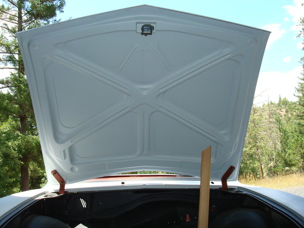

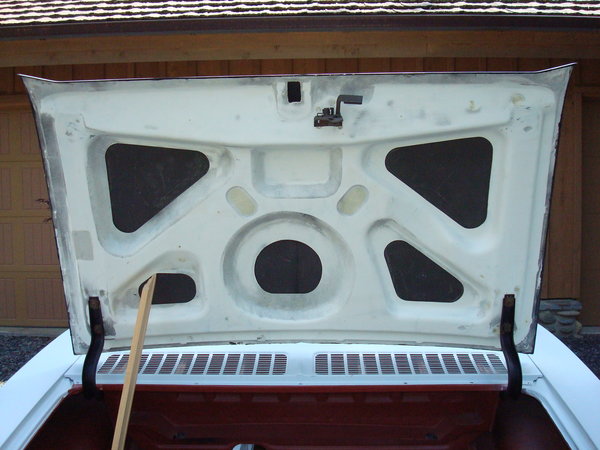

Under side of deck lid with a "stick" propping it open.

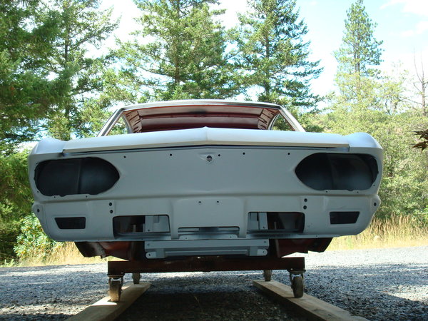

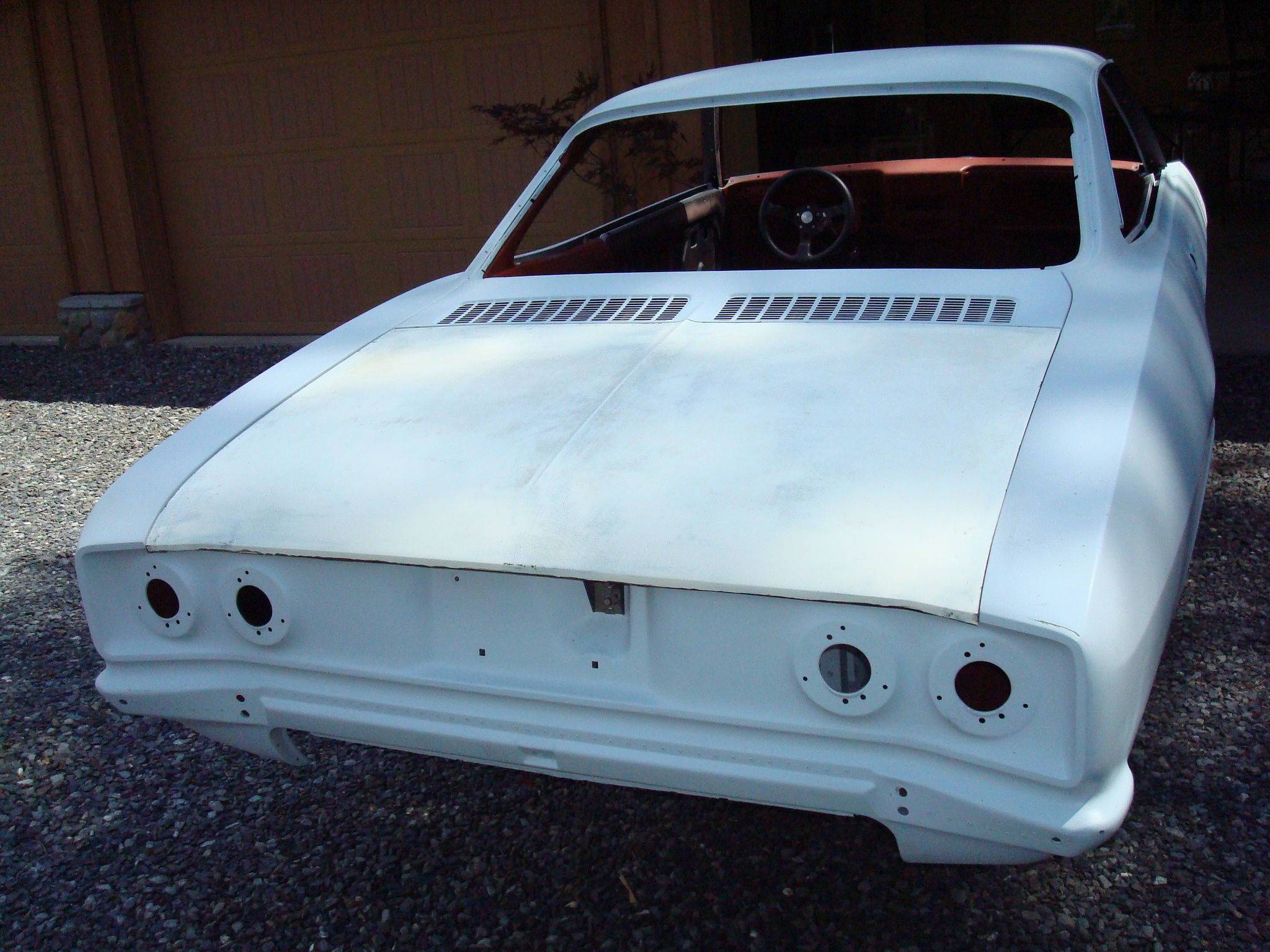

Completely stock looking from the outside.

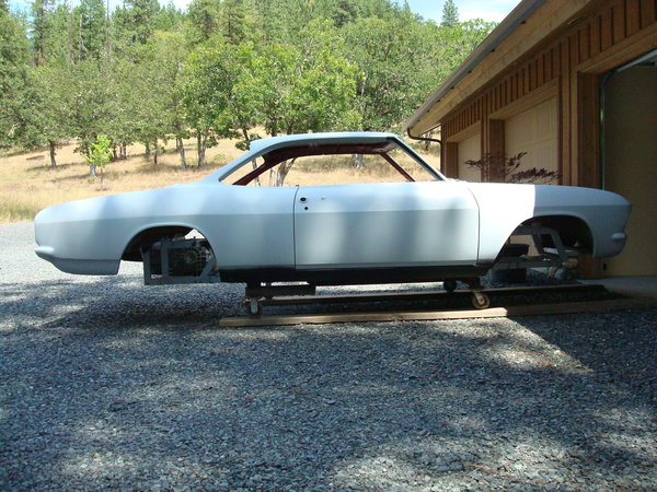

This profile shot provides a glimpse of the "backbone" chassis through the wheel wells. I'll post some more detailed pics of the chassis very shortly.
carbon fiber hood
This view clearly shows the air inlets cut into the lower valence. The plan is to integrate inlet ducts into a splitter to clean up the appearance.
Before I joined the "spider" and outer hood skin I made all the smaller holes in the spider into larger openings that follow the contours of the spider's hat sections to create a cleaner look and reduce weight even more. Perhaps foolishly, I smoothed over the carbon fiber on the backside of the outer skin to make it look more like the original hood but in hindsight I'm thinking I should've left it in raw carbon fiber like it is on the deck lid...oops.

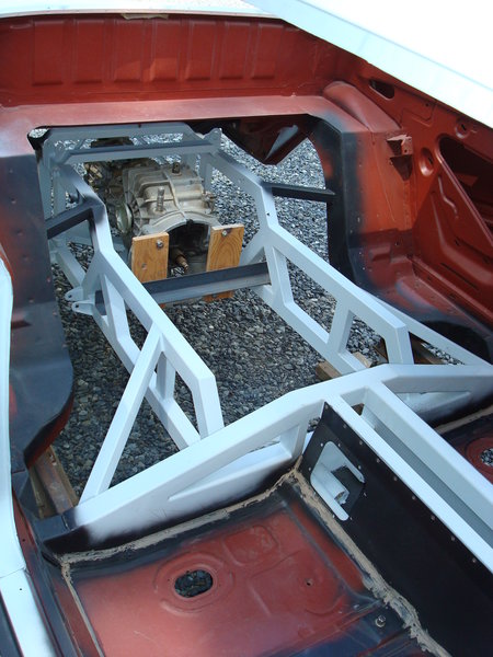

This next series of photos shows the "backbone" chassis integrated into the unibody. Some additional links from the chassis to the body remain to be done but I'm holding off due to a lack of commitment on my part to the engine selection, commensurate exhaust routing and some issues surrounding the fuel tank and radiator placement up front.

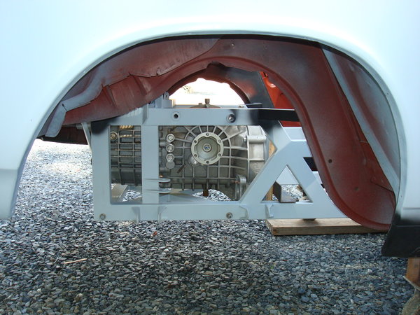

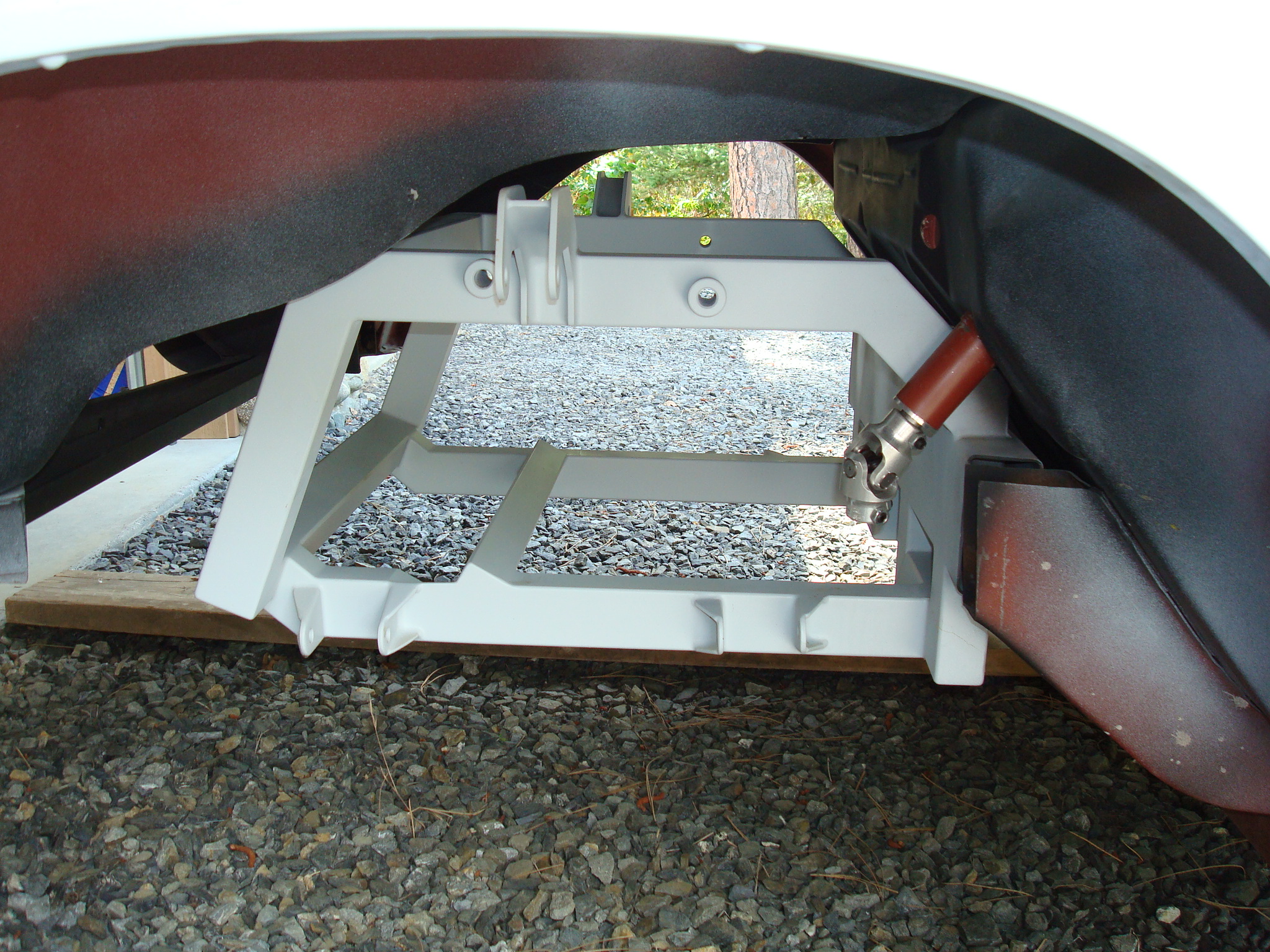

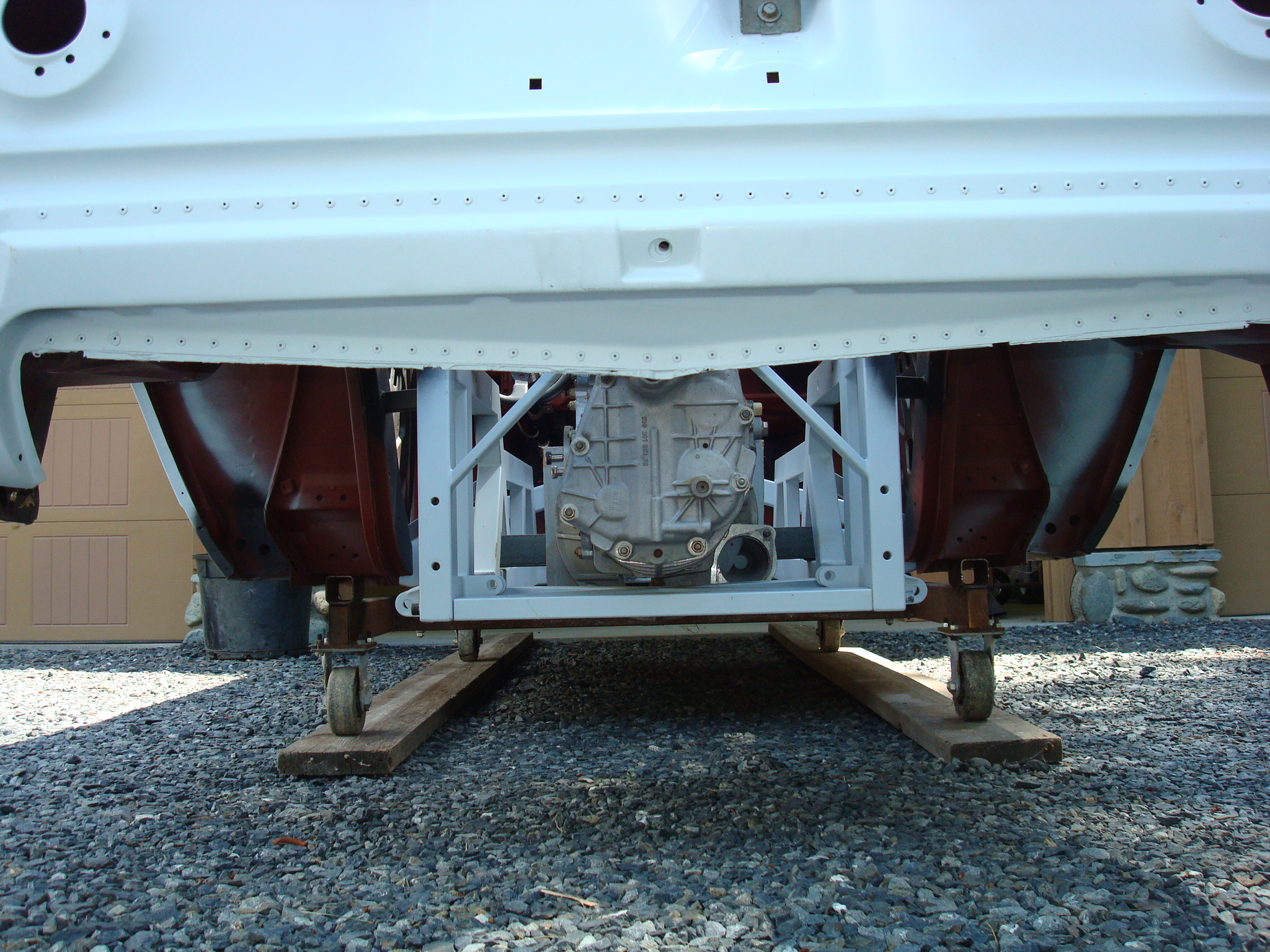

Rear suspension box with 930 transaxle flipped upside down. If the trans isn't flipped, the only other way the make the wheels turn the correct direction is to have the ring gear moved to the opposite side of the transaxle. Turning it upside down offers the added benefit of more ground clearance and is a "free" solution.
Snake's eye view of rear.
930 tranny output flange.

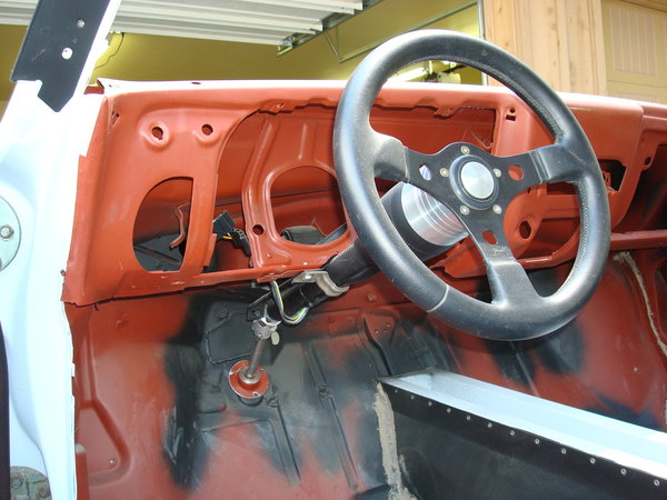

Relocated steering penetration through the firewall (trunk wall?).

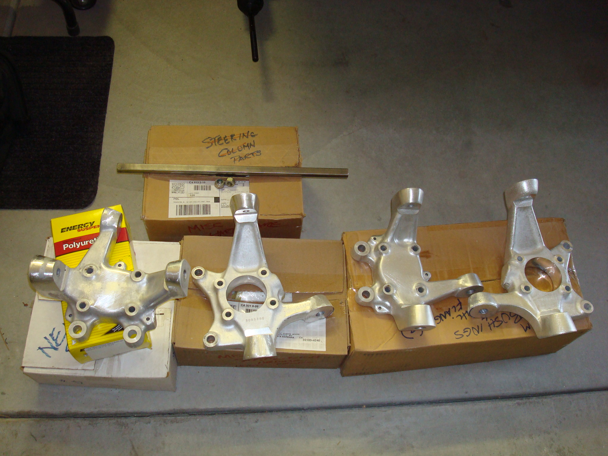

Front knuckles, without holes and rear knuckles with ABS sensor holes, now allow pass-through of the halfshafts.

If I understand correctly, the Kelmark conversions flipped the stock Saginaw transaxle. One issue was lubrication, since it was designed to use gravity to return oil. My recollection was that a separate oil pump was necessary to fix this. Is that going to be true of the this transaxle as well?

Norm, to answer your question about trans lube, I've done a considerable amount of research on that with respect to the 930 trans. By all accounts, those being mostly mid-engined kit car conversions, the "flipping" procedure is acceptable with no discernible harm to the transaxle. It really depends on who you ask. I queried "Renegade Hybrids" (914/SBC guys) some time ago and they "suggested" that the ring gear option was preferable but then they perform the machine work so there's a bit of a conflict of interest. They're applications also benefit from leaving the 930 box in its right-side up orientation due to motor mount issues, shift linkage, and half shaft inclination. If anybody out there has anything to add I'd be grateful to hear from you. Thanks for your interest.
