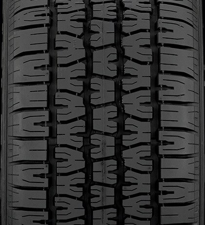

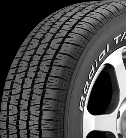

Re: SELECTING CUSTOM WHEELS AND TIRES FOR YOUR CORVAIR
The BF Goodrich Size P225/60R14 has the same Overall Diameter and Revs per Mile as the 185/80R13 tire, but a tread width of 7.6", compared to the narrow tread of 4.7" on the 13" Maxxis tire! The low profile 13" BF Goodrich tire has a smaller diameter than the Maxxis tire, but a wider treadwith for more traction and improved braking.
Sizing Corvair Wheels and Tires
:link: http://autoxer.skiblack.com/tires.html
For a few dollars more I believe the BF Goodrich Radial T/A offers the Corvair much better handling and braking performance on the street. The Maxxis tire offers an original look with similar performance to the 1960s vintage tire.
RADIAL T/A - SIZE: P205/60R13
Performance All-Season
:link: https://www.tirerack.com/tires/tires.js ... &tab=Sizes
Per Tire:
$123.54
Availability: In Stock
...I surfed over to The B.F. Goodrich site to come up with some examples of tires that would work well on Corvairs. They have data sheets for all of their tires there, I used the specs from the Radial T/A here, other models will be a bit different. You should be aware that the sizes are a range, so it's a good idea to get the data sheet if you can, especially if you have chosen a size near the limit of what will fit. Unfortunately, BFG doesn't offer a 13" Radial T/A that will work well, these are 14, 15 and 16 inch:
P185/70R14 (all)
P195/70R14 (all, good replacement for 1960 - 65 6.50-13)
P205/70R14 (all, good replacement for 1966 - 69 7.00-13)
P205/55R15 (all)
P195/60R15 (all, good replacement for 1960 - 65 6.50-13)
P195/65R15 (all, good replacement for 1966 - 69 7.00-13)
P205/60R15 (all, good replacement for 1966 - 69 7.00-13)
P205/55R16 (a little tall, may rub on an early, fits lates)
Late models have a little more room in the rear, you could use these sizes on the rear of a late if you want the "big and little" look:
P225/60R14
P235/60R14
P215/60R15
P225/50R16
Sizes Currently Available...
13
  • P205/60R13
14
  • P205/70R14
  • P215/60R14
  • P215/70R14
  • P225/60R14
  • P225/70R14
  • P235/60R14
  • P245/60R14
15
  • P155/80R15
  • P195/60R15
  • P205/60R15
  • P215/60R15
  • P215/65R15
  • P215/70R15
  • P225/60R15
  • P225/70R15
  • P235/60R15
  • P235/70R15
  • P245/60R15
  • P255/60R15
  • P255/70R15
  • P275/60R15
  • P295/50R15
TIRE SPECS - SIZE 185/80R13
SECT WIDTH: 7.2" TREAD WIDTH: 4.7" OVERALL DIAM: 24.7" REVS PER MILE: 842
LEFT-CLICK IMAGE TO ENLARGE, AND CLICK A 2ND TIME FOR MAXIMUM ENLARGEMENT
BF Goodrich Radial TA Tire Specifications
