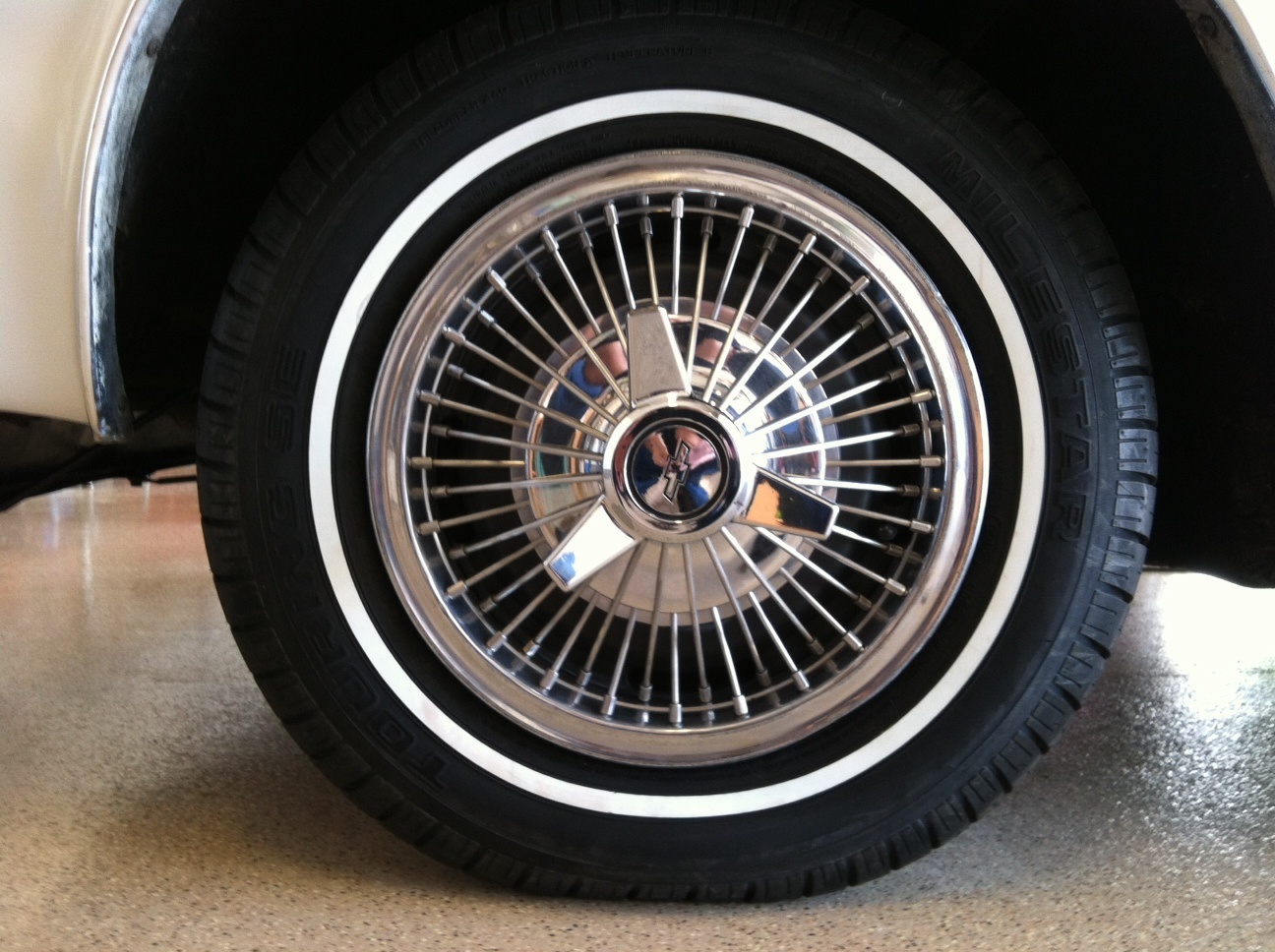

65 Hubcap before refurb.
65 Hubcap before refurb 1 - Notice the missing paint & bent wires. What you don't see is the tree sap, spider webs and dog "stuff" on it.
65 Hubcap after refurb
Hope these pics show up. First time to upload anything.
A couple of pics of the 65 spinner wire wheel before refurbishing and 1 after. Quite a difference.
What you don't smell is the tree sap & dog "stuff" on it. Nor see all the spider webs inside and on the back.
Thanks
